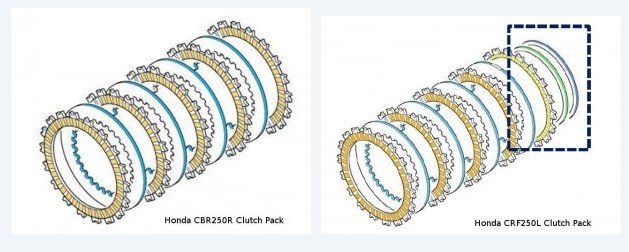

Interesting that the only difference between the Honda CBR250R and the Honda CRF250L clutch is the two additional spring 'plates', the two extra springs should not cause any problems?

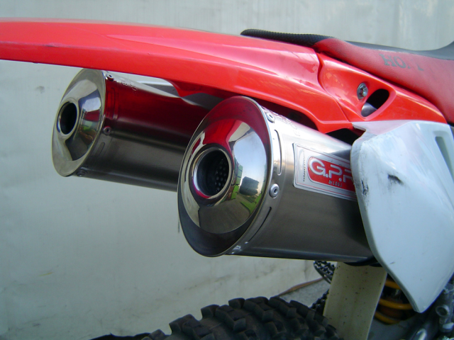

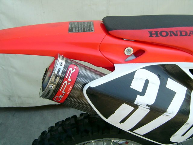

As the importer for EJK and GPR exhausts. :idea:I could put together a kit if anyone is interested. A drilled air box cover would be included. GPR are at EICMA at the moment so I have to wait for confirmation on the muffler type. competition system might be a bit loud, but that is just the endcap.
If anyone wants some real bling. This is for a CRF250 Moto
but whether there is room on a road going CRF?
So it will probably be more like this
OK all subject to confirmation as I picked the wrong week as they are at the exhibition. But based on previous shipment of SS pipe, so could be a little less as they won't be so heavy. They have three type of cans, Aluminium/Aluminum. titanium and carbon finish with metal end cap a called a Poppy. There is no "conventional" stainless option currently for CRF.
Full system (currently only in Titanium) and deep tone compact muffler about 22,000-25,000 depending on quantity.
Can aluminium oval about 15,000
Can oval SS with carbon pattern etched onto it and SS ends called a Poppy 17,000
Titanium oval 17,500
All include full mounting hardware of course
Above are CRF250
KTM 990? 2 into 1 Titanium about 37,000
KTM 990? aluminium cans about 23,000
For your DRZ I'd have to ask.:)

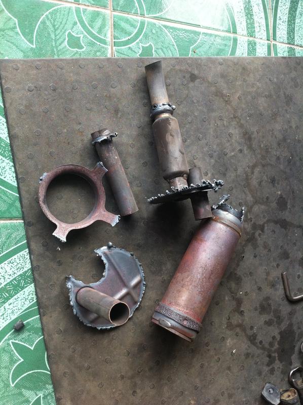

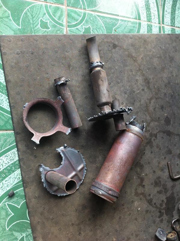

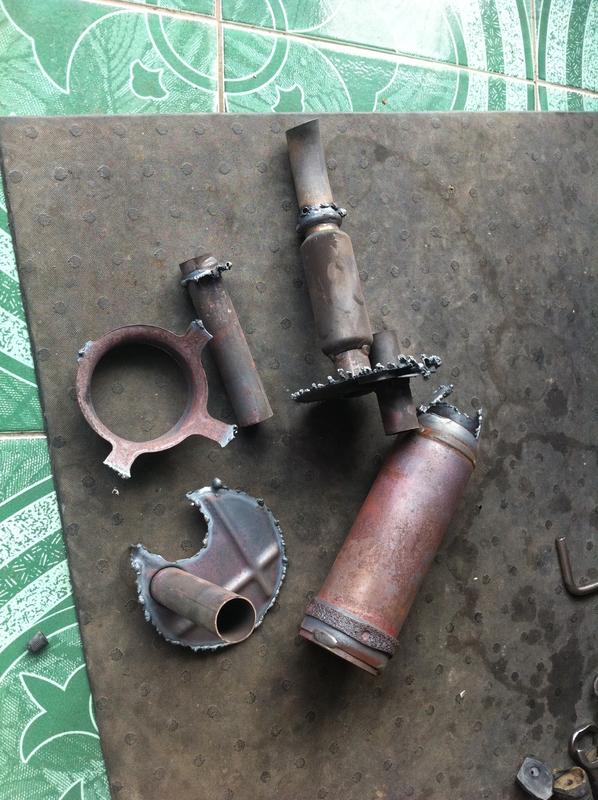

Well started to remove some of the stock crap off the CRF, the taillight assembly alone must weigh over 4kg, wanted to keep the stock pipe if i could as the aftermarket ones are too noisy for my liking, plus you usually lose the heat shields. So i had my local guy remove all the innards from the stock pipe in much the same way as my KLX and at the same time make a bigger bum hole pipe. The pipe sounds great now, also saved about 6kg in the process :banana:
How about bike performance after getting all those sh*t out? Think of some back pressure needed to improve bike power.
So, is there anything left inside at all, or is it just a huge empty can now? Any photos of the inside before your closed it back up? I am assuming that it must be quite loud now?
Can't say iv'e notice a lot of difference in performance, but it sounds a lot sweeter than it did before but not as loud as the aftermarket pipes.
Here is a video of some guy doing the same, i guess mine sounds like the middle sound byte...
