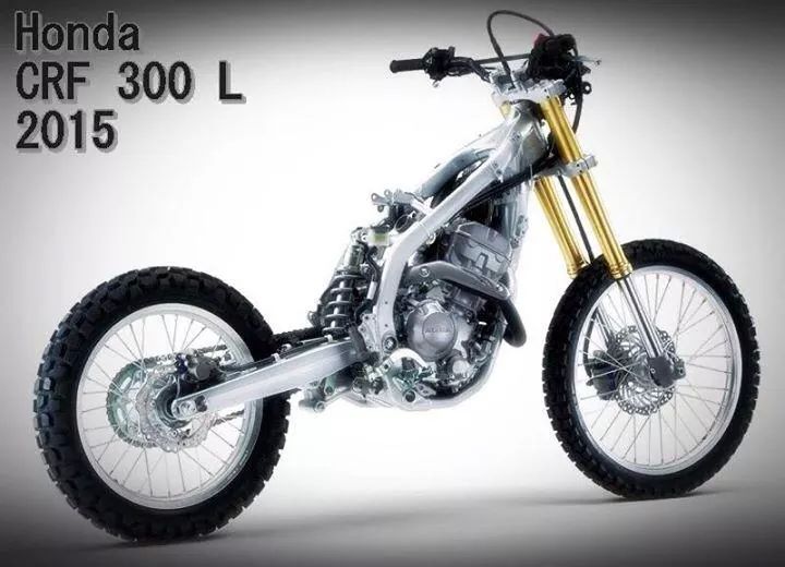

It took much less then expected, I see on CRF Thailand page the 300L 2015 on it !sounds like fun..and u owe me a beer! Hehe :banana:

This pic was on CRF Thailand facebook page.not sure what the thai description say
(?) :hmm
But that could be possible..
Please post a link - I believe it when I see it! :)
Anything is possible...
I've seen that pic more than a year ago.
Put the Thai description into Google translator - that should be good for a laugh! :)
I m on the phone (travelling Italy)couldnt copy/translate,but
Sure this will happen!such a small change will lead to huge biz, and definetly take over klx's sales..
Keep my beer in the fridge for now ;)
Rumors!

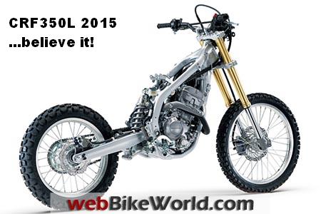

Let's have some fun then:
