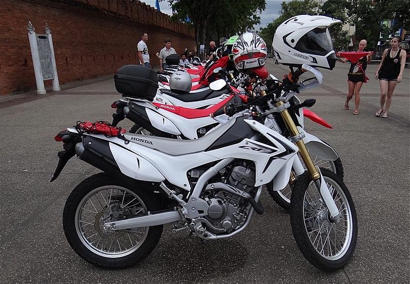

A very friendly and helpful gathering of enthusiastic Thai and 'Faring' CRF owners gathered at Thapae Gate last night and had these bikes on show.
Just sharing ideas and contacts was what it was all about.

About 20 CRFs turned up.
One guy invited us on a Sunday ride to Samoeng.
As I said, friendly and enthusiastic CRF owners.
I'll make it a regular visit; thanks for the 'heads up' jb.

Nice looking bikes 2W, all so clean as well..
Chain guard seems a bit OT though :|
8808d1345350714t-crf-chiang-mai-honda-crf-club-meeting-cnx-saturday-evenings-dsc03465.jpg
Hahaha, yes, the bikes look very clean here in the picture but they are being sold as "offroad bikes" by Honda or probably better "dual purpose" bikes both for off and on-road riding and the bikes is well at home in the dirt and mud.
MR Trung, my dirty dual-purpose CRF is in the line up but hidden from view!
