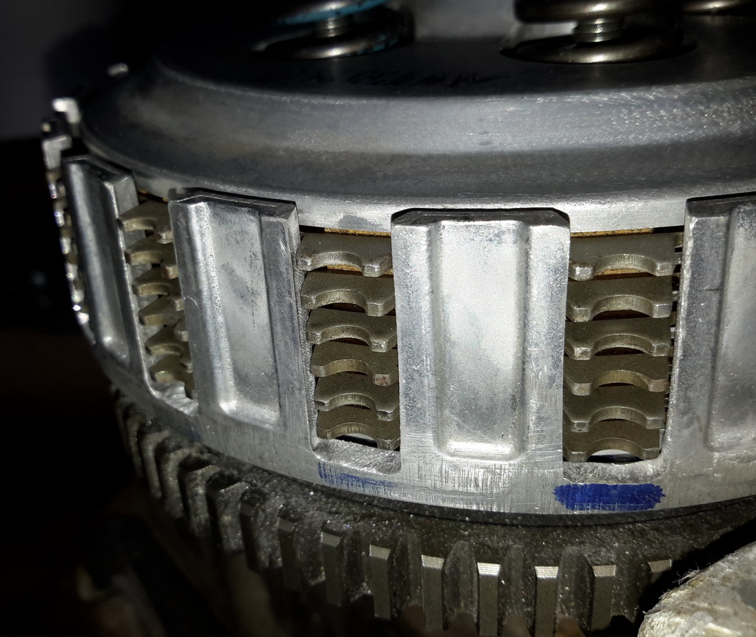

But depend of the lack of Machine shops and equipment i had to build first a small special Lathe/Grinder and some Adapters to hold all the Clutch Parts in Place befor i could start digging step by step for more Room .
The Clutch Basket , The inner and outer Pressure Plate and the then 5 Steel plates need to be modified.
And precisely or the Clutch will not work and that , on my selfmade Hack , measure everything twice with digital Calipers and Gauges was not easy .
0.05 mm can in some places already out of tolerance . Some Parts need to be Blueprinted to .

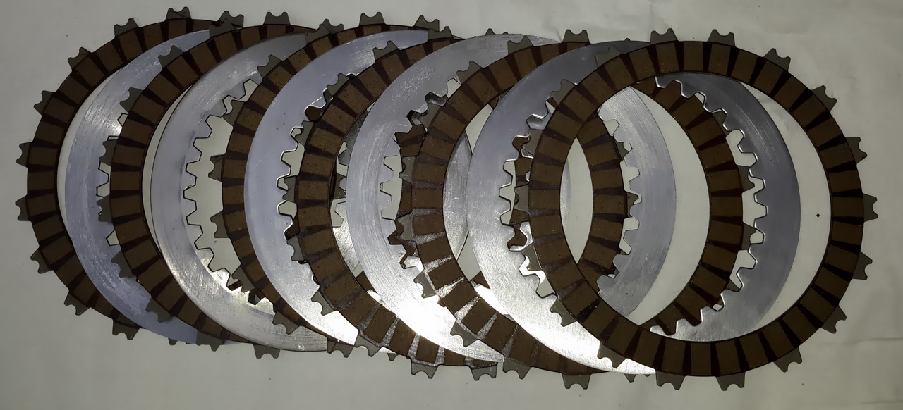

So here is the first 6 Friction Discs CRF250 L Clutch

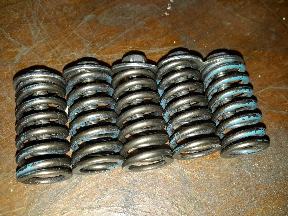

On the Outside , same dimensions as the Original CRF Clutch , build from stock Parts with 6 Stock CRF Friction and 5 Steel Disks .
and CBR 300 Clutch Springs.
A lot of manual work with small diamant file and sandpaper add time to the process . alone deburring all the sharp edges from the grinding correctly took one day .
I am fully aware that this mod weakens the Clutch Parts , but , the Clutch work so far now for one week flawless .
Easy 2 Finger Lever pull , perfect engagement and i try now for one week to get it to slip .
So far without sucsess.
And my 350 cc Engine really has the Power to stress the Clutch.
