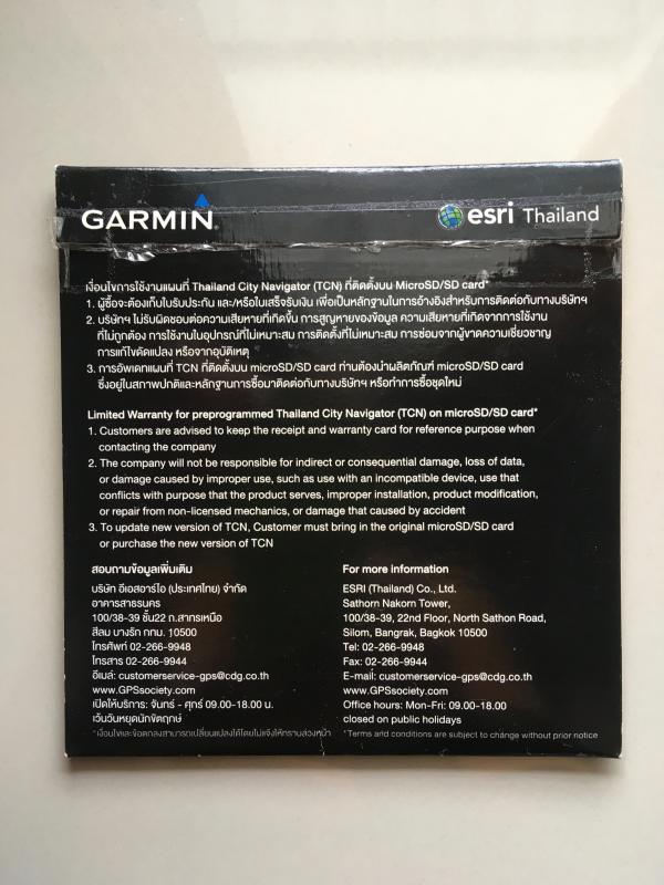

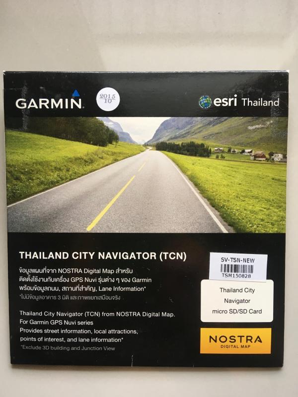

I currently have the Thailand City Navigator on my zūmo 660. On the Map Info tab of the zūmo 660 it describes the map as "CN Thailand NT 2015.10 (Eng)" and it has been subsequently updated to CN Thailand NT 2016.20 and then CN Thailand NT 2016.40. The only way that I could update the map was to actually go to GPS4YOU and have them do it. I could not do it online. Do any of you have a similar experience?
I cannot seem to register the Thailand City Navigator map on my.garmin.com as all of my other Garmin products are. I have no idea why. Has anyone been able to register this particular map?
Also, when I launch Garmin Express with my Zumo 660 plugged into my iMac, Garmin Express recognizes the Zumo 660 but states that there is an update for Full Coverage of Europe. It doesn't recognize the Thailand map. What do I do so that Garmin Express recognizes this map?
When I launch Garmin BaseCamp it does recognize the Thailand City Navigator.
I did some research online and I cannot find the aforementioned Thai map on any Garmin website. I have found City Navigator Southeast Asia NT (https://buy.garmin.com/en-US/US/p/89538#coverage) . Does it have the same level of detail for Thailand as the Thailand City Navigator that I bought at GPS4YOU?
Here is are images of the packaging for the Thailand map that I have:

I guess that what GPS4YOU has sold to you is a copy of the original map considering that you have to go to GPS4YOU to update the map. As a result you will not be able to register the map on My.Garmin.com as the latter will check if you have an original map as supplied directly by NOSTRA/Garmin Thailand to you. Also, as it is not an original map. Garmin Express will not recognize it as a legal map.

The CN Thailand map is sold by Garmin Thailand while the CN City Navigator S.E.Asia map is a map sold by Garmin itself and, people who have both versions (CN Thailand and CH SE Asia), indicate that the CN THailand is considerable better with regard to automatic routing, etc.

With regard to the CN Thailand NT 2015.10 (Eng) that I purchased for my zūmo 660, I just don't understand why an authorized dealer is selling a map that appears to be a Garmin product but is not recognized by Garmin Express nor my.garmin.com.
