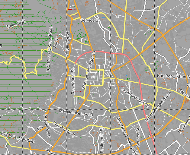

Hi all. I just updated to the latest version (2019-03-13) and when I zoom in to a city (in the attached files it is Chiang Mai) the background goes grey. The second image is the same general area from the 2019-02-27 version of the map. Maybe I am getting old but I don't remember that happening in prior versions. Is it an intentional change or something else? I find it much harder to read than the prior version plus many of the smaller roads don't appear.
I'm using the new 64bit version of Basecamp on an iMac.
Any information appreciated.
David
75254
75285
Actually i get the same on my Mac's when you zoom in to distances less than 5km, will message Nightrider to see if there is a bug.
