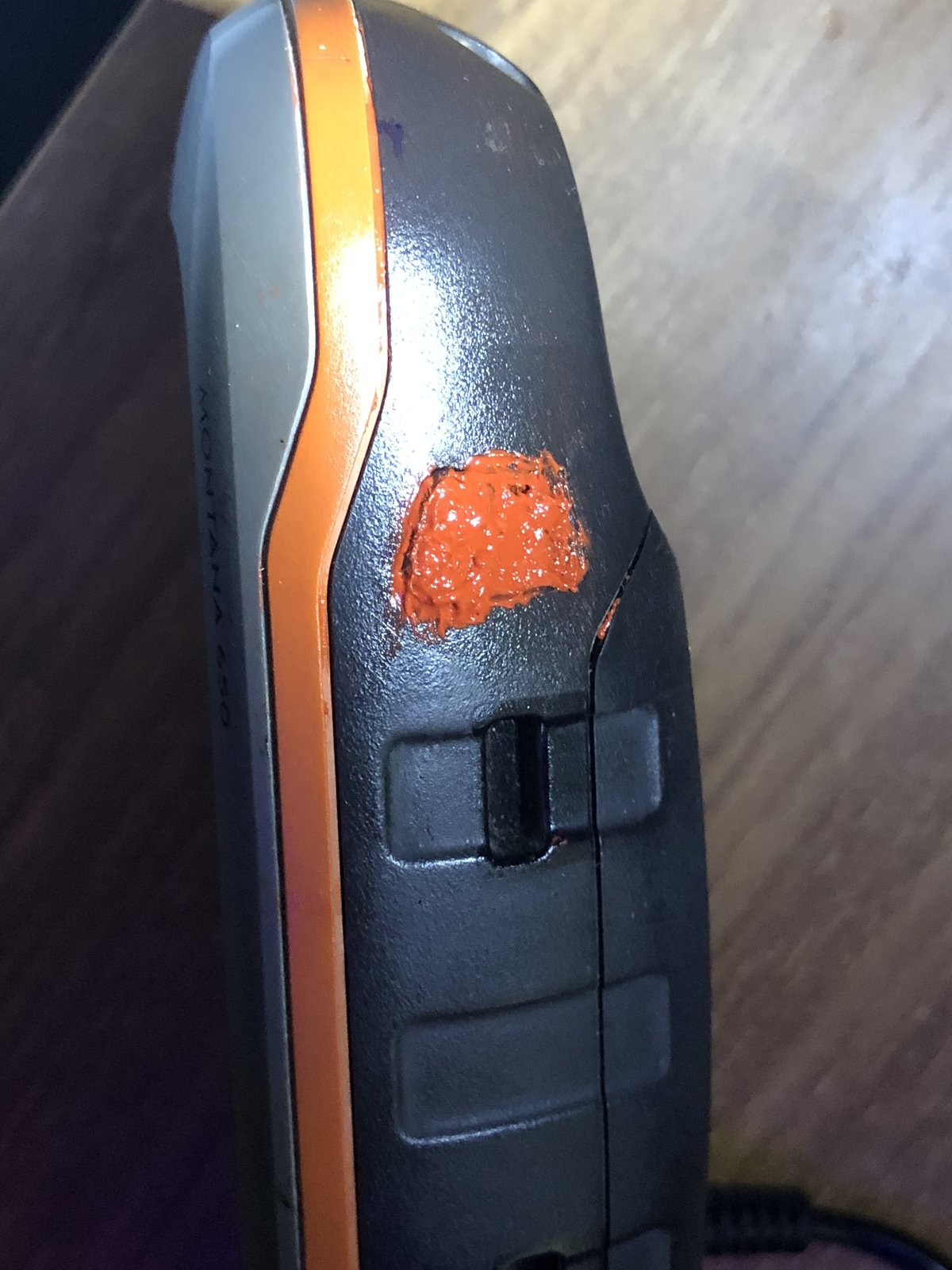

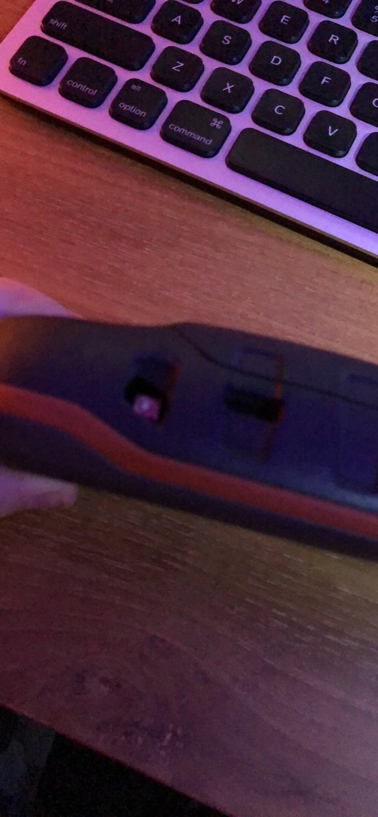

Anyone else have this problem with the buttons wearing out? I have emailed Garmin about this. Will let you know what they say. I have fixed mine with rolled up electrical tape.

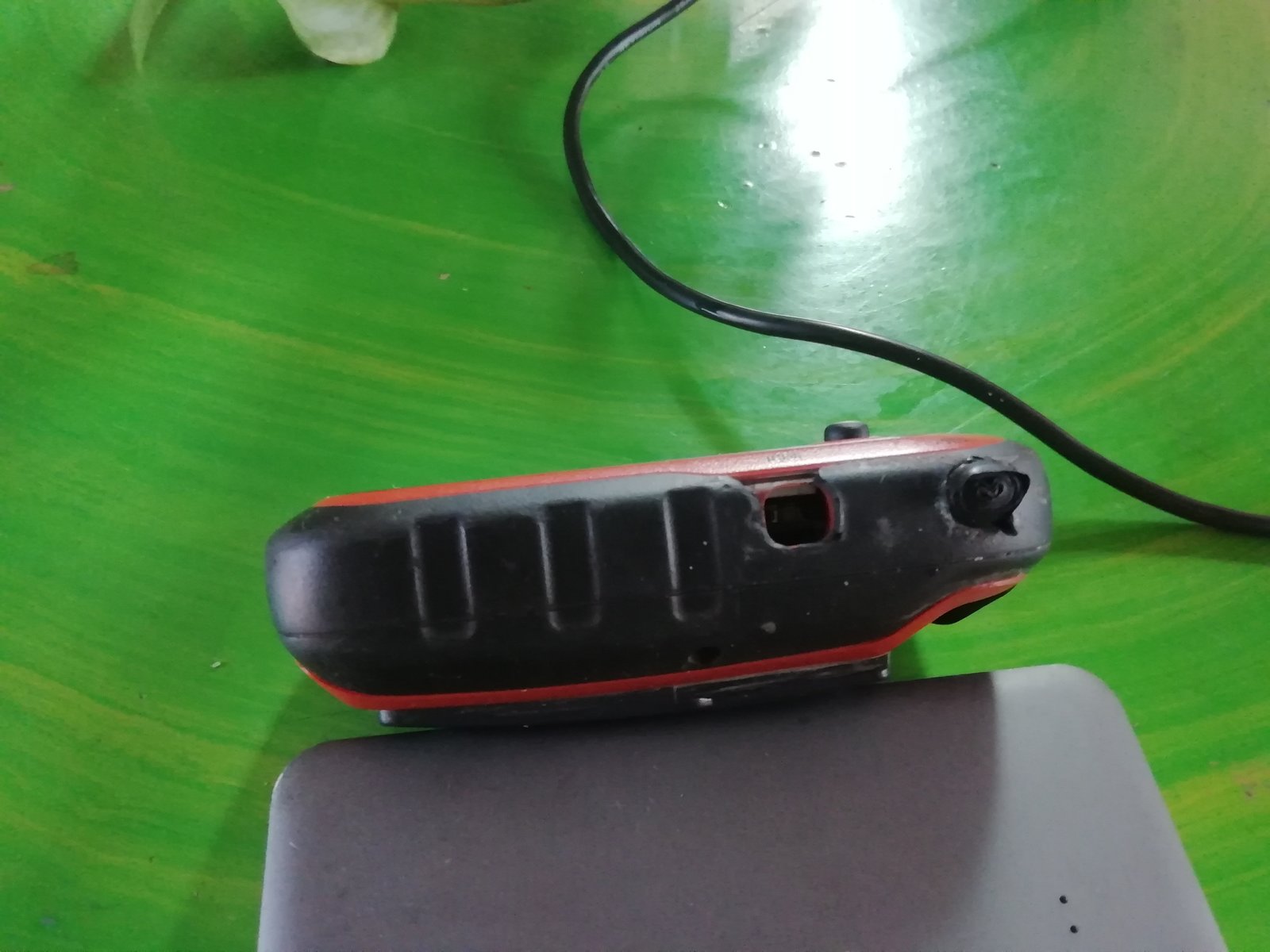

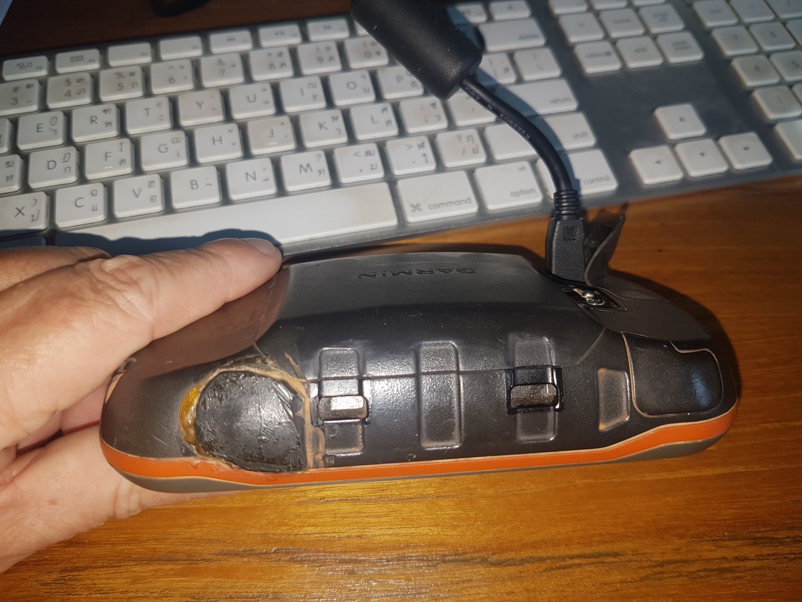

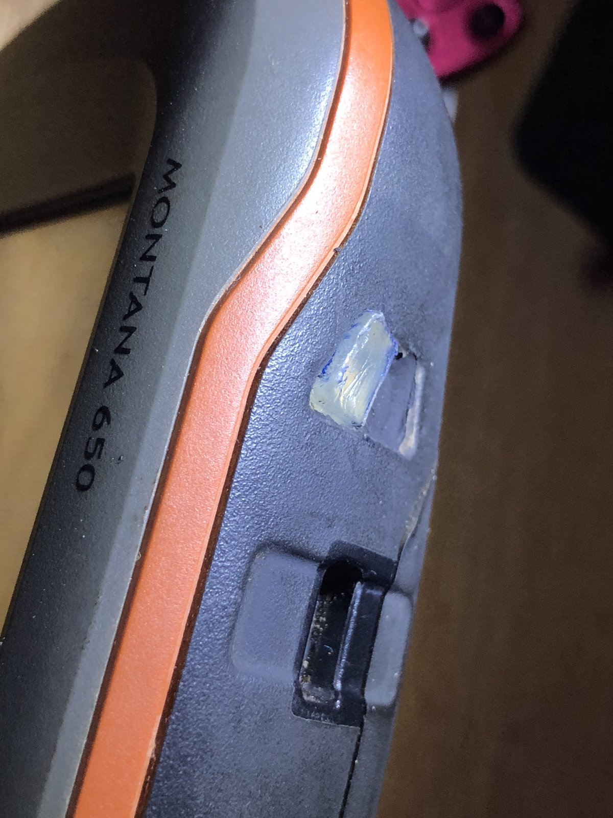

Same issue this week with my 650T Montana
Was on a trip with 5 other guys the other week out of the five four of us had exactly the same problem, there used to be a Russian company on Ebay that sold the back bodies, but i just cut some inner tube and made an epoxy patch just need to make sure you have a small piece of rubber or such over the switch button so when you press it finds the switch. Been this way for almost three years now and no issues.

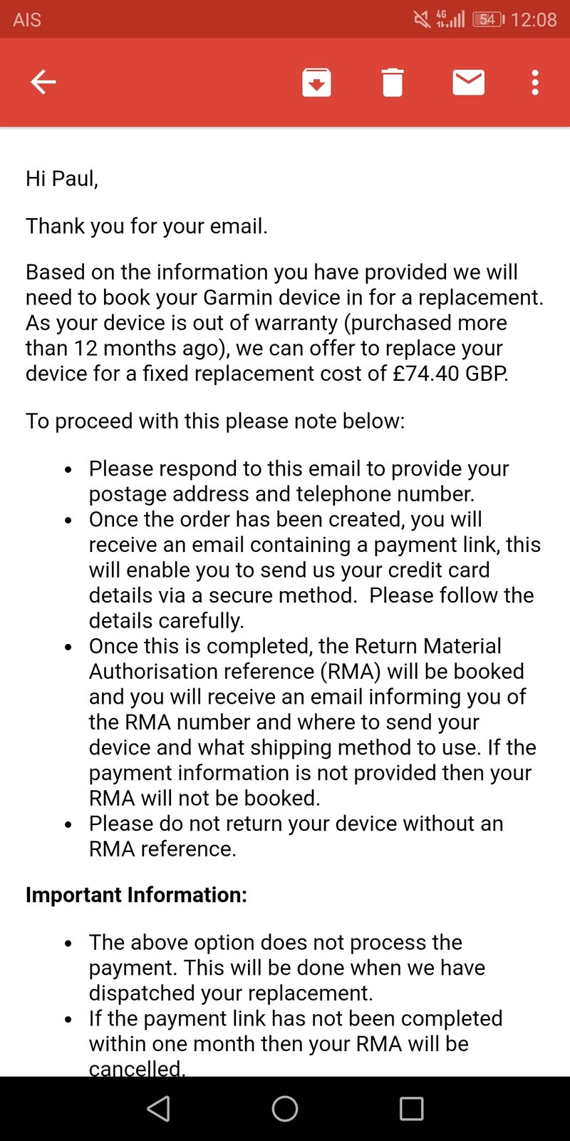

Got an email from Garmin. The unit is out or warranty so they have offered to replace it for a fixed cost of £74.40. Which is cheaper than buying a new one.
