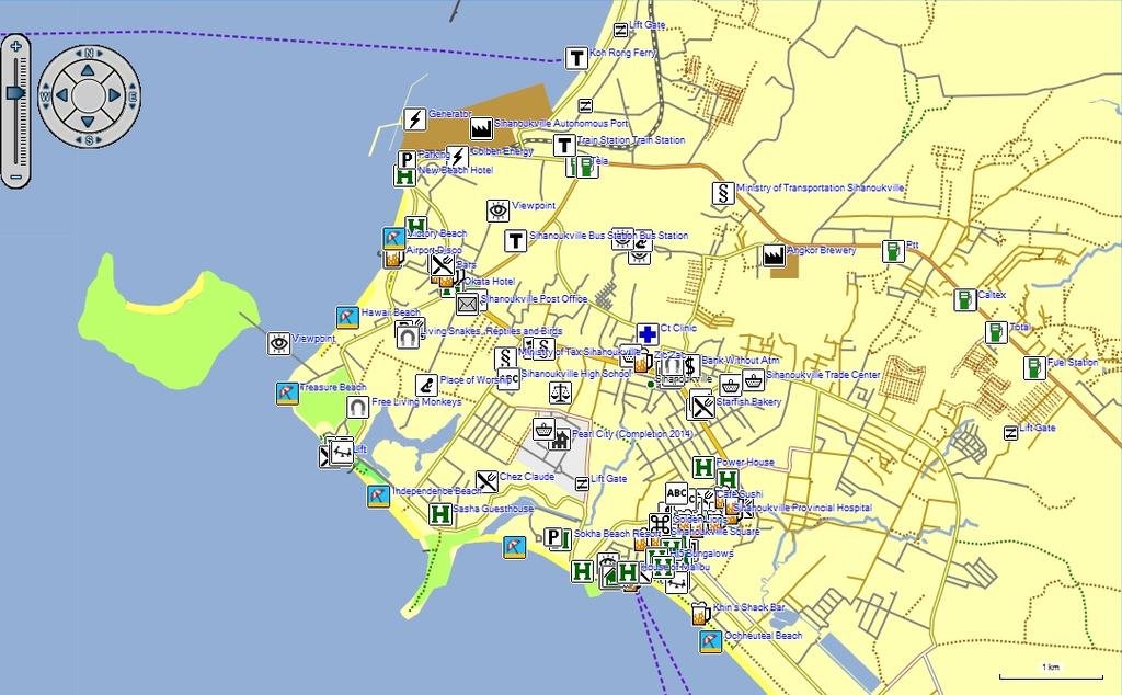

Coverage:
Get map

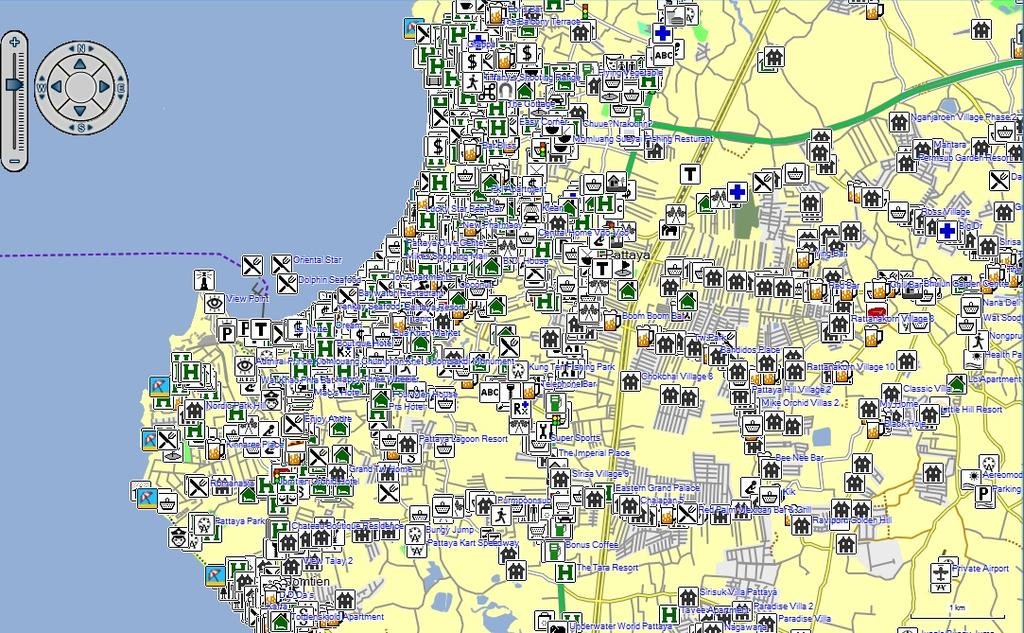

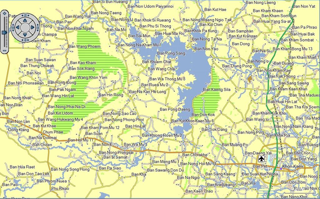

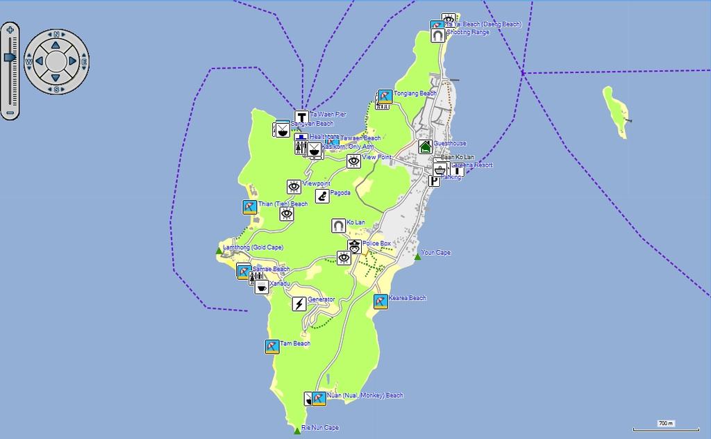

BaseCamp Screens:
Get map
