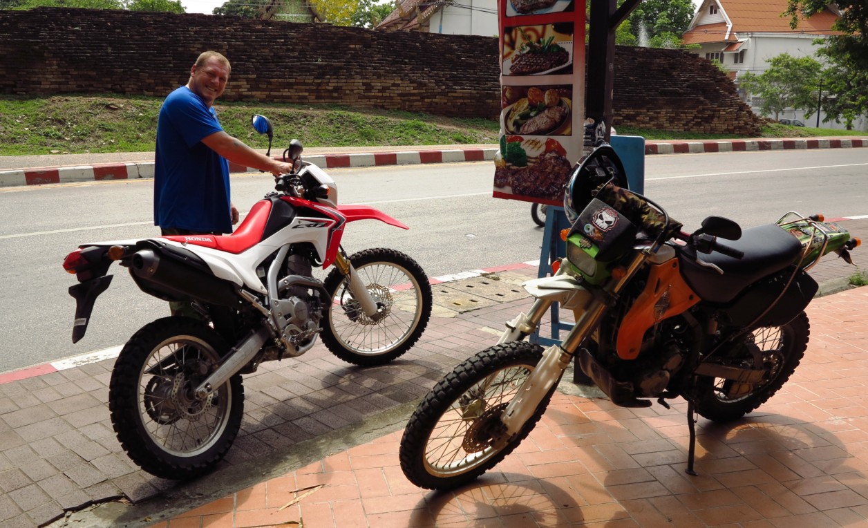

We'd been meaning to do this sooner, but 3 days of constant rained had hampered our schedule.
Managed to drag AlexUK out who's been riding KLX 250's for a number of years. His KLX 250 has some modifications, airbox, carb, ecu and exhaust, so we wern't comparing the bike this time to a stock KLX 250.
Before hitting the trails, we did a stationary push/ compression test on the suspension comparing the bikes.
The front suspension was noticeably harder on the Honda CRF 250 L than on the Kawasaki KLX 250.
The rebound on the rear shock absorber was faster on Honda CRF 250 L than that on the Kawasaki KLX 250 .
Off into the trails behind the 700 year stadium in Chiang Mai, a bit soggy everywhere but surprisingly puddle free considering all the constant rain.
One thing you immediately notice about the Honda CRF 250 L is how low it is compared to most enduro style bikes, it makes the bike very easy to handle through the tree roots and soft mud on gradients, where we were riding, it was not hindered in any way being slight lower.
We did a loop of the lower enduro trail area for Alex to get the feel of the KLX, then he took the Honda CRF 250 L for a test to compare.
Alex agreed that the lower seat and the bike generally being lower felt good and gave you confidence through the wet, slippy tree roots and soft mud, quite interesting that this had worked for the Honda.
Even with the standard rear sprocket (think its 42 tooth), there was plenty of power up the really steep stuff, engine torque seems fine for a 250cc bike. We had noted that the front suspension was harder than the KLX 250, but going fast through the tree roots, which is a great test for suspension, the Honda CRF 250 L held a great line, the suspension is great as standard, with mods. might be quite a bike.
We messed around in the enduro training area, the Honda CRF 250 L climbed fine up the steep inclines, the standard IRC dual sport tires on the Honda are excellent all round tires, more aggressive (off-road orientated) than the Dunlop 605 tires that come standard with the Kawasaki KLX 250
So to summarize, looks like it's a winner.

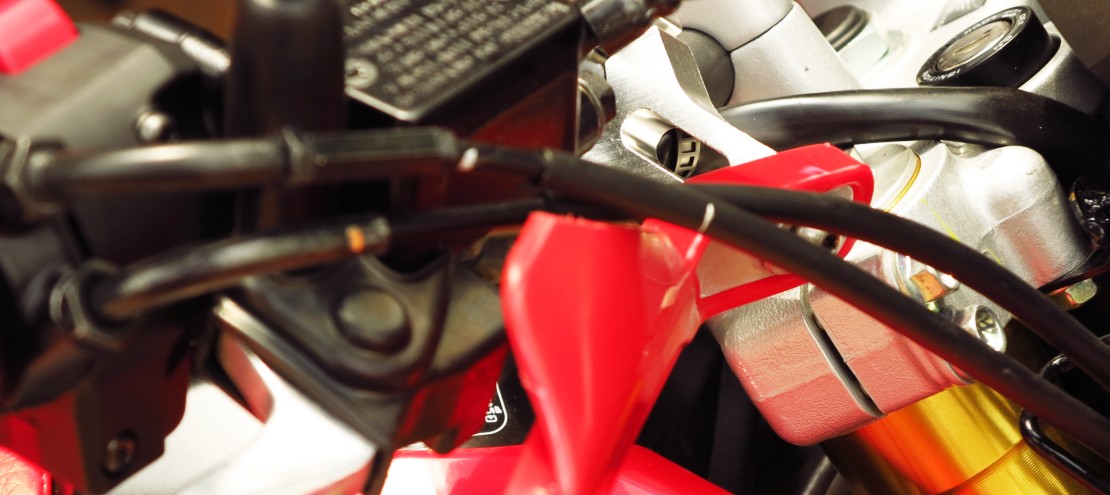

Can you confirm what suspension adjustments the CRF250L has
Rear shock Spring preload ?
Rear shock high speed compression nut ?
Rear shock low speed compression screw ?
Rear shock rebound clicker ?
Front fork compression clicker ?
Front fork rebound clicker ?
Taninthai
May 7, 2012
Crf 250
Sorry wrong calculation was thinking of diesel prices 200 bht of gasohol is just under 6 litres so when Ive been filling up there has still been 2 litre left in tank

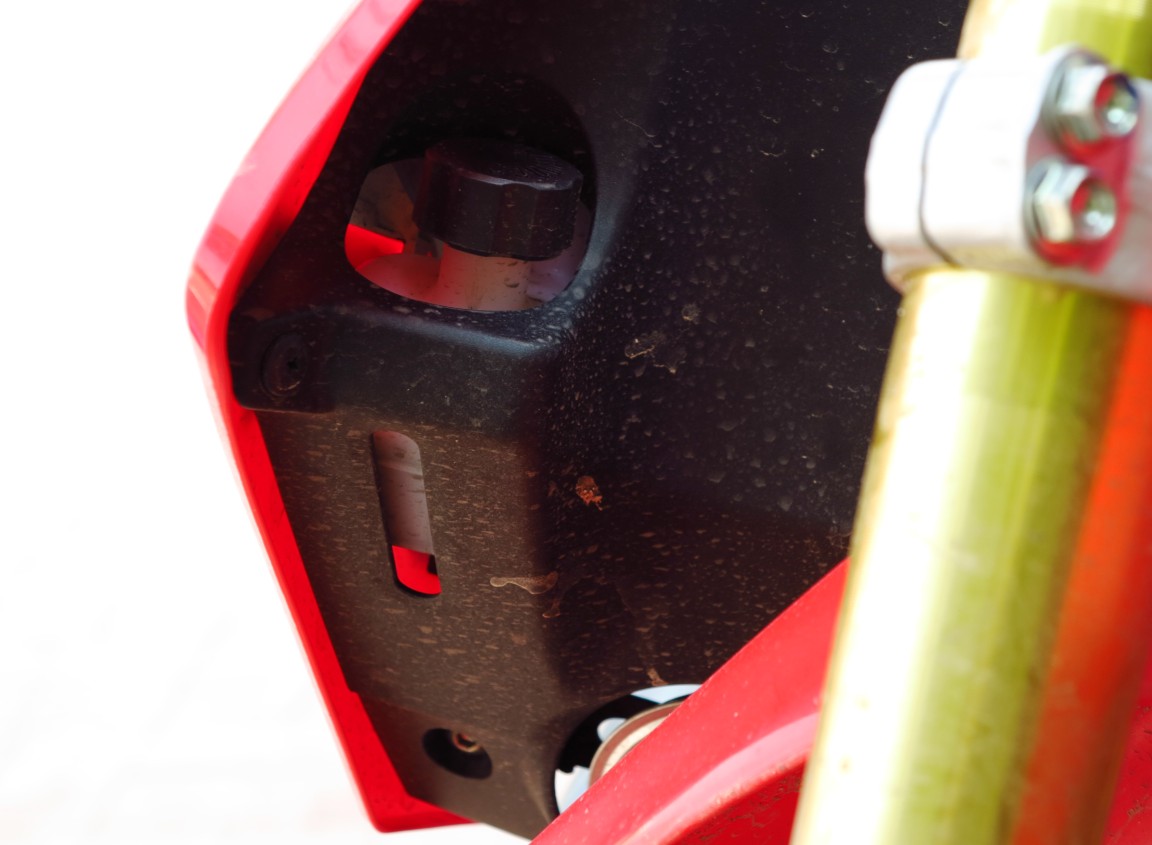

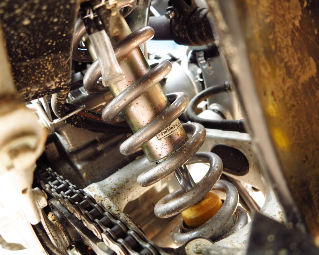

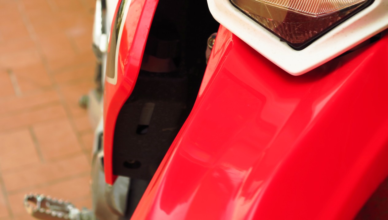

Bill -- as far as we can tell so far only the pre-load on the rear shock is adjustable

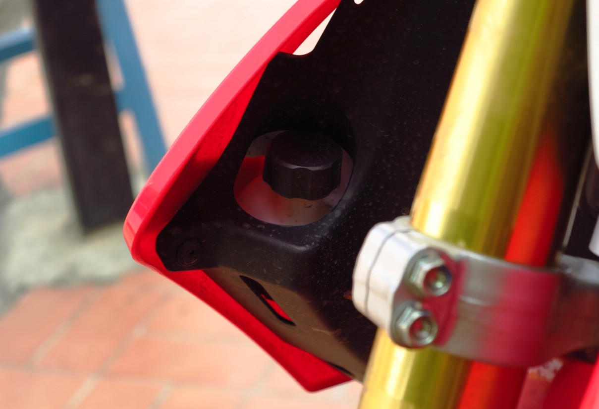

Just got a call from Con who's in Udonthani, he tells me the Udon Honda dealer has the Honda CRF 250 L on a special promotion offered for 130,000 Bht! Rumors around that the Chiang Mai price may soon be 145,000 Bht.
Got a flashlight out with Lan & he confirmed that there are no adjustments screws for dampening on the front or rear suspension on the Honda CRF 250 L.

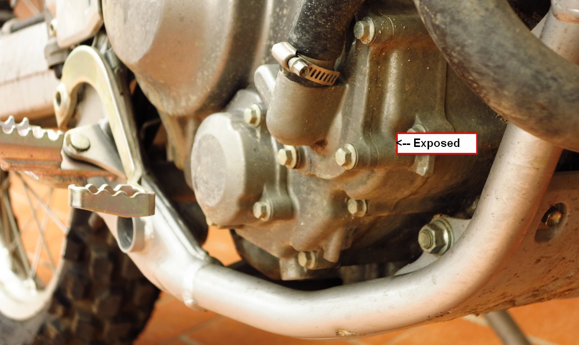

The engine water pump looks very exposed on the lower RHS if trail riding, might be worth getting a custom cover made.

Looks like the rear suspension travel and bottoming out fears are over.
