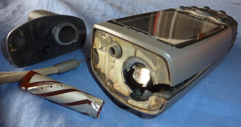

- - - Updated - - -
Hang on.. The broken one above.. Did you bin it ??

BTW, It was mentioned earlier the only option was to send the unit outside of the country for a fixed price repair ??
I contacted ESRI who told me they do a repair service and I could post it to them (without an RMA and seemed a bit uncontrolled) or drop it into eagle GPS and I would get a price quote for repair. I dont have it back yet but took it to eagle who were happy to help and seemed familiar with the process. We will see.

My gps to esri was most odd..
I call and ask if they can repair a 60csx.. They say yes just send it.. I didn't like posting without an rma to a company that seemed a bit disorganized so dropped it at eagle..
2 weeks go by.. I call esri.. Took many many phone calls to be told they can't fix a 60csx, no parts.. They can send to Taiwan maybe a couple of months and a big bill.. No just return the gps..
I go on eBay.. Have a super tough buying experience for the bit I need from some Russian who seems to part out gps's.. Buy the bit I need..
Then I go to eagle to pick up my unrepaired gps.. I open the battery back and it's fixed.. I ask them and they look a bit shy and say no it's the motherboard, we checked it and it doesn't turn on.. Hold on, when I brought it in, it worked fine on external power.. I am thinking have they swapped out bits or something nasty.. So I ask if they have a power cable, you can tell they do, but she really doesn't want to say so.. So then I point to the USB cable on the desk and we try that.. Powers on.. So we test with battery's, which they say they tried and it didn't power on.. And it's fine..
So esri, said they couldn't fix it.. Said they couldn't get the parts.. But have changed the broken part, and it's fixed..
Won't complain but most confusing..
