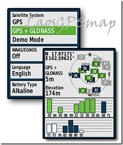

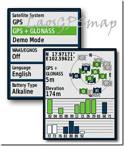

The most exciting thing in GPS receivers now is the newest generation of receivers.Found in the lates E Trex models!!
I had only a limited time to test these units before the Stock sold out!
Gotta admit it is pretty cool, to receive those sexy Russian signals along with the (yawn) Yank ones!
Can't wait till the new stock arrives, The downside for mapping, is no external antenna jack!
