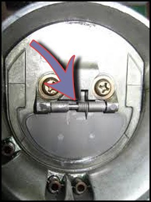

That’s why you see this hinged pressure release, on the choke plate.
