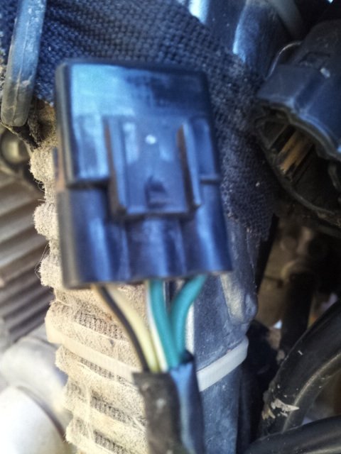

Someone know which wires to cut and or join to bypass the kill switch? plug.jpg
Is a 1998 XR250L
Without a diagram I would insert a multimeter behind the connector, into two of the wires. Set the multimeter to (lets say 200K)Ohms. Operate the kickstand until you see an open/close circuit displayed by a 1 or 0.00 on the multimeter. Trial and error until you find the correct two wire combination.
thats if its a simple NO/NC circuit operated by a switch on the kickstand somewhere (probably)
It was a magnetic switch on my Super Enduro. I just taped the magnet to the switch and then taped it all out of the way
As far as I remember connect the two green wires, but better check with a voltmeter. I didn't do it, I just tried connecting them until it worked.
