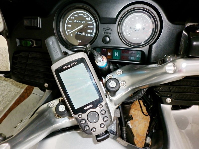

You can always buy a car cigarette lighter plug / USB adaptor and then fit a suitable socket. Amorn in Chiang Mai sell them for 120 odd Baht. That will make it a cheap fix. My bike uses BMW DIN type sockets that are a much smaller version of the car type power socket. I dont know whether they are available here, mine came from Nippy Normans in the UK along with a car/DIN adaptor. It makes it a cheap set up for my 60Csx. The mount is the cheap handlebar (12 quid from Amazon) mount. When not in use very little is left on the bike.
