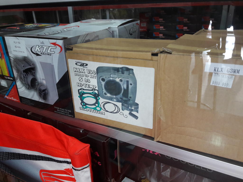

Hi guys, stumbled on this thread and was hoping someone could help?
I bought a new Klx 150bf in June and whilst it's a great bike there is no doubt it needs a bit more power to hit the trails. I recently got back from a trip to bali where I took an off-road tour on an updated klx150. What a different bike it was! Quite raw with good power throughout but slighlty eratic fueling at the top end ]sometimes] power would drop off when going flat out for extended periods. Apparently it was upgraded to 200cc and had a pro circuit exhaust. I spoke to the mechanic at the tour company who also advised he changed the clutch to a honda tiger 200 to allow it to take the extra power and modified the clutch cover to spray more oil on the clutch.
I was just wondering if anyone has or wouldn't mind compiling a list of their upgrades complete with part numbers/ where they got it from so I could potentially replicate it? It seems there is a multitude of options and am quite confused which way to head with it.
I am living in Kuala Lumpur Malaysia and am really struggling to get aftermarket parts here as no one seems to deal with the KLX. It seems like most of the work/knowledge on the upgrading of the 150 is based around Chang mai. I would be prepared to fly up there for the weekend assuming I could get all the parts necessary for the upgrade. Could anyone give a ball park figure for the parts cost? Naturally I would have to install the parts myself.
Also has anyone experienced any reliability issues after the upgrade? I use the bike to get about on during the day so whilst I don't mind additional fuel/servicing costs I would hate to turn it into a temperamental beast. O would like to do it right first time and get on with enjoying the bike.
I am going to attempt to attach a picture of the barrel the tour company used.
Thanks in advance.

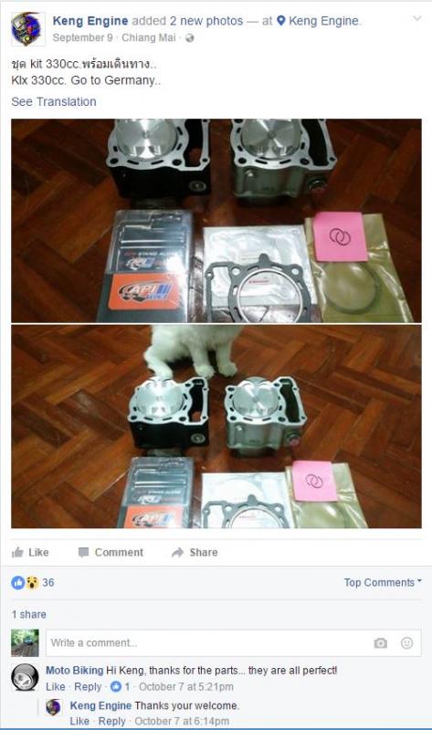

Lone Rider
Blokes Who Can
Jan 29, 2011
Chiangmai
4 Wheels
struggling to get any answers from the guys in Thailand that was suggested.
In Thailand it almost always seems to be difficult to get answers on emails sent to people and companies so you better try to call Keng at +66 85 033 3364 He is closed from 11-14 October but open again at 15 October. He is still very active and on his FB page I saw that he also exports complete sets.
Thanks, I will try again. Can you link to the fb post about exporting sets please? Can't seem to find it on his FB page.
