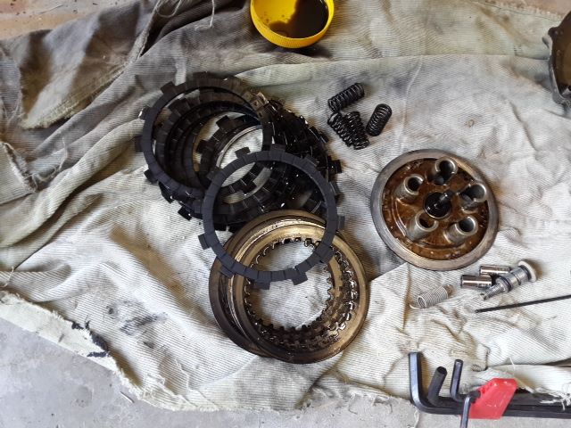

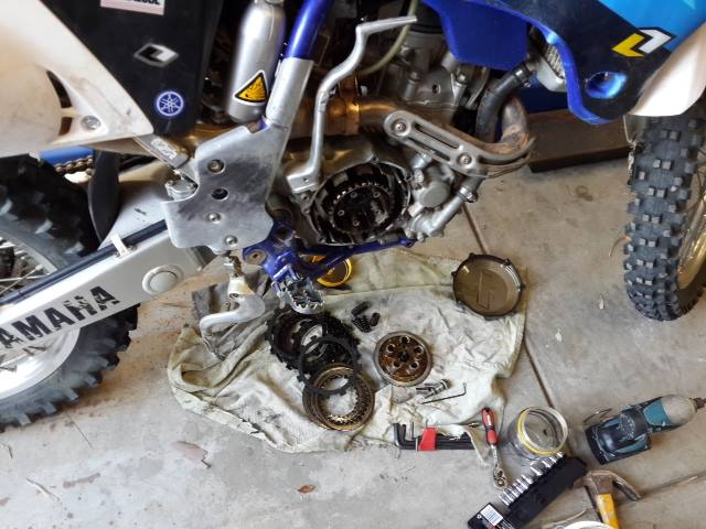

The radiators had 2 out of 3 bolts missing each, the gear lever splines were stripped, causing the bike to get stuck in 2nd to return back to the trailer and overheating the clutch, upon examination of the clutch plates, there was no material left, some facings down to the metal, the oil was very questionable about when it was changed too by the colour.
