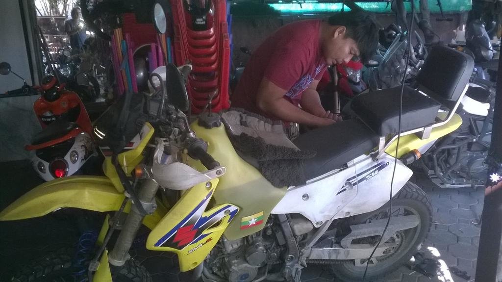

Not really riding the Suzuki DRZ 400 much these days. A friend had some special seats fabricated for a big tour on these bikes, looks like it will make a good touring seat for my daughter. We'll even be able to secure her to the seat for when she falls asleep. Will test soon.
