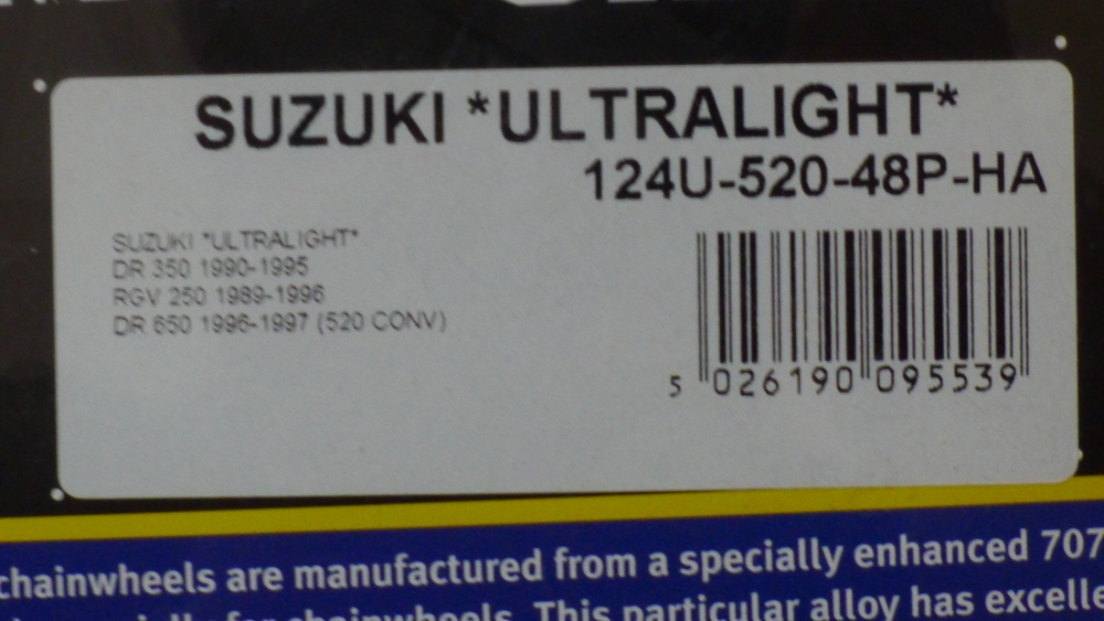

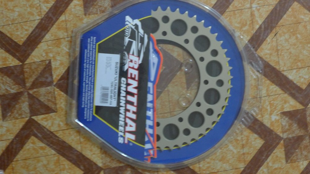

For the Japanese imported Suzuki DRZ 400, the rear sprocket is the same as the Suzuki DR 650 1996-1997 (520 chain conversion) or Suzuki DR 350 1990-1995.
The Renthal Chianwheels part number for the 48 tooth rear sprocket that will fit the Japanese imported Suzuki DRZ 400 is below.
These are the dimensions of the Japanese imported Suzuki DRZ 400 rear sprocket
