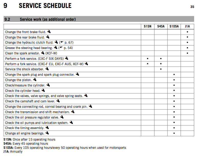

OK - big no to them then. Well, guess the 350 service requirements are pretty similar - so if you don't need anything special, I should be alright. I'm not bothered about basic service stuff - as long as I've got the parts. It's some of the 100 hour / yearly stuff I'm on about. Anyways, will order some parts and manual from US soon... Yes, an extra fuel filter is a good idea too. Ta.

Thats not unreasonable, KTM say 105 hours. Depends how the air filter was maintained really and how it was ridden.
80 hours doesnt sound like much, but for a pure offroad bike thats quite a few rides.
