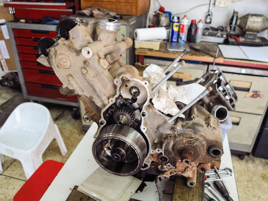

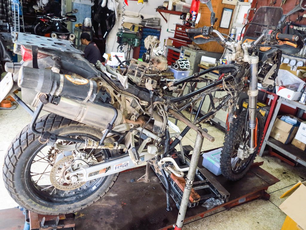

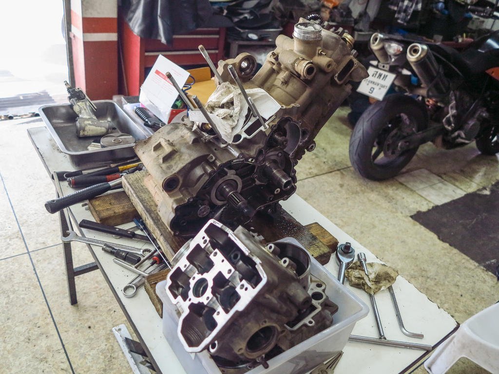

Lots & lots of hard Km's, starting to use lots of oil, fuel economy down, time for a full engine rebuild in Thailand. Getting the parts together took 3 months, all here now, so finally under way

I'm no expert but I'm fairly sure cleaning the engine before a total rebuild is near the top of the "to do" list.
jkrfjessjess
Nov 10, 2011
Honda Wave
Depends if there is a warranty on the work done and also how hard the KM's were
LUFC
Jun 21, 2011
Berg 300, KTM 350, Trials Scoot
Ah now I get it, if it's not been ridden hard but is covered in shit it doesnt't need cleaning. I've lucked out, no need for LUFC to clean another motorcycle.

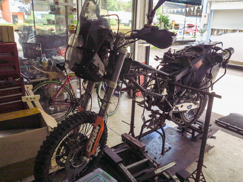

I went down there and the "mechanic" wasnt there, I havnt seen him yet since he started working on it, was a little horrified too.
LMAO...good point
When I saw the pics I was going to ask why it is that, here in Thailand, asking a mechanic to actually clean everything before starting to disassemble is like asking them to eat shit or something worse...then they wonder why new seals leak?
No insults intended Phil but when you took those pics I hope you told the "mechanic" that you expect to see shiny metal components before he starts to reassemble? I was going to pick up my truck on Friday...but noticed oil leaking and after closer inspection, every seal they changed and including the connections to the oil cooler were leaking...and this in a Toyota garage who's been redoing the repairs of the shady garage my insurance chose. Another lesson learned for me, I hope you do not have to go through the same...Cheers mate
