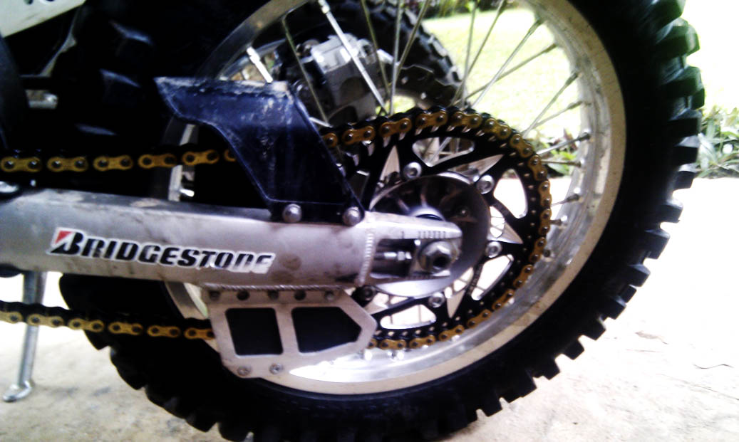

It is mounted and yes I had to change the chain, and my finding is that 13/48 on a klx250 is just perfect, get loads and loads more punch out of the bike, and still max at 115-120km/s.
It should be the stock gearing to my opinion (or maybe 13/46 since it's a dual-purpose).
Sure felt nice riding it last Sunday at the track.
