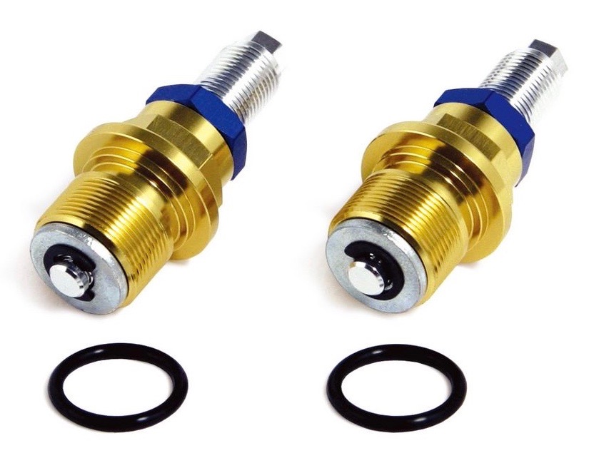

On another note, somewhere as currently misplaced among all the ongoing vehicle projects and extensive TBR team parts inventory at hand, I have a neat set of special custom fork pre-load adjusters out of Japan (similar to the ones pictured I use for my Honda Z50JZ "Monkey Bike" custom builds) and once they are found again will install them of course ~ stay tuned.....
Nope, had them as well or better ~ still have them, they did not fit, as mention, got some special fork springs through a contact in Japan with some other bike parts I had on order...
Sorry ~ no pics available of the springs installed at this stage but they just look like fork springs (progressive)....
