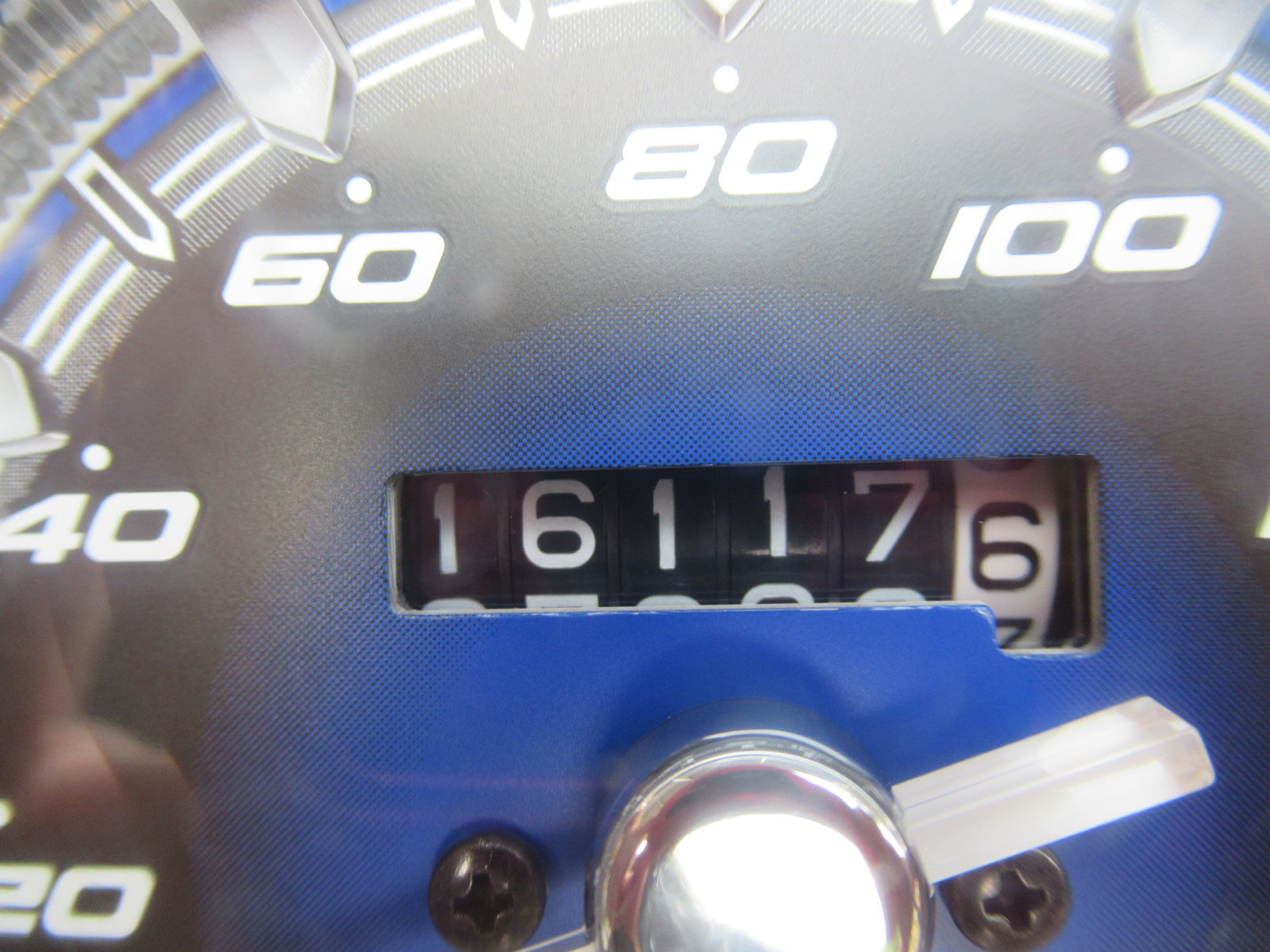

The final mileage as I handed it over to my friend this morning

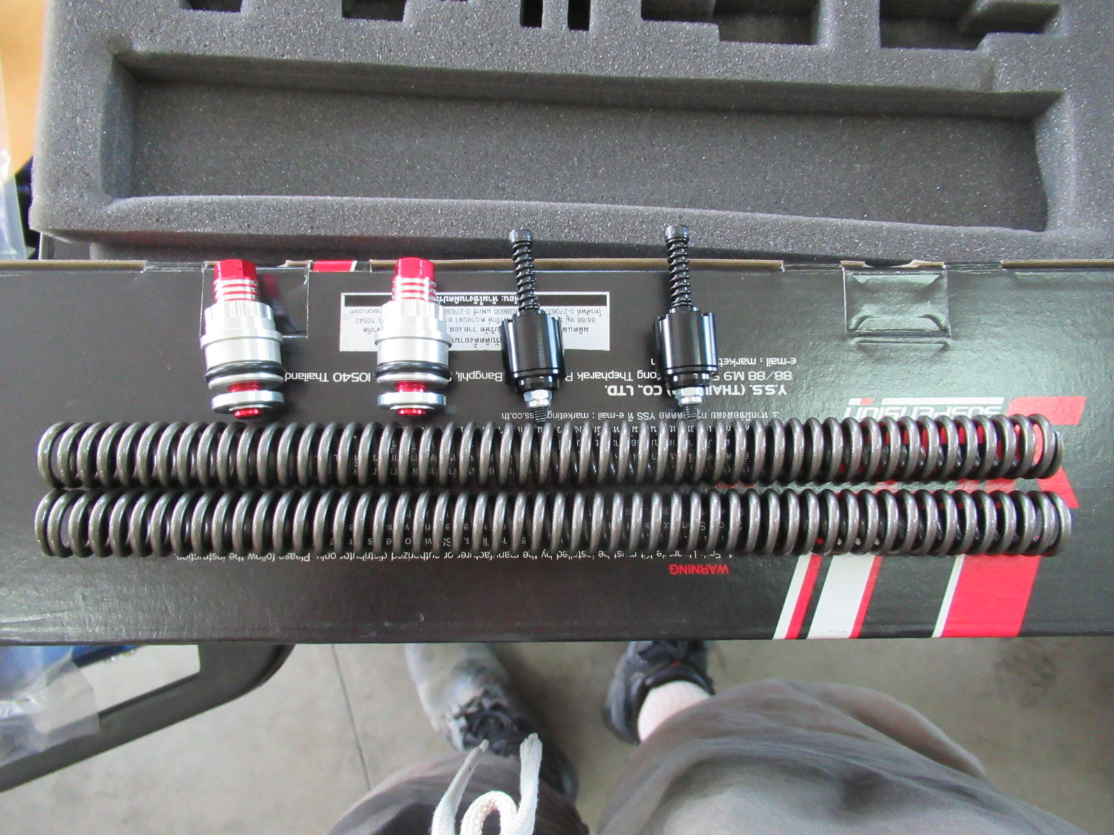

3700 Baht for the front fork upgrade kit with preload adjusters
76496

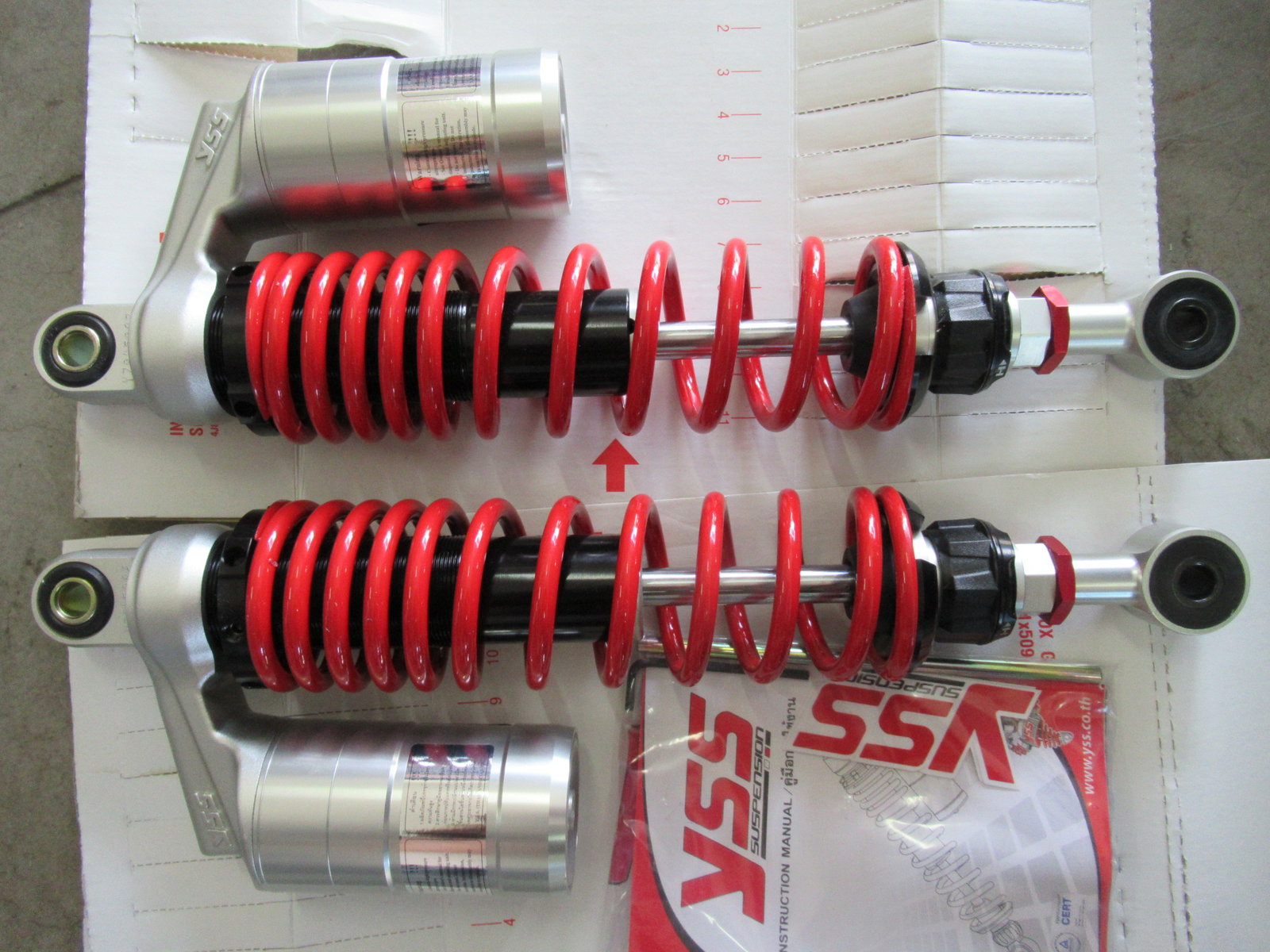

7900 Baht for the rear gas shocks with both preload and rebound damping.
The suspension upgrades were the best money I spent on it, it was a totally different bike with them put on and set up properly by CMS and I recommend them to anyone who rides these a lot.

I just upgraded my Wave 125i with YSS rear shocks (G-Wave). Yours look a bit different than mine. What model are those? I am curious because with mine, I was not able to put the chain guard back on due to the lower end of the spring hitting it. Were you able to keep it on with those?
David
CMS fitted mine, they had issues fitting the rear with some cutting of plastic needed to get them to fit properly but the chain guard wasn't a problem and is still on there.
Mine were 7900 and have both preload and rebound damping and are 1 cm longer than standard, they are the G series but I cant remember the exact model, the photos are on my laptop, next time I use it I will look it up.
How much were they?
How much were they?
I paid 3900 baht for the YSS G-Wave shocks.
David
They were probably the ones I originally was asking for but the guy at CMS recommended spending a bit extra for the ones with rebound as well as preload as I am doing off road riding
Were you able to keep the OEM chain guard on with the recommended ones?
