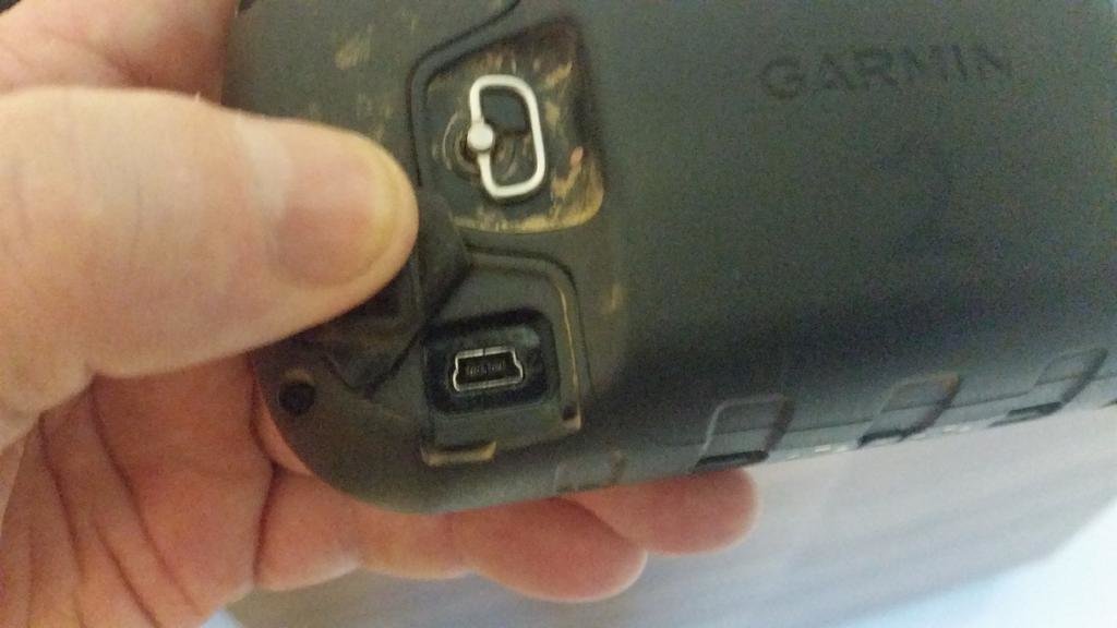

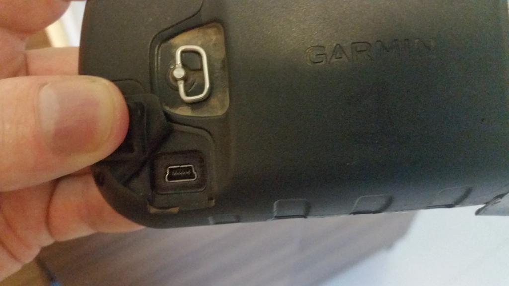

Having the touch of a midwife i have damaged the mini usb connector on one of my Garmin Montana's, i have tried to source a fix locally but to no avail. Anybody know where i may be able to get it fixed without having to ship it back to the USA and incurring taxes etc ?
This is the good one.

The broken one, looks like with of the connecting pins is broken or bent.

Bob - you might try a camera repair shop. Some digital cameras use the mini USB - my old Sony does.

If you found someone that replace the Mini USB Plug and use a Plug from some other device like Camera or Phone .
It need all 5 Pins to be usefull in a Garmin montana .
USB mini Standart is 5 Pins but most Device use only 4 like on the bigger USB Plug + and - for Power supply and + and - for Data .
Garmin however use the 5te Pin in USB Mini Plug with a jumper to Ground or +5V (don't remember )
Thats the reason why updates work only with the original Garmin Cable .
So the New Plug in your Montana need all 5 pins correct conectet or you get Problems to Update that thing in the future.
