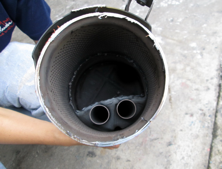

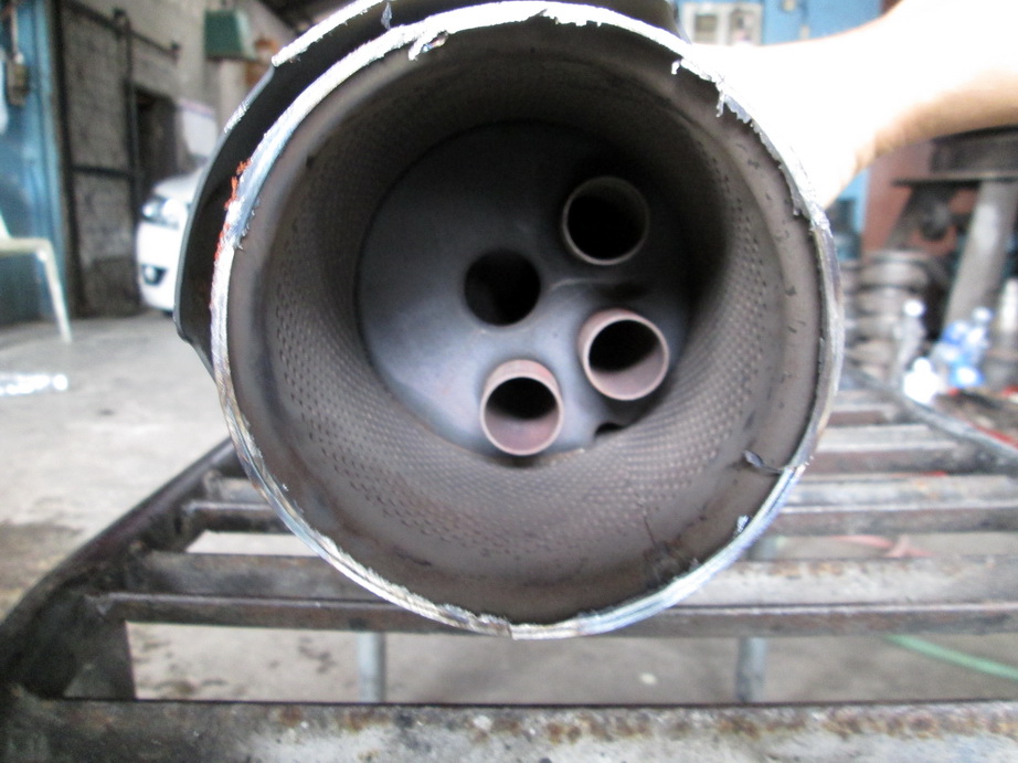

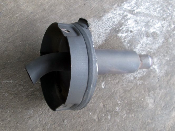

There's the exit wall with the end pipe, there are two walls in the muffler which are connected by small pipes and then there's the catalytic converter.
I just wanted a bit more sound and volume, no open, roaring race pipe, so I went to a shop and had the wall close to the exit wall taken out. The other wall and two small pipes stayed in. I cut the end pipe short so that it only stuck out to the outside and then closed everything back up. The result was about a 20% increase in volume but the sound was still crappy, like a stock bike. Can't recommend to do this. This is how it looks when you cut off the end wall:
This is how it looks after taking out the first wall with one pipe:

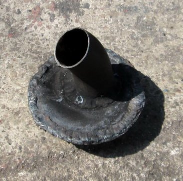

Okay, so the second wall had to go, then there's only the cat in there, see how that sounds! I had a new end pipe made from a 1,25" steel pipe and some holes drilled into the part inside the muffler. The now empty muffler body had only the cat to slow things down and a bit bigger end pipe. Welded it up and hopefully it sounds acceptable! Well it didn't. It was too loud and sounded like a big hollow steel can which it effectively was. At least now I made some noise, I could hear the sound while wearing my helmet. I was surprised that the bike ran like nothing had happened - no hiccups or backfiring at all, just business as usual. Amazing.

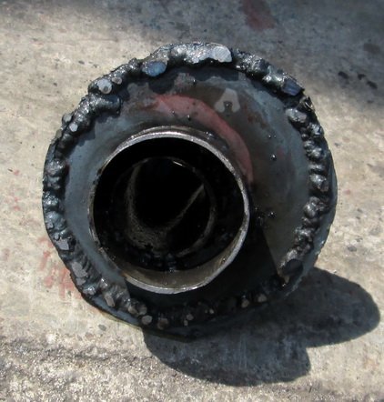

Stock end wall and pipe, 1" (Thai version):
The one I had made, 1,25":

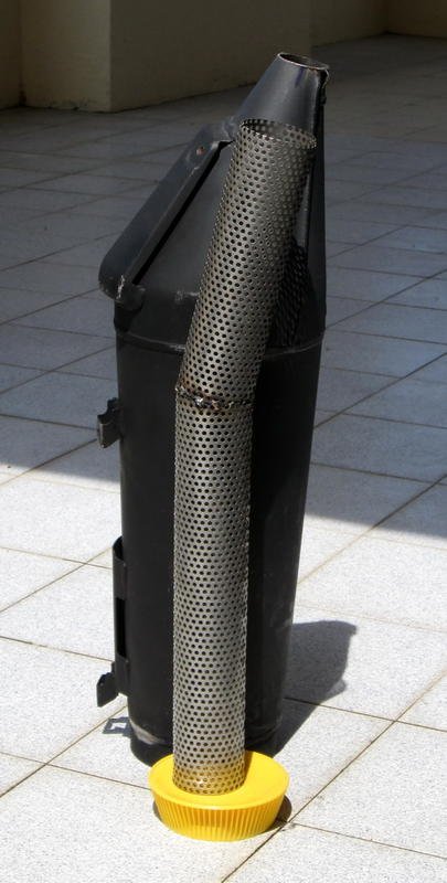

Now I decided to go all the way. Cat out, core with muffler packing in! I read up on how other people had done it, some went with a 1,5" core and 1.5" end pipe and locally available fiberglass muffler packing. Several shops here in Thailand offer the complete package for 1,200 to 1,500 Baht. But I wanted heat-resistant high-quality muffler packing which is not available here so I had to order it which took some time to ship and cost more but it should last longer.
Then about the size of the core: the muffler body is 4" at the end wall and 6" at the widest part, that's quite voluminous! This ain't no light, slim, short aluminum slip-on, this is a heavy, double-walled steel body. A 1.5" core seemed to small because then I'd have to make up for the room around it with packing - 2.25" at the widest part, too much! So I decided to go with a 2" core, still enough space around it and a 1.25" end pipe, a bit smaller, should keep the volume down and provide more back pressure. (I've seen some 2" end pipes!)

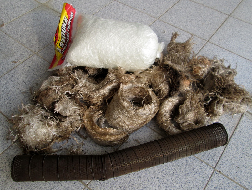

So off to the next shop, get the 2" core made; the FMF Racing muffler packing had arrived and we're ready to go.
The perforation of the core seemed a bit coarse so I got some stainless steel moskito netting to wrap around it.

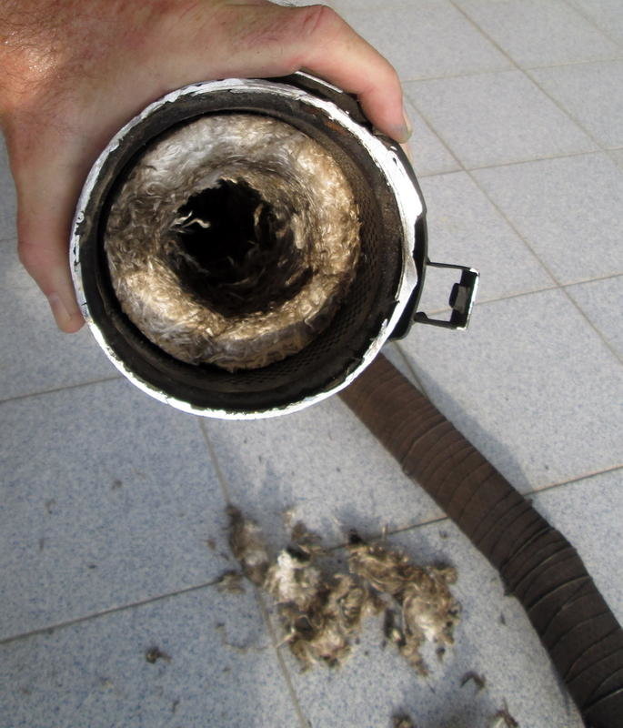

This time we went in from the rear, not from the side (note the catalytic converter):

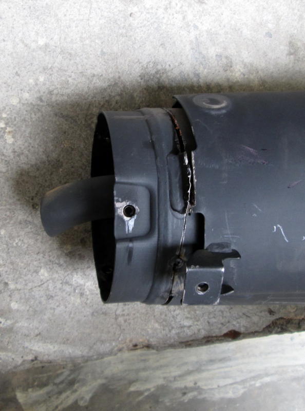

Only the first time we opened the can from the side which I don't recommend:

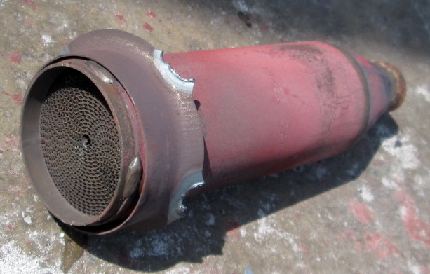

Here a picture of the culprit after extraction:

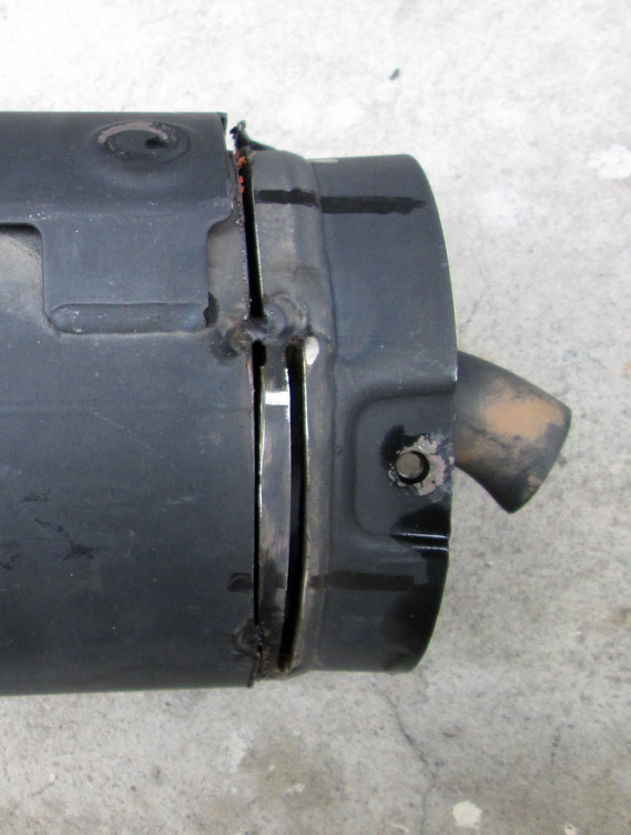

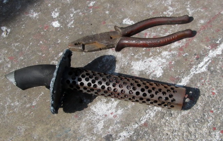

Then we had to cut the core so it fits into the muffler body. Cut at about 10" to 12" and reweld the shorter end in a slight angle:
Here I already wrapped the sucker and tightened things up with wire:

After positioning the pipe and cutting it to the right length so it fits at the end wall we welded a 1" long piece of 2" steel pipe to the end wall. The 2" piece has to be a bit smaller in diameter than the core so it fits snugly inside:

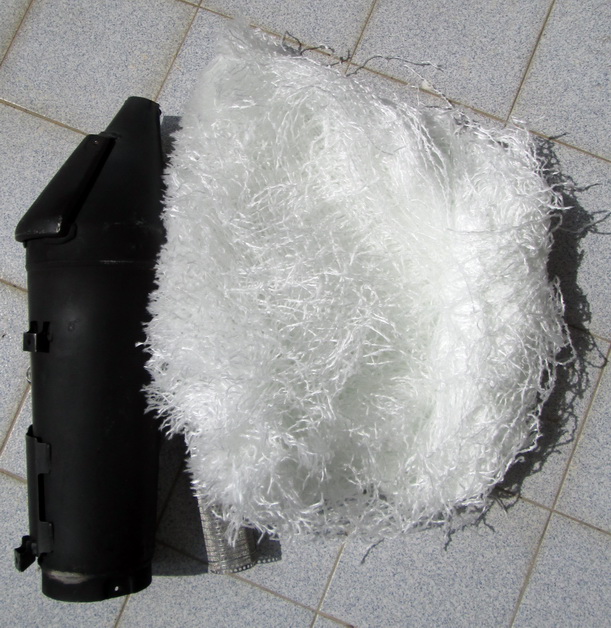

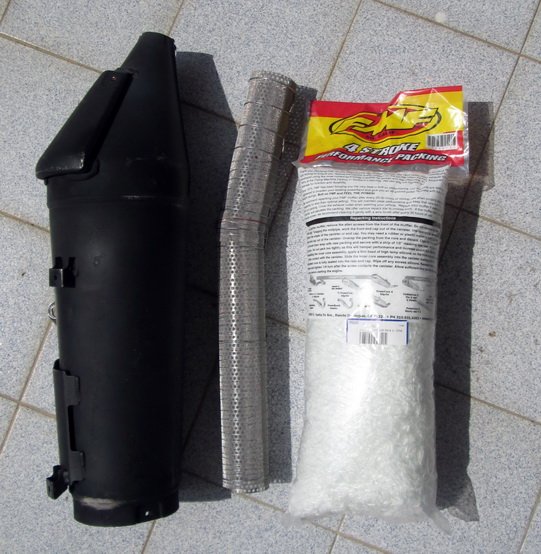

Now to the fun part: stuff the muffler with packing! This packing sold by FMF Racing is designed for motorcycle exhausts and holds up better under heat. Normal fiberglass or steel wool gets brittle, breaks down and blows out after only a few thousand miles. Since I have to weld things up I want it to last as long as possible.
I stuffed it fairly tight and used one and a half bags - the muffler body is about 18" long without the cat!
Here's the stuffed muffler body, 4" in diameter with a 2" core, and that's the slim part!
Now we fitted the end wall back on and welded it shut.

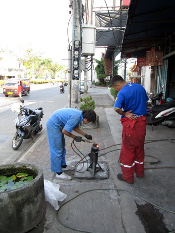

It's kinda hard to describe the shop - they do metal work, things like rain gutters and chimneys for restaurants, made out of ss sheets.
Also these round ventilation things that sit on roofs and turn, driven by the wind, and stuff for boats, covers for the exhausts that go straight up.
They're hammering all day, cutting metal, bending it, welding it and hammering it.

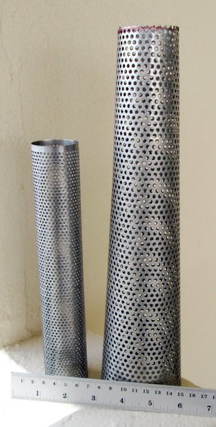

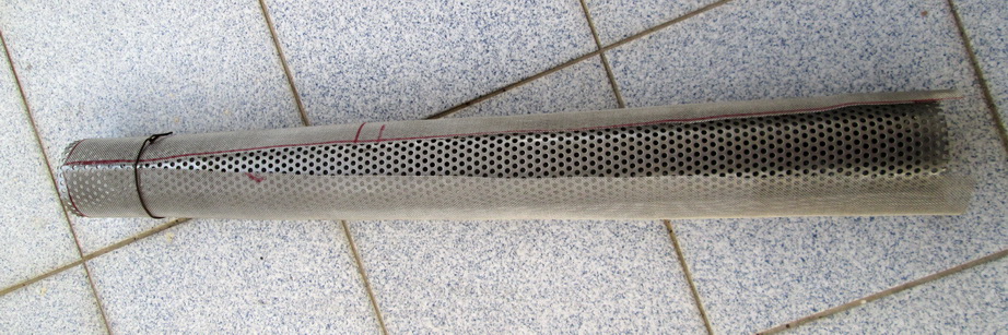

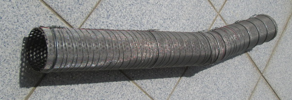

The core on the left has smaller perforation, is 1,5" by 9" but you can bend it by hand easily. Got it from a store that sold all kinds of metal stuff. It goes into the silencer of a two-stroke, probably older 125s. Seemed too flimsy to me. 100 baht.
The metal comes in sheets of maybe a square meter. The one in the pic on the right had the smallest perforation, I wrapped the core with ss moskito net just to be on the safe side. They also had some woven metal screens, really cool-looking, I always wanted to go back and have a closer look at it.
The cores were only 200 or 300 baht, I had two made. They spot weld the seams with what looks like pointed copper rods.

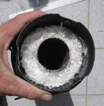

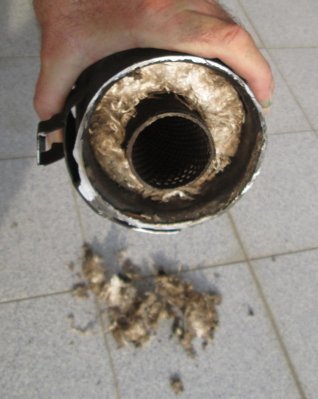

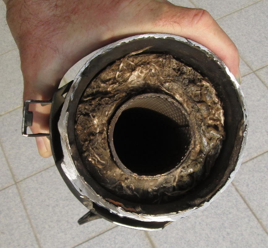

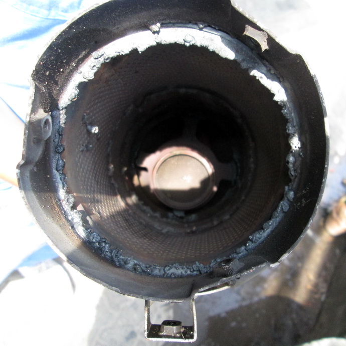

Time for an update! The muffler started to sound a bit louder, a bit different, and since the packing has been in there for more than one year and about 15,000 km I thought it was time to repack it.
I wasn't sure if the moskito netting would hold up in the heat or if the packing would burn up and blow out, but to my surprise things looked really good in the muffler.
The packing compressed and there was some space around the core which changed the sound, and of course the packing soaked up a lot of dirt.
The moskito netting around the core looked good, but will be replaced.
The packing got fried when the end cap was welded back on.
The major part of the packing was not burned, just dirty.
There was space between the packing and the core even though I stuffed one and half bags into the muffler.
I could pull the core out with the packing inside.
The core was spot welded at the bottom but I guess the vibrations knocked it off.
I guess the packing compressed because it was soaked with dirt.

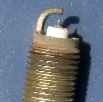

The plug looked okay at 8,000 km but now at 19,000 km it shows that the bike was running lean.
I replaced the stock air filter at 12,000 km and besides the muffler the bike is stock.
Looks like a fuel controller is a good idea!
Correction: I didn't realize that an iridium plug has this pointed shape; I thought the electrode has been burned away from running too lean.
I got me a new one (almost 600 baht!) which looks similar but of course cleaner. I guess all plugs will have a slight tan discoloration from running a bit lean in stock condition after 19,500 km.
I'm using the old plug for now and it seems that a fuel controller is not necessary, even though one wouldn't hurt.
