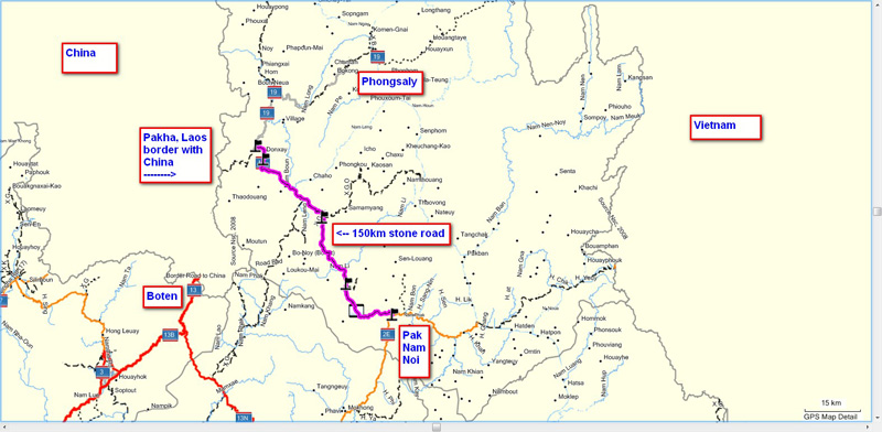

Route 1B (in NE Laos), the 150km stone road that goes NE from Pak Nam Noi and joins to R 19 which goes NE to Phongasly is a bitch of a road.
Copyright GT Mapper
An experienced rider in laos who has a Honda Baja 250 refuses to do this road now as his headlights come loose no matter how much locktite he applies to the fixings nuts.
It's hard on you but harder on the bike, something will come loose, my rear fuel tank which was locktited everywhere nearly fell off --first time ive ever had something come loose on the KTM.

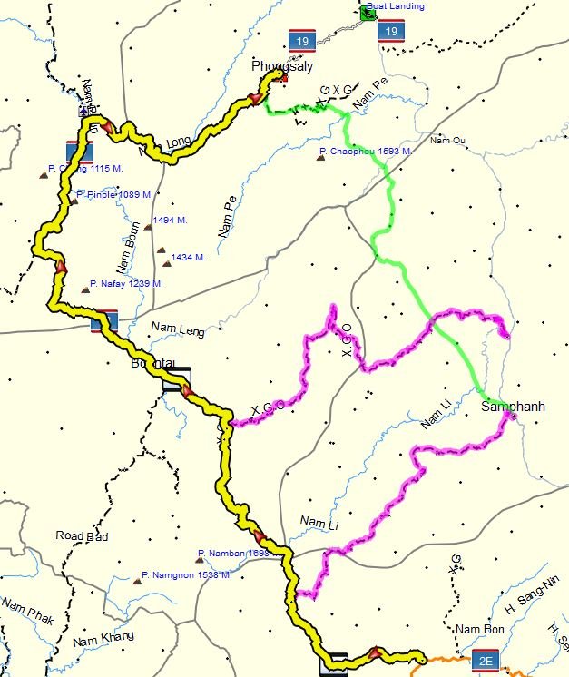

Tried to merge the maps together but somehow could not get them to merge properly - so hereby the improved unpaved road (in green) according to maps prepared by the Ministry of Energy superimposed on MapSource which shows also the 2 day shortcut KTMPhil mentioned (in magenta) and the stone road and the asphalted parts (in Yellow) from the turnoff in Sinxai (Rd 2E) to Phongsaly.

It looks like the very north end of the road you have in green, where it intersects R 19 may come out where the 400 year old tea trees are?
Yes, as far as I know you have been on this road to the 400 year old tea trees. The improved unpaved road branches of from this road roughly 17 km from Rd 19 or about 6 km past the 400 year old tea trees.

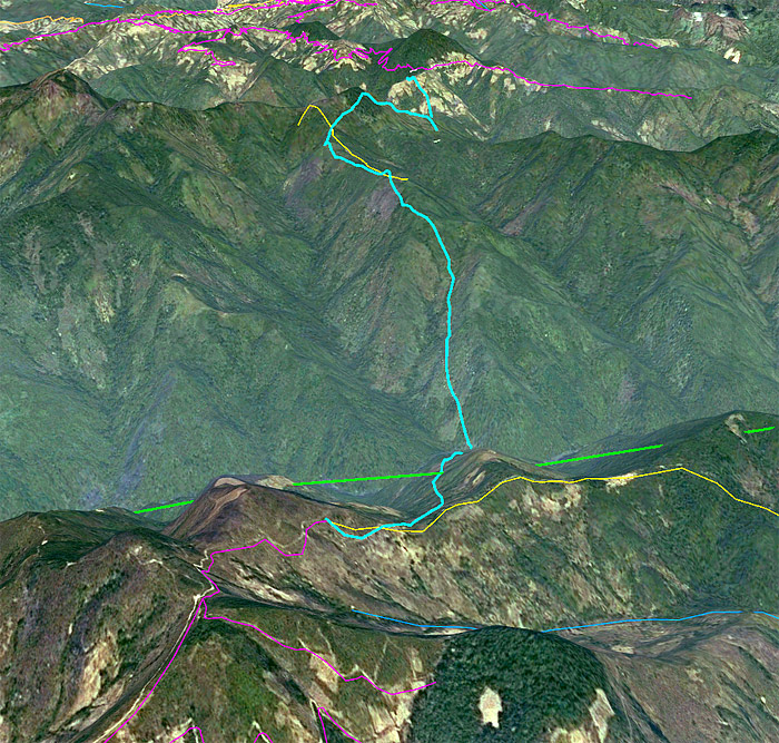

Midnight Mapper thinks this way "may" be possible
"This section looks "real" which would link these road networks, "Tea road" to The "American Road"
This is looking north with the 1st magenta track (that joins onto the northbound light blue track near the top of the picture)being the dirt road last leads to the 400 yr old tea trees (off of R1 19), the second magenta road right at the very top of the picture being the tarmac R 19 that leads ENE (to the right) to Phongsaly

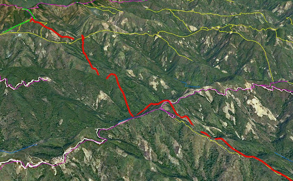

[attachment=0:33v23wtb]tea rd to american rd phongsaly.jpg[/attachment:33v23wtb]
This 3d map viewing is very interesting
I am not going to speculate - as I said this is what Laos Government maps are indicating with regard to roads. As MM said, this looks like nearly impossible going up and down the valleys and I agree with MM. Will be there in a few weeks and will let you know what I see "on the ground" - that is the best I can do at this point in time.

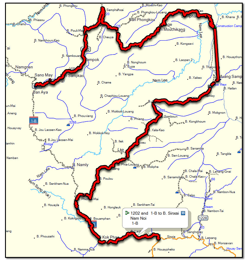

From Paknamnoy on the 2E you head north on the 1B then turn right onto the 1234 at Ban Phicheumai.
You follow that to M. Samphan then head north again until the 1202 then head West.
When you get to B. Samphanxai, you turn right & head North until you get to B. Phoumon
Looking at MM's map, you can get to Ban Phoumon & that's within 11klm's of Phongsali, then his map shows a "trail" leading into B. Phagnasi just outside Phongsali.
Looking on GE which is 12 years old, there's nothing north of the Ban Phoumon. It looks a bit dodgy as there's steep valleys & 2 rivers to cross.

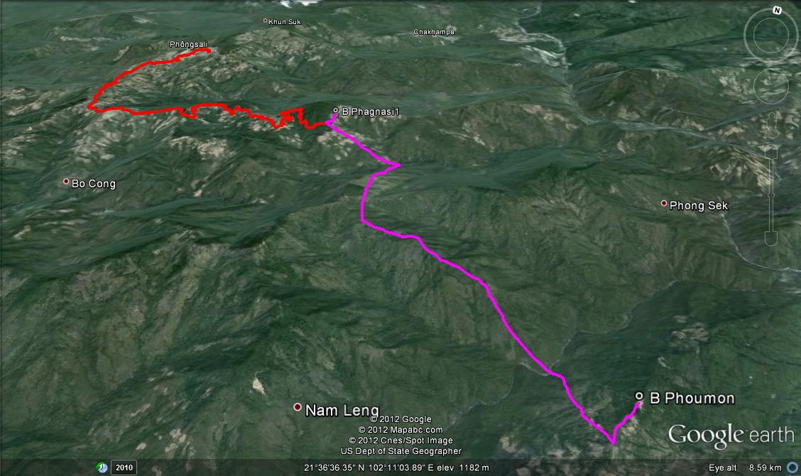

You can see the magenta line is the "trail" from B. Phoumon to Phagnasi then the red is the road into Phongsali.
Does anyone know if that "trail" is actually there & is it rideable?
