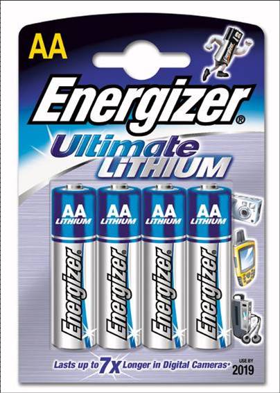

Based on my recent tour, the new AA Enhanced lithium are the best (62cx garmin). They can last 3 days of full riding with some hard usage, longer for only simple guiding.
Pics attached
But the Evolta from panasonic are also good and... they are available in thailand, lao and cambodia (in cities... not in kampong!)
Indeed the hard connection wire for those gps are a complete mess... keep disconnecting while riding.
enjoy

Yes I was advised that the 60Cx which I use is a much better unit then the 62 concerning the hard wired option
I'll second lithium batteries.
Haven't used anything else since 02-03 while in the military and for all my gear during contracting as well.
