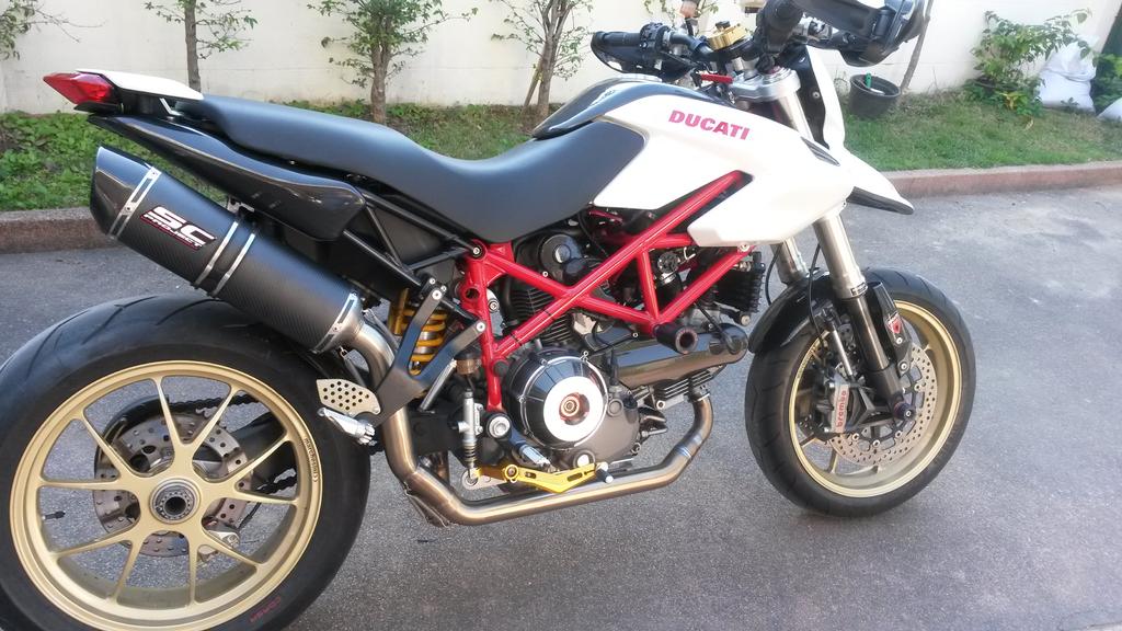

good to hear your lovin the hyper phil.Im lovin mine too and just put a new tyres,pipe and reflash the ecu.its a totally different animal now with a voice.off to nan in a couple of days to give it a good run hyper new exhaust.jpg

nice addition phil.i bet that gives a nice crisp note.the dukes do need it and strips a lot of weight too
