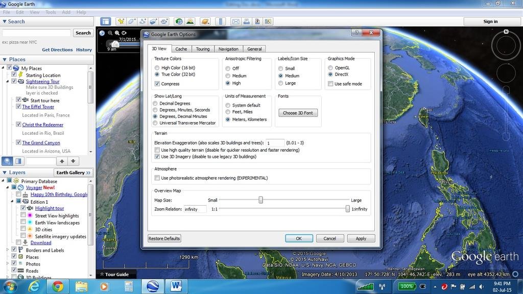

It’s easy to set up Google Earth to display the same coordinates as your GPS that uses degrees decimal minutes (hddd°mm.mmm). Open Google Earth, click on “Tools” then click on “Options” on the drop down menu.
In the dialogue box under “3D View” there is a setting for “Show Lat/Long”. By default Google Earth is set to “Decimal Degrees” we want to change this to degrees decimal minutes.
To do this just click on the “Degrees, decimal minutes” and now click the “Apply” button and the “ok” button. Google Earth will now display the same coordinates that your GPS uses and that you can use with your GPS.
