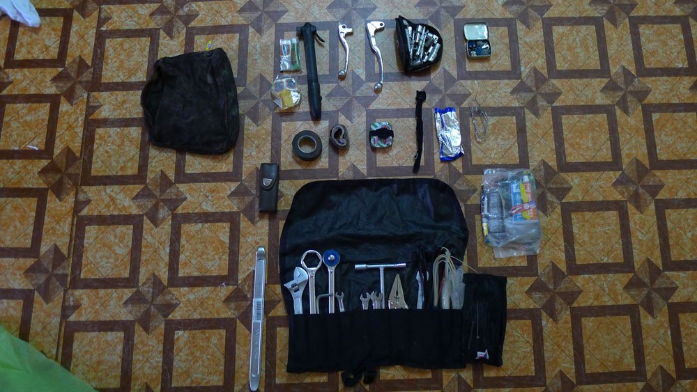

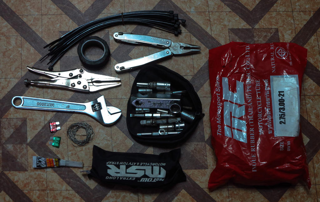

I dump all the factory tools and build my own tool kit. All this never goes back in the tool box at home and is kept for trips on the bike.
Everyone's got their own ideas about what to take, with this i can get out of most usual problems.
Top row, left to right:
leather tool bag
tube repair kits
hand pump
clutch and break levers
motion pro tool kit (see details below)
electrical fuses and connectors
Middle row, left to right:
leatherman (or multitool equiv)
self amalgamating tape (NOT STICKY -STICKS TO ITS SELF WHEN STRETCHED UNDER TENSION)
electrical tape
bolts, nuts and washers in small metal box
vecro ties
wet wipe tissues
monel seizing wire
Bottom row, left to right:
big tire iron
adjustable wrench
ring spanner/ tire iron/ 3/8" socket combo (motion pro see detail below)
8mm, 10mm. 12mm, 13mm & 14mm (for rear view mirror lock nuts)
3 way t-socket 8mm, 10mm & 12mm sockets (dont really need this as the motion pro toolkit has all this)
needle nose vice grips -----a multitude of uses - emergency lever or pedal
lots of wire/zip ties
2 part epoxy
super glue
tool 1 by Triangle Golden 007, on Flickr

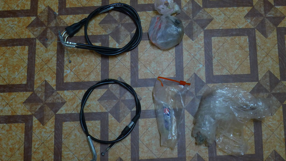

2nd photo:
throttle cable
wheel bearings
clutch cable
spark plug
chain links and spare masterlink
tool 3 (1) by Triangle Golden 007, on Flickr

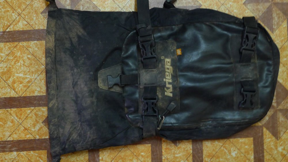

All fits in a waterproof Kriega 10 liter tail bag
tool 2 kriega by Triangle Golden 007, on Flickr

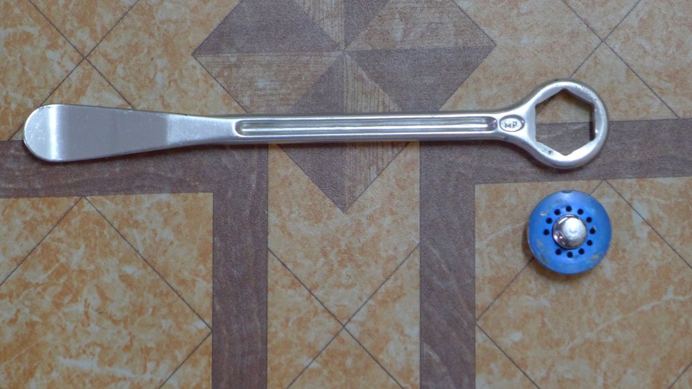

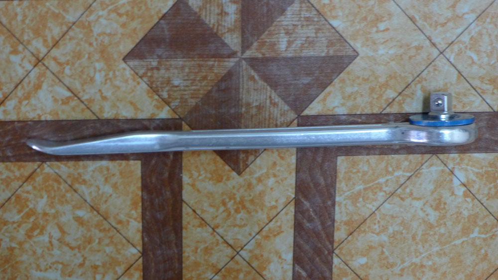

The motion pro tire lever/ ring spanner (for wheel nuts)/ 3/8" socket drive, is really light, i never go without this
tool 5 mp iron by Triangle Golden 007, on Flickr
mp iron socket by Triangle Golden 007, on Flickr

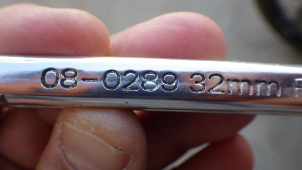

Couldn't find locally the tyre irons with a 22/27mm for my axle nuts. Nor can you get a double ring spanner with these sizes so made my own. The 22mm (front axle) torque is low so left as much length on the 27mm side as possible to torque that rear nut up.
If they want to pass off copy stuff as real I think they need to put some extra effort into the spelling department!

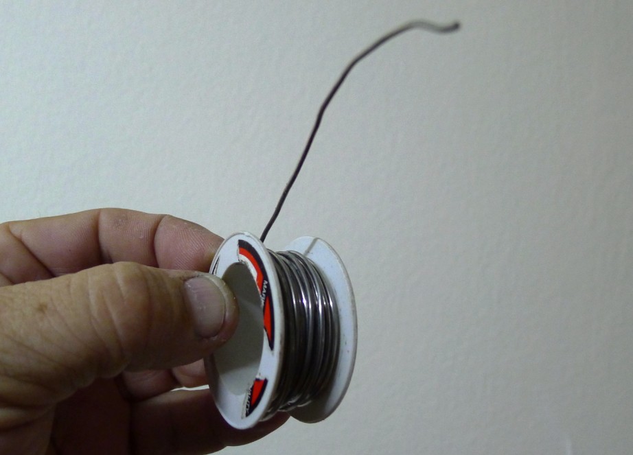

1. Monel Seizing wire
"Non-corrosive Monel Seizing Wire is ideal for marine applications because it bends & twists easily making it great for securing rigging screws, shackles for anchor rodes, piping systems, pump shafts, trolling wire, and strainer baskets etc."
http://www.go2marine.com/product/196216 ... spool.html
Was used to secure the "engine" end of a jury-rigged clutch cable, to the clutch disengage lever on the crankcase, did a perfect job because of its malleability without snapping.

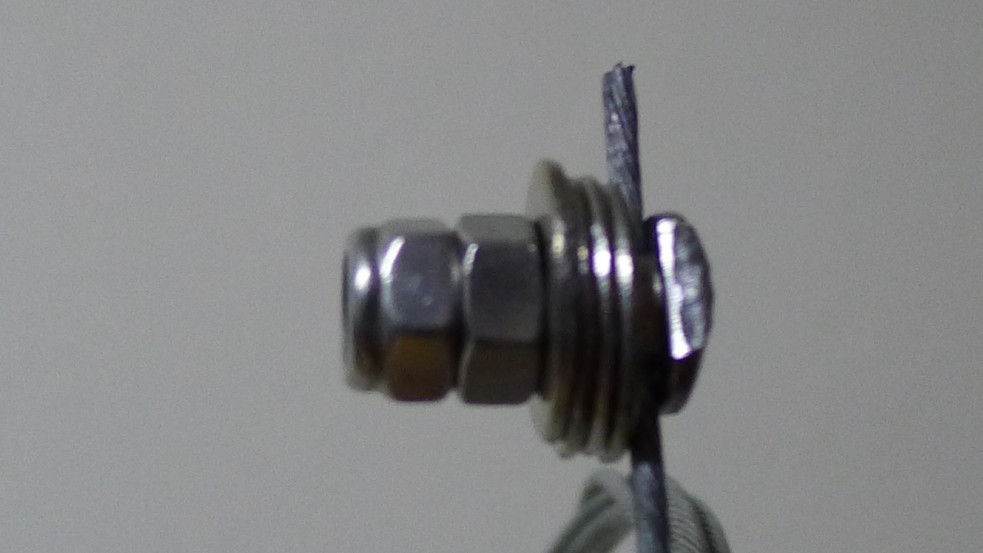

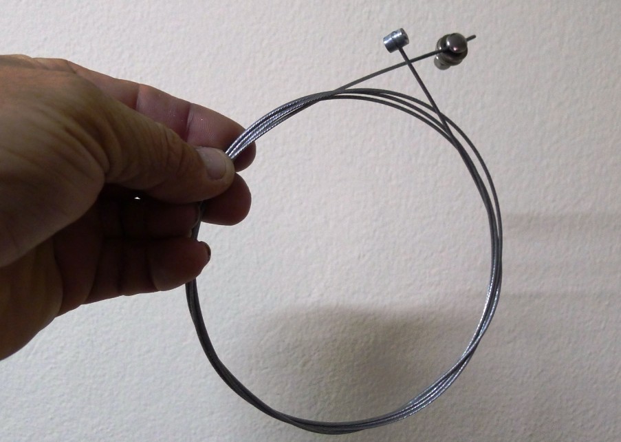

2. Bicycle wire inner cables with adjustable stop-ends
If you get a snapped control cable, pull the inner wire cable out out, thread the long bicycle cable inside your existing outer cable adjust to length using the adjustable stopper with a lock nut to clamp the inner wire in place & you're ready to go again
Close up of the adjustable cable stopper to adjust to the desired length, an easy fix

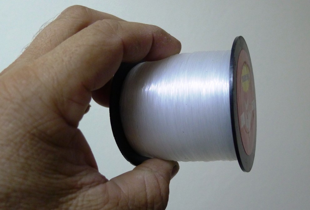

3. Mono filament fishing wire
This is one of Midnight Mappers ideas, after seeing 10 meter wooden fishing skiffs held together only with fishing line in Micronesia.
Basically, if you wrap 10kg test fishing wire 100X around 2 things to be held together, think of the strength it has? Easily used in tight fiddly places and enormous strength when wrapped multiple times, which cable ties don't have.
This would be an excellent way of jury rigging a broken frame for instance. Also with epoxy and the fishing line, you could fabricate something (broken lever etc...)

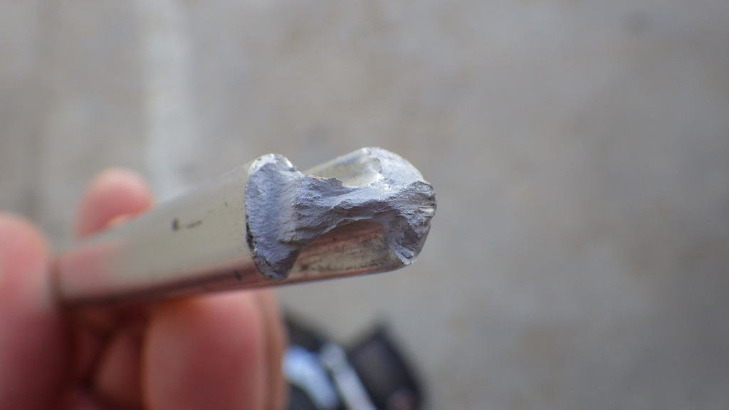

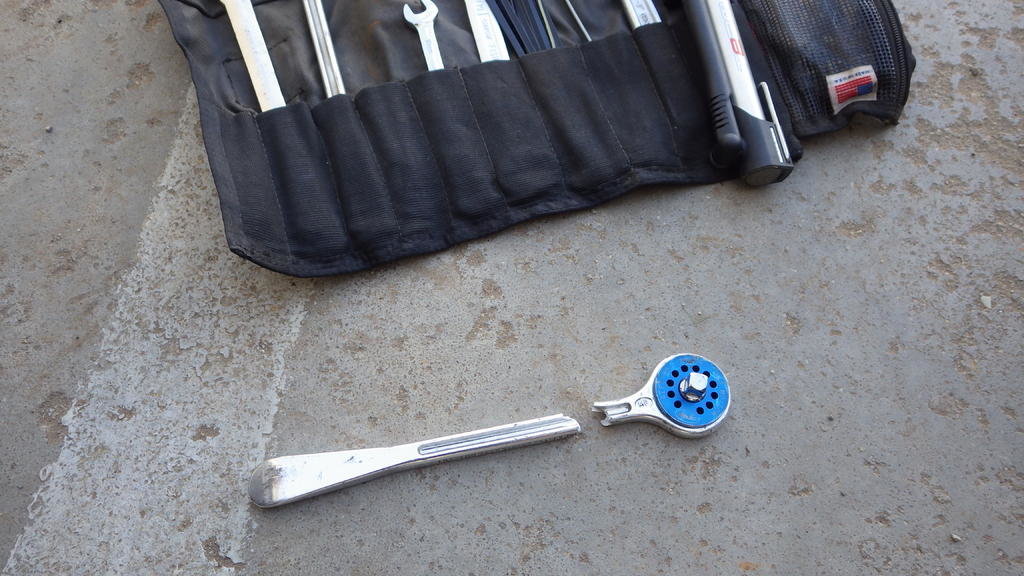

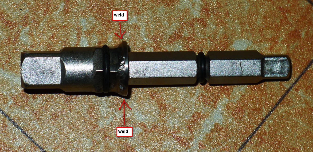

A heads up for those out there using one of these Motion Pro multi tools:
Earlier in this thread I was advised that this was a decent product, I searched on the internet and quite a few people vouched for them being well made. Being a satisfied owner of a few bits of Motion Pro kit I was intrigued so bought one after examining Phils example. Since Trail tools are generally only used when the shit hits the fan and broken bikes need to be mended, often times to get you back, they need to be reliable and trustworthy. Because of this I used it in the garage for a couple weeks to make sure it accessed everything well enough and worked without issues. I was pleased because it worked well enough that I could use this tool to replace my standard sliding T-handle w/sockets, allen wrenches, and 4 bit screwdriver. it saved a decent bit of bulk from my toolkit and seemed reliable so I was pleased as punch. I added to the kit the optional Allen key bit, 6&8mm sockets, and a 3 inch 1/4" drive extention, all fitted within the kits case. Very cool. Took it to lao on a tour with Transmoto sport and it worked well.
Back to Thailand on a day ride w/a friend and needed to remove a 10mm bolt from a case guard during the ride. We whipped out the motion Pro tool and went to work...................uh oh. Product failure!!!
The socket driver portion of the kit I believe is two pieces pressed together with some type of epoxy. Sadly the epoxy ain't working resulting in the two pieces rotating and having no torque put into the fastener. Just a forewarning to Phil and others that may be relying on this piece in their kit like me. I received an email from Motion Pro that stated they have had this happen before but only rarely. Typical excellent Motion Pro service they mailed me a replacement socket driver. Trouble is I now don't trust the product and have since reverted back to my trusted sliding Tbar, sockets, screwdriver and allen keys.
Phil were you able to source that wire here in Thailand? looks like some nice stuff since it doesn't rust in the tool kit.
Justin- The monel seizing wire you probably could get in Pattaya in a marine store, it's widely used for seizing anchor shackles.
As to the motion pro tool, I'm shocked that you had a failure as their products are normally first class. I've used mine now for over a year in some high load situations and never had a problem.
I just did a search on the net and there doesn't seem to be any links to other failures.
Thanks for the tip on that wire as my lump of bailing wire that I used to carry when riding in the desert with no problems rusted into a lump in my pack over here due to the humidity.
The Motion Pro failure was a surprise. I own a few of their tools and they have always been well designed and made with no issues. i talked with Motion Pro tech guys and apparently I'm not the only person to have this incident according to them, but it is indeed rare. This in my eyes tells me i cannot trust this piece as designed. As mentioned I worked with the tool for a couple weeks on the KTM and Yamaha making sure it accessed everything and worked without issues and it was fine. Then on the trail, working on the Yamaha yet again, or I should say Johnny was, (did I mention he loves my YZF) and the socket driver failed. Ideally that socket driver piece would be made out of one piece but due to manufacturing costs its made with multiple pieces press fit together and that press fit failed. Here's the joint that failed.
Motion Pro was nice enough to send me a replacement here in Thailand but bottom line due to the design I just don't trust it as designed anymore. I dropped the driver off at Joes yesterday and asked if they could grind down the joint on two sides and weld the pieces together. If the weld penetration is decent and neat enough I'm hoping it should work, we'll see.
So back into my kit go my old reliable bits the Motion Pro was meant to supplant.

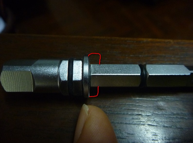

I'm going to get mine welded in that spot too for safety
Is the piece marked in red one casting? Need better light to see if there's a join.
I can't tell for sure with my crappy eyes if the spot in red is one or two pieces. Since I cannot be sure if the driver is two or three seperate segments I'm having all three surfaces welded together to be sure. I'll bring it by once its welded so you can have a look.
Phil, Good job and 100 baht well spent. just to be safe i would also tack the other side of what looks like a disk as we're not sure if that is a seperate piece held in with epoxy and could fail.
Does the bead of weld interfere at all when mounting the drive socket into the tool.
I'm worried the bead may keep the socket driver from ligning up with the tool correctly.
The weld does not create a loose fit at all.
If you look at the middle piece that looks like a washer, it is hex cut, the same as the smaller shaft, so has a good mechanical mating with the smaller shaft, no weld should be needed.
Just got the piece back from Herman at Joes after he got the welding finished.
The tricky part was welding between what looks like a washer and the 3/8" socket driver on the left side without the welded bead interfering with instalation into the tool. Thankfully it came out well and still fits into the tool snugly.
Phil you may want to get the other side welded as Herman said to me that it was still spinning when he only welded the one side that you have done. It does indeed look like it should not slip due to the two hex shapes mating with each other but it was.

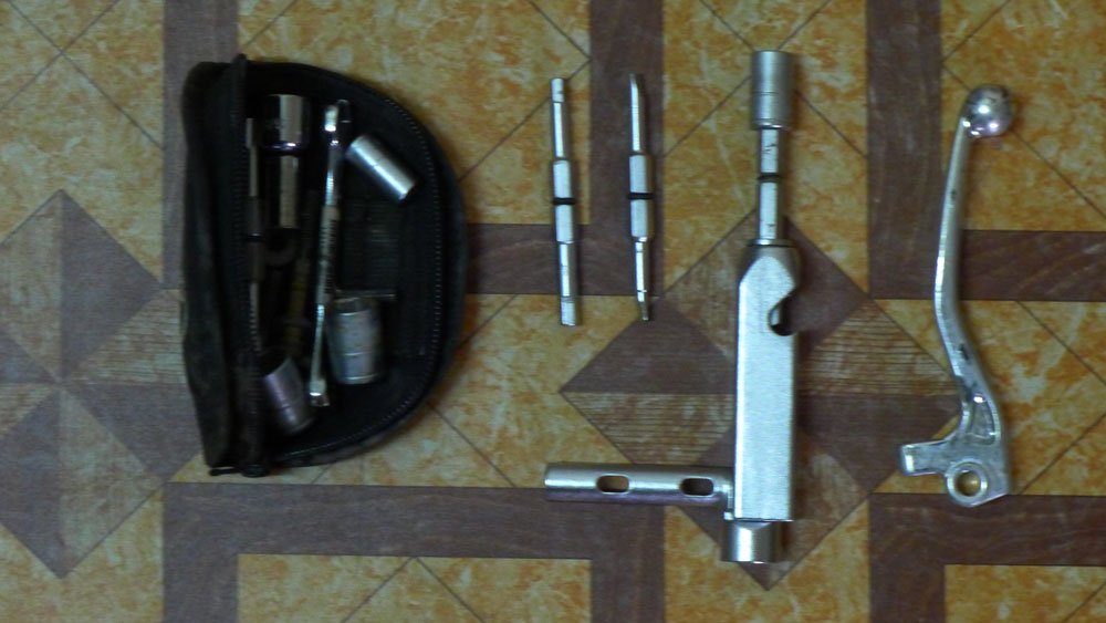

I build a tool kit custom for each bike. Then, I build it up or trim it down for the planned ride and bike to be used. How long? Where to? Company or solo? How remote?
This kit has evolved a lot since this shot. My tire irons are stowed in bash plate, and tow rope stashed inside side panel. I also carry at least two spare tubes.
Not shown is an extensive nut and bolt kit. Essential.

I can see the MotionPro Toolkit being a useful addition post the weld job. Was it MIG welded ?
For larger higher torque bolts your MotionPro 3/8 square drive adapter that fits the tire spoon looks interesting
KTMPhils toolkit.JPG (couldn't get pic to display in post ??)
Is the adapter a good fit in the MP tire iron or does it wobble about ?
Not sure what was used to weld it, the components are an excellent fit, no play at all.

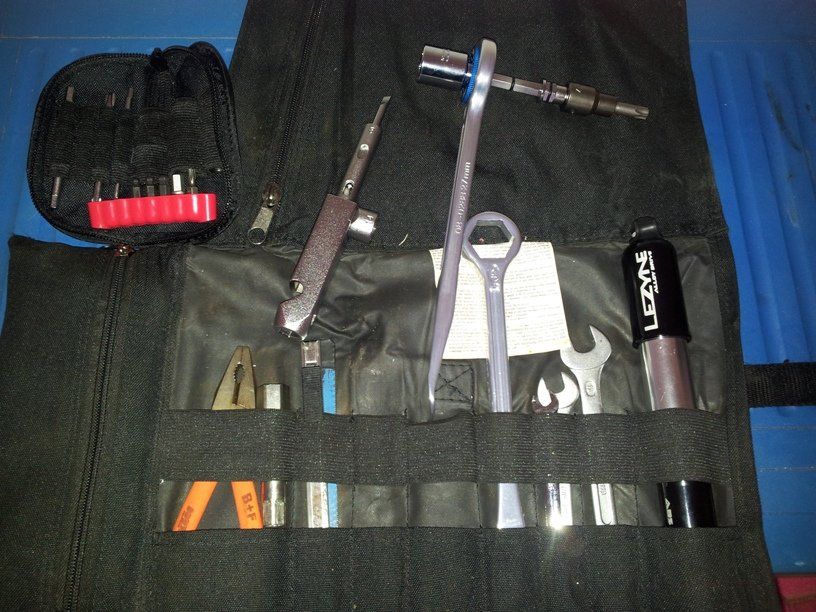

I've added the Motion Pro Metric Toolkit, Alu Tire Levers, and 3/8 Squ Drive Adapter to my toolkit.
Really impressed with how light the tire levers are.
With the 3/8 squ drive adapter the tire levers can be utilised for various high torque bolts

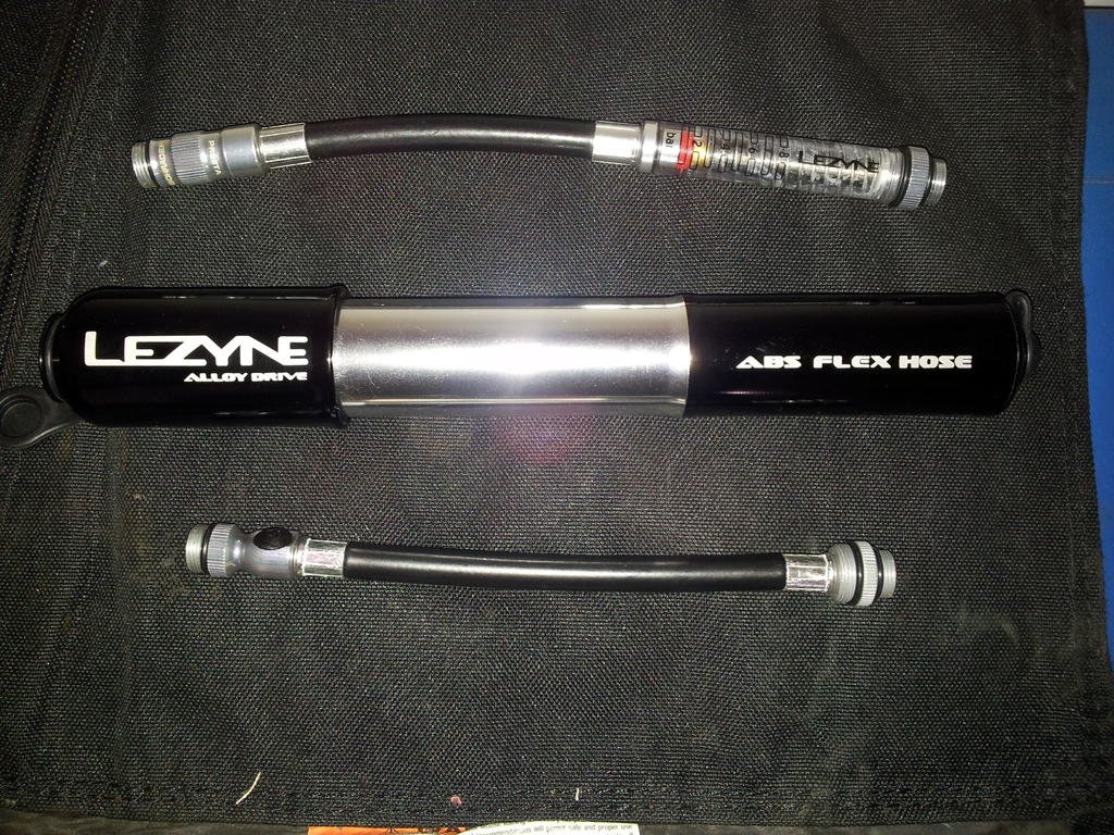

Also got a Lezyne Aluminium Tire Pump, advertised as high volume/medium pressure. Appears to be well made.
It took 80 strokes to inflate a front 21" tire from flat to 15psi.
The pump comes with a hose that stores inside the inner pump shaft. One end fits Schrader and the other end Presta valves.
The other hose in the pic is an optional replacement for the standard hose and has an inline pressure gauge. Nice concept but it only starts reading at 20psi so no good for dirt bikes running low pressures.

- Motion Pro socket kit with hex and screwdriver tools (this great set can get to every bolt head on the bike)
- Self amalgamating tape (or electrical tape) (fix split hoses, electrical jury rigging etc....)
- Spare fuses (stupid to get stuck for the sake of a fuse)
- Electrical wire ties (never go anywhere without them. Can be used to splint a broken frame with a piece of wood or a tool, hold anything back together easily)
- Monel seizing wire (jury rig cable ends, it is incredibly malleable in intricate uses. Good strength for holding things together and not sensitive to heat which electrical cable ties are, loose exhaust for instance)
- 21" front inner tube (can be used in the rear too)
- Super Glue (patching everything)
- Tow rope
4 extra's to consider are:
- 2 part epoxy (can fix engine cases, fuel tanks and radiators)
- Spark plug
- Tire irons
- Pump
Remember, this is playing the probabilities game of problems and what is prudent on that basis

Phil, Justin, are you guys still using the MP toolkit on trail rides ?
Any problems since welding the adaptor ?
Would you buy one again ?
Yes Bill once I had the driver welded I have been using it on the trail and in the workshop on the bikes as a permanent fixture with no issues. Shame you need to have it welded for reliability.
I outfitted mine with sockets: 6,8,10,12, and a strange size 13 (for the KTM), 3-6 mm hex bits and screwdriver bits all from Motion Pro except the 6 &13 mm sockets. I also added a 3" wobble driver for extra reach (radiator to frame bolts). I do however keep my standard L shaped hex wrenches to access a few spots that I found the larger girth of the Motion Pro tool awkward to access.

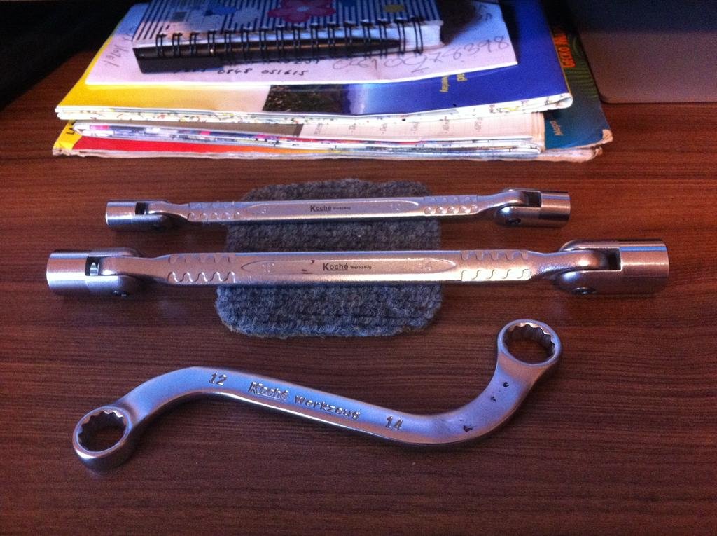

One thing I'm currently trying are Stubby wrenches to save a bit more space. I wrap the wrenches with an inner tube rubber band to the Motion Pro kit and it all goes into a Ziploc bag in my Camelbak.

Yeah, I think its 6 of one or half dozen of the other whether you put together your own minimalist toolkit or get the MP kit.
Just added these to my off road kit.
Great information here.Tank is a decent shop but another good place for outdoor kit in Bangkok is the Thailand Outdoor Shop GPS is 13.773233,100.596868Pretty good range of gear including Hennesey hammocks and other brands for those that are interested.
Now very wary of the Motion Pro ring spanner/ wrench, tire lever tool. Without excessive force and no cheater/ extender bar the 32mm version snapped trying to loosen the back wheel nut on a KTM 990 in China. Seeing this is something you wouldnt be bringing a spare of & how important it is, ill be bringing a quality ring spanner in future
Bring a spare - the ability to get the wheels off can be pretty important
Looks like a casting rather than a forging?? Also why in the critical area reduce material?
