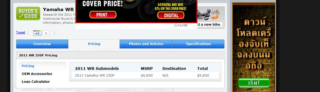

KTMphil said:I'm now seriously considering buying a new Yamaha WR 250F from the USA
USA list price $6,870 (205,000 Thai Bht). say USD$ 1,000 to get it to Thailand, 12,000 bht 3% excise tax and you have a new reliable superlight powerbomb for trail riding
http://www.motorcyclistonline.com/2011/ ... index.html
[attachment=0:qk0wlykk]wr250 new price.jpg[/attachment:qk0wlykk]
Wet weight 116KG - a couple of quick mods and a slip on exhaust and you have an easy 35HP is what attracts me
