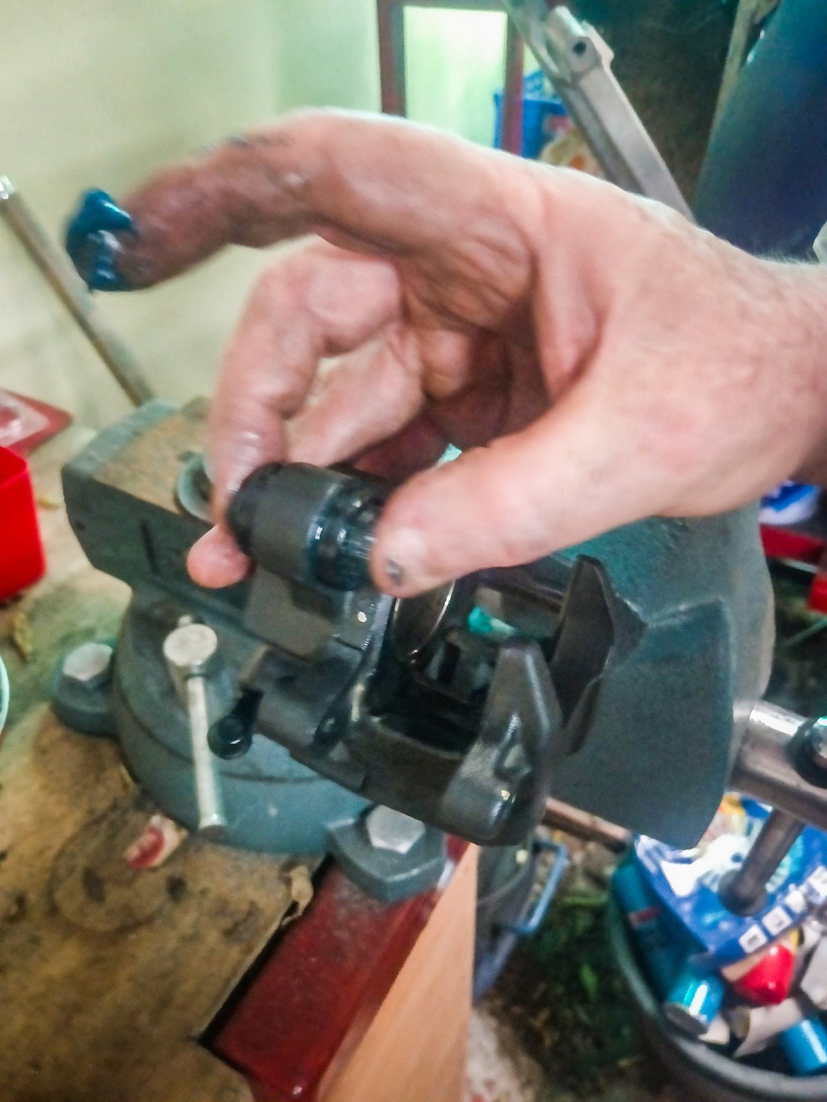

What I don't like about the video, is them showing us to force the pistons back. Those pistons are dirty - and if you do that, you're forcing that dirty piston back through your caliper seal - and that ain't good for it. It's good for spare parts sales.... but not for your wallet. What we do is remove the caliper, blow the piston out with compressed air (with a block of wood used to stop it shooting out at high speed).... and clean things up in a tub of hot water with washing powder. Clean it all off, check the seals (remove them and clean out any dirt behind them), lubricate the seals and pistons with brake fluid, grease the pins with high temp grease and put it all back together.
Bleed 'em up, check / replace fluids and away you go - remembering to do a test application before rocketing off down the road.
