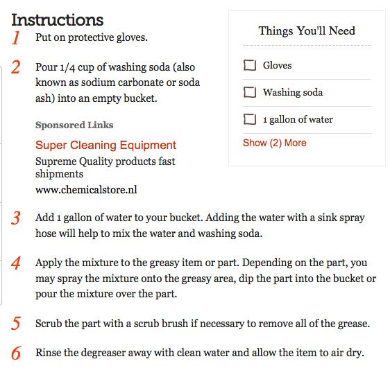

How to clean your airfilter
Found these useful how to's regarding degreasers
http://www.doityourself.com/stry/how-to ... -degreaser
And here is another
http://www.ehow.com/how_6117746_make-ow ... easer.html
Fascinating.
Brilliant!
