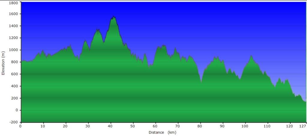

This is a screen grab from a section of the Sangkhlaburi - Umphang trip that I did recently with KTMPhil and BSABob
I know it was steep in places... but this steep?
Guessing its GPS inaccuracy showing up..
Does the montana have a barometric altimeter like the 60csx ones ??
I wasn't aware of that.... so I just checked, and yes... its barometric. I wasn't breathing on it.... honest.

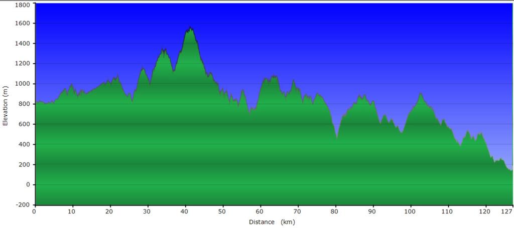

This is the elevation data recording from a Garmin Montana of a long long link up we did a few days ago in the Omkoi region, quite interesting
Makes you wonder how much traction you'd be getting @ 74%? that's getting right up near vertical.
Sounds a little out to me but of course some small section can be quite steep.

As for the OP's question about accuracy of the (GPS-based) elevation-data, well that is always the weakest part of any GPS-position, simply due to the geometry of the satellites. Normally the error on the elevation will be 1.5-2 times the horizontal error. This can of course be exacerbated by both periods of high DOPs (DOP = Dilution Of Precision) due to poor satellite geometry, poor reception (and thus again high DOPs) due to topography as well as inclement space weather (solar flares).
