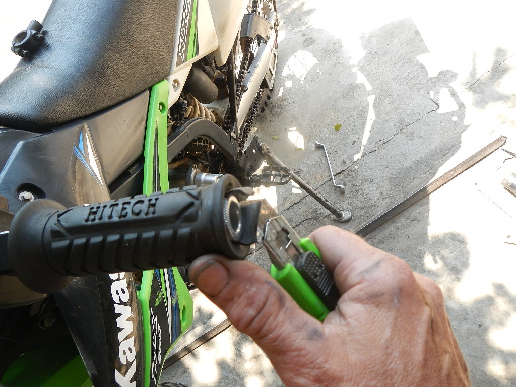

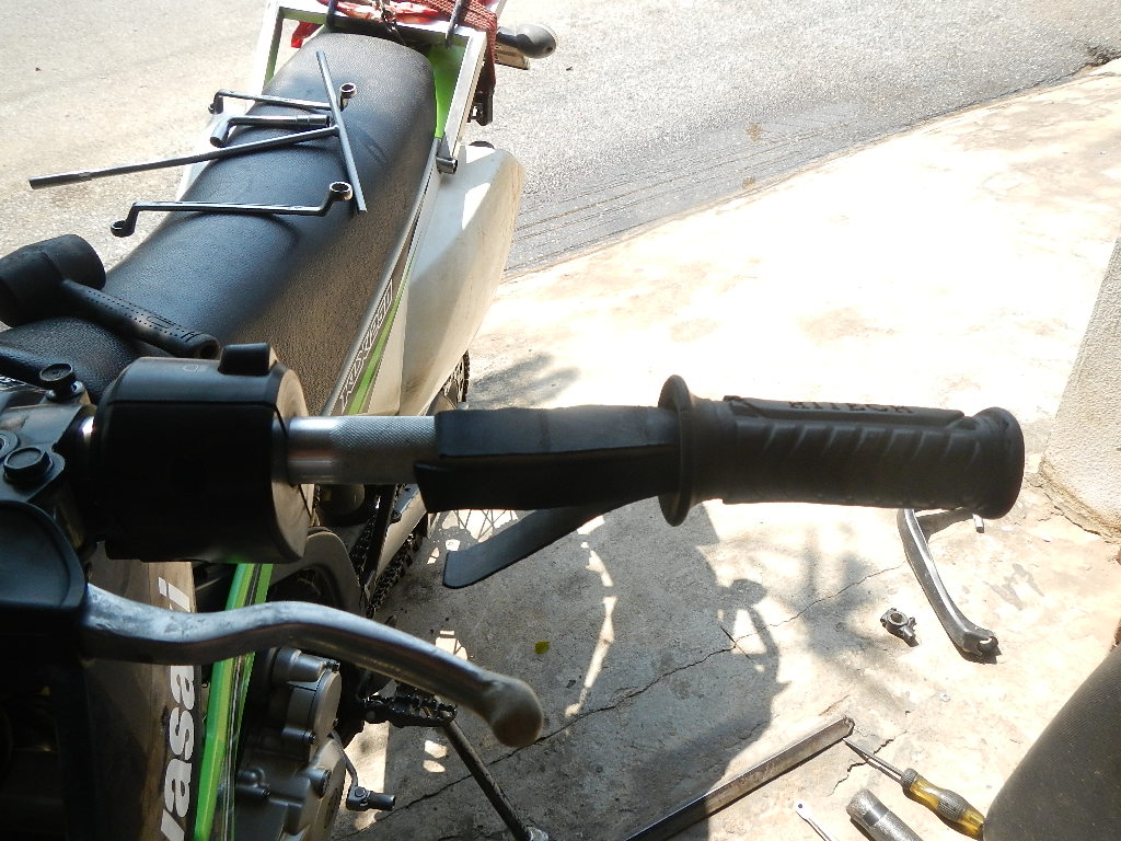

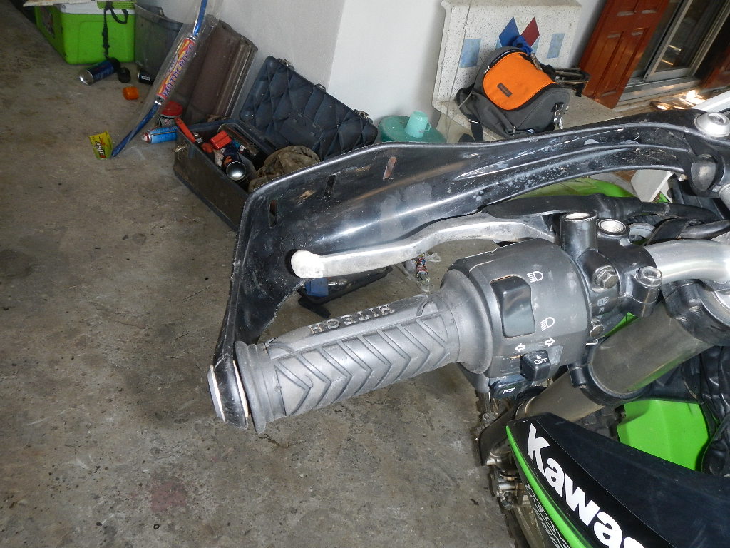

Since eternity I try to find a reliable solution for moving grips at the handlebar. Glue, double tape, wire? Does not work really good. My solution is cheap and work.

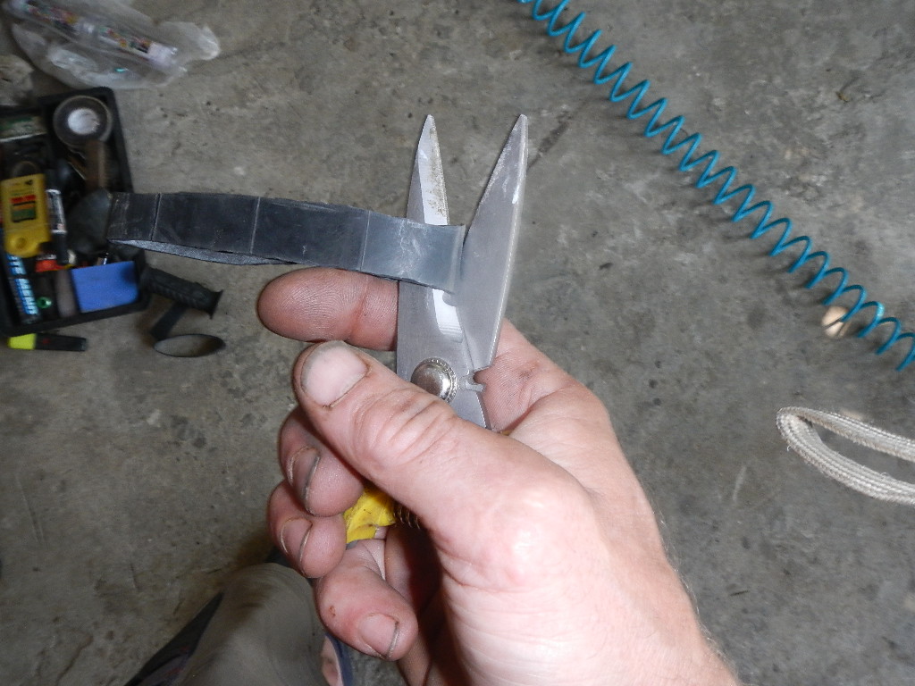

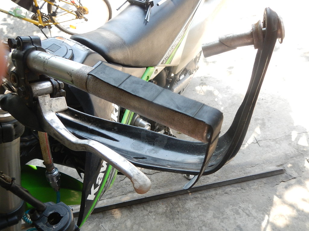

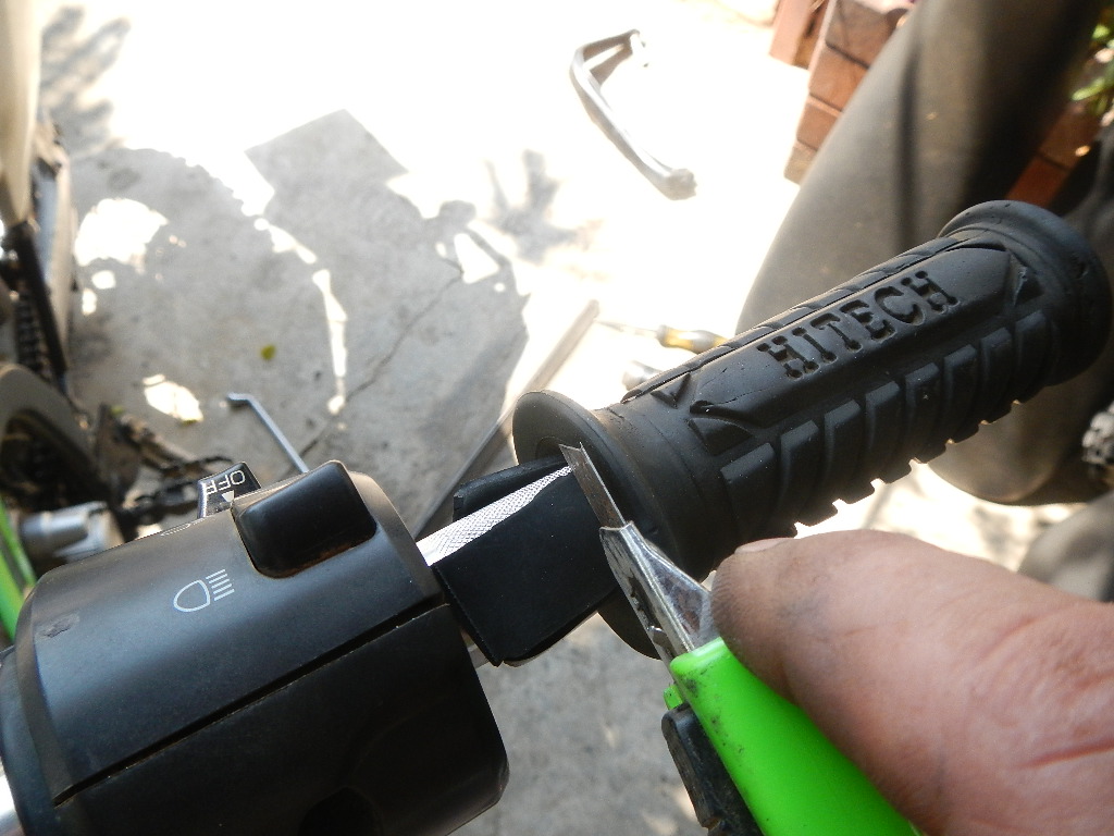

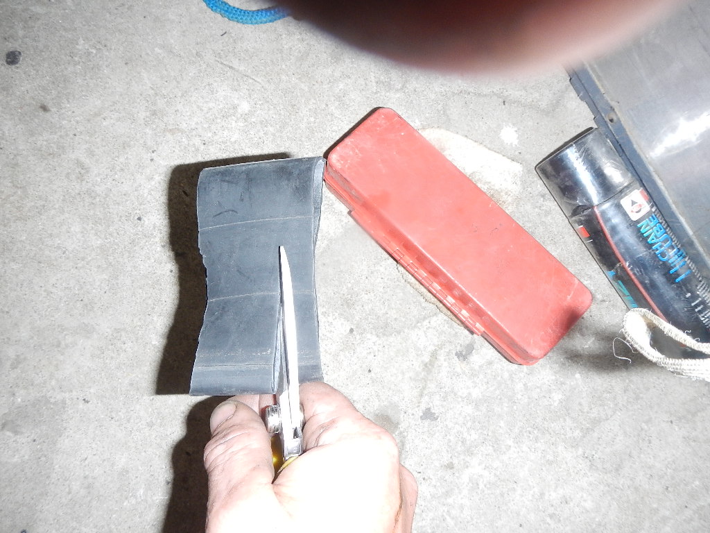

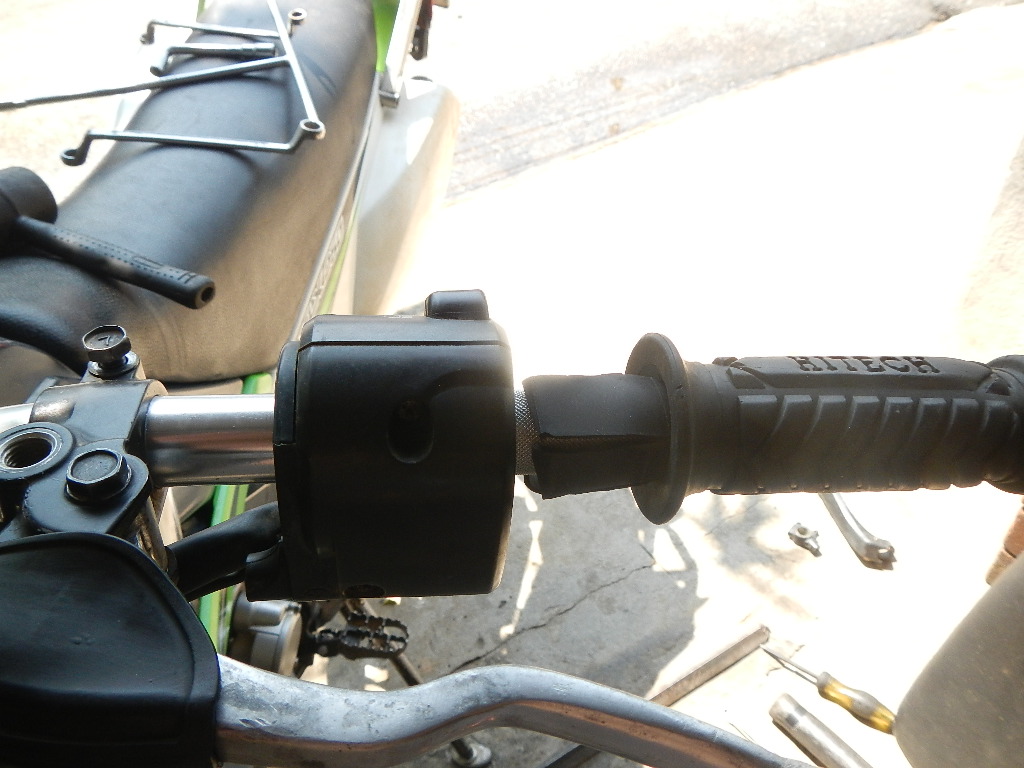

A old innertube cut in stripes. In normal cases 1 is enough, but also 2 are possible. Stripes about 1cm. Open the rubberring at the end and install it at the end of the hand. If nessary, the 2nd turned 90°, push the grip tightly with air or rubberhammer over it. Cut the ends, finish. Off course the grip is now a little bit bigger, what I like. But I guess there are people with smaller hands, whose have problems with it.
See the oics below.
