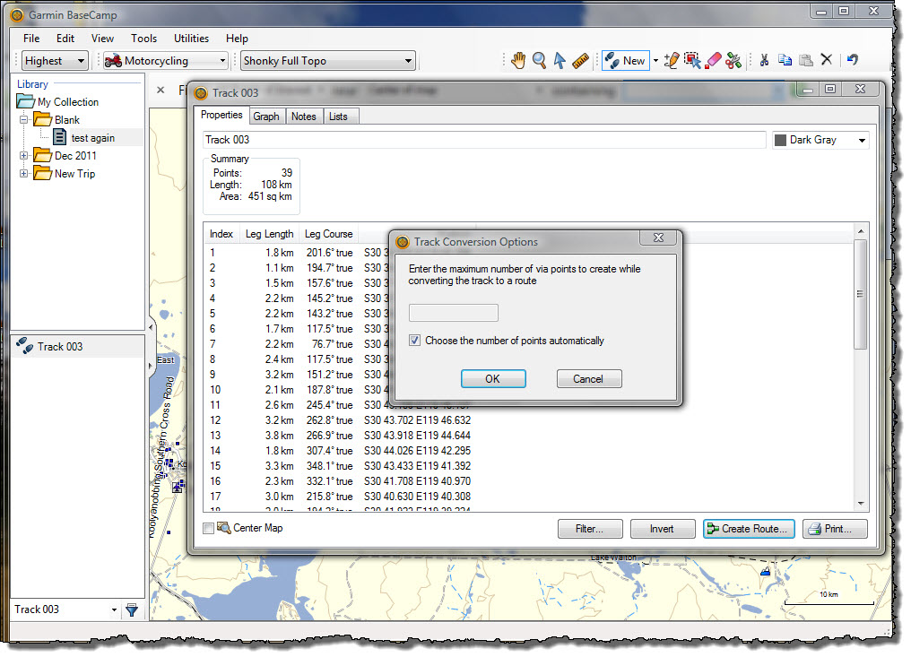

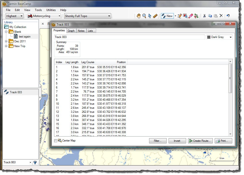

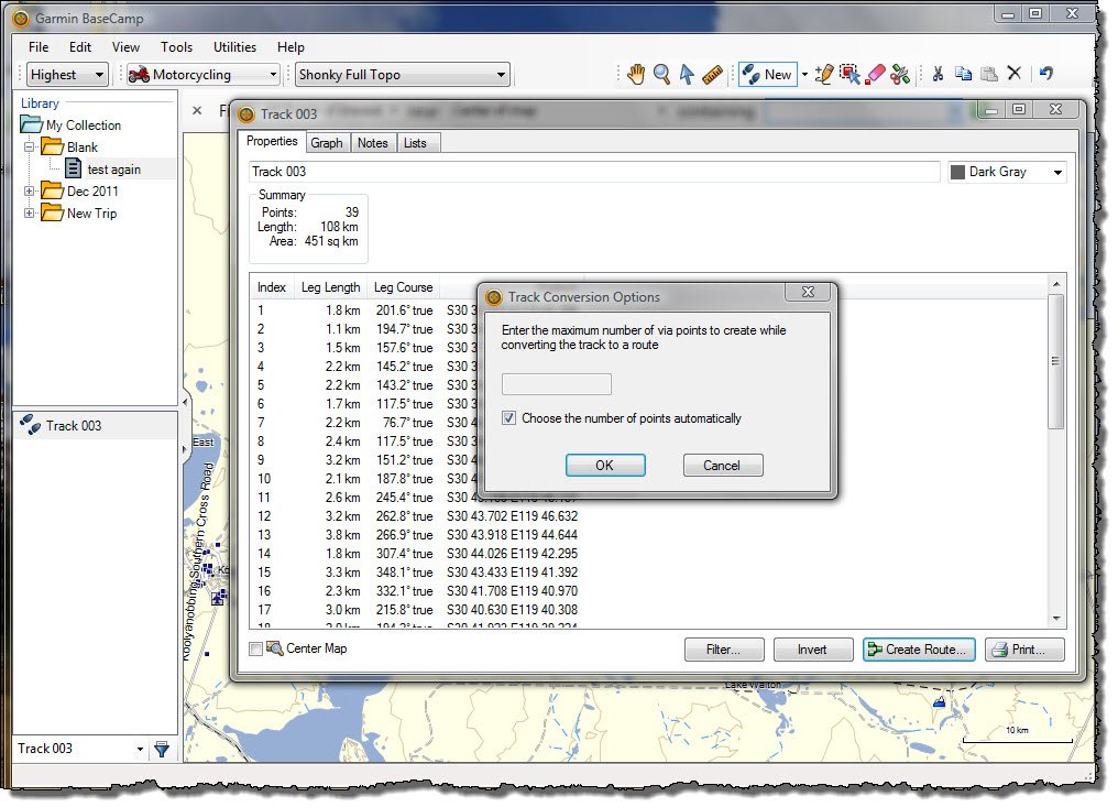

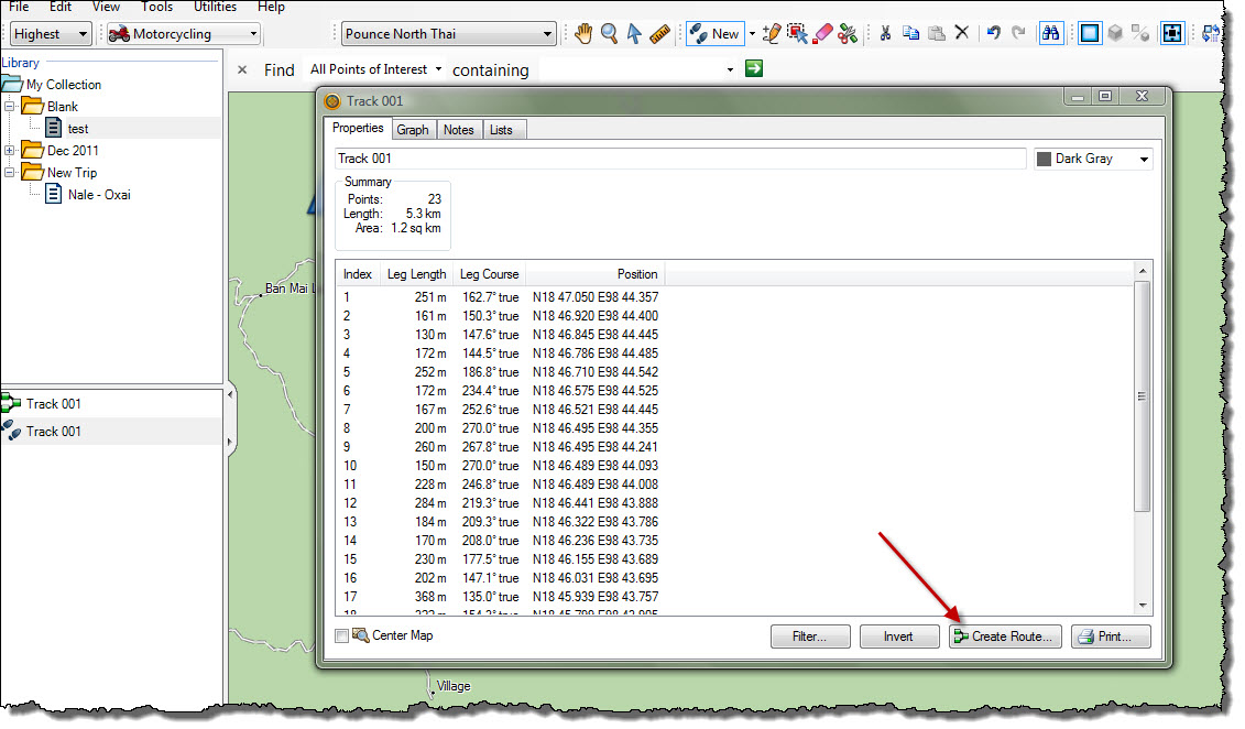

Right click on the track in the bottom left pane.
Properties.
Then you should get this.
Properties.
Let me see you doing that with a track you've drawn with the "Track Tool" which is not near any roads or trails etc. Do your properties and create route thang and post up the resulting screen shot?

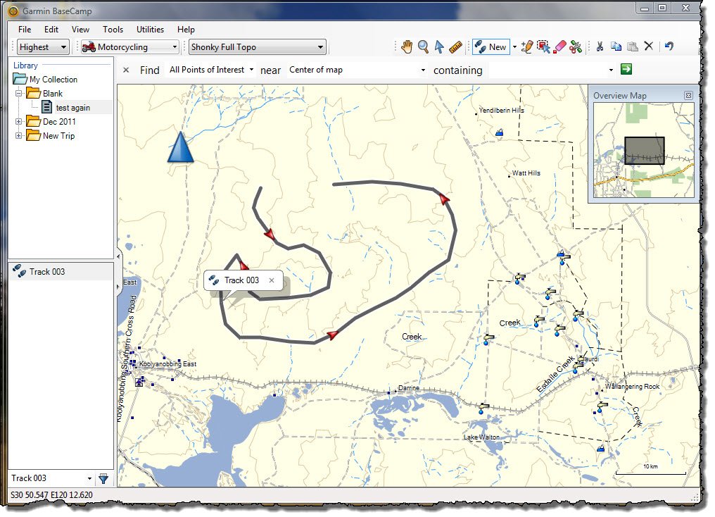

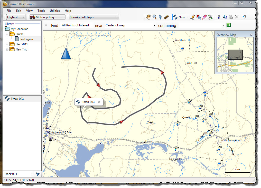

Ok. Hand drawn track.
As you can see, it's in between roads, railways & rivers.
This track wasn't connected to any existing roads or such on the map.11-04-2012 11-52-04 AM.jpg
Ive just installed Basecamp onto a Windows partition and tried the steps you've provided and yes it works on a PC as it should using it in "Dirt Biking" activity mode.

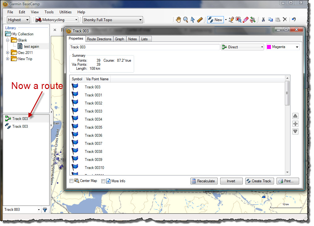

Now I tried again with my Mac version of Basecamp, this time I had Direct Routing selected:
Here's the two points I want to join with the track tool.
Here's the hand drawn track
Right click on the track on the left and select Create Route from Track

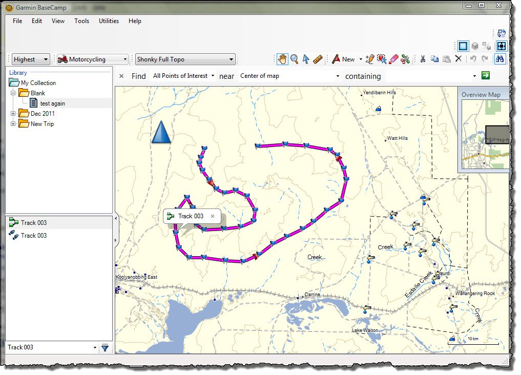

Away it went and it worked!
Here's the finished route from a track.
Now I tried this earlier and I have no idea why its working now!
The Mac version will only do this in "Direct Routing" mode where the PC version will work with other activity setting (The one I tried on the PC was Dirt Biking)
