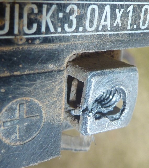

I went for a spin up Doi Suthep road as I had my road wheels on.
When I got down I wanted to do it again, so up II went but it started hesitating, missing a beat, which was worrying going round corners between songthaews
Then it cut out completely before I was halfway up.
I had a total electrical failure
I checked (almost) all the connexions and fuses to no avail, so rolled all the way down to the zoo
Then I checked to find the battery lead was loose. so I got home ok
Once I got at the battery lead, it looks like this
The battery is less than a year old, so I dont know how it got to be like that
