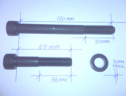

Owned two F800GS in the past and always a good very idea to replace the upper rear shock bolt on a F800GS as they tend to bend under heavy load and extensive off-roading, damaging / bending the frame can be very costly and troublesome.
The OEM bolt is a 10.9 and can be replaced with 12.9 for added strength and security... nuff said'....

Well ~ wouldn’t trust MIC = Made In China mystery metal and a reliable supplier web-links below… nuff said’…
Upper Bolt http://www.mcmaster.com/#91290a643/=xflpi3
Lower Bolt http://www.mcmaster.com/#91290a632/=xflq5h
Washer http://www.mcmaster.com/#94316a440/=xflql1
Above bolts should fit the F800GS 2015 model year as no changes were made to the shock mounting / frames (F800GS various generations).
The lower rear shock bolt is usually fine and doesn’t need replacing.

Well ~ wouldn't trust MIC = Made In China mystery metal and a reliable supplier web-links below… nuff said'…
Upper Bolt McMaster-Carr
Lower Bolt McMaster-Carr
Washer McMaster-Carr
The lower rear shock bolt is usually fine and doesn't need replacing.
