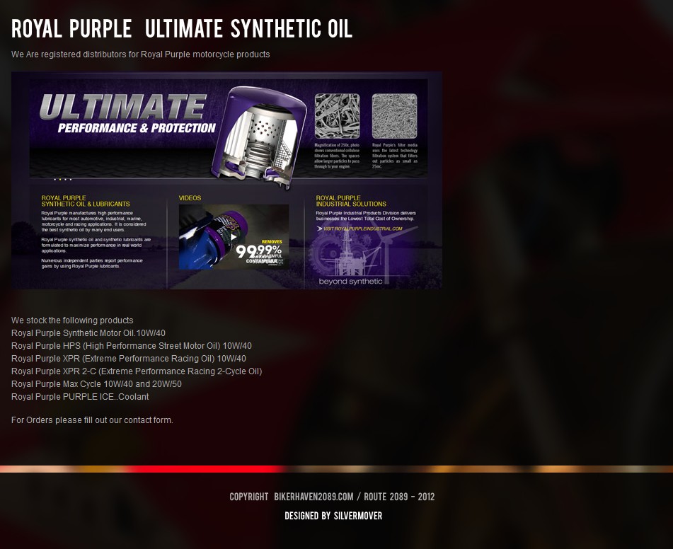

Many independent reviews say that the Royal Purple brand is one of the best engine oils around.
Ron, who owns the Bike Haven 2089 in Saraburi, is the Royal Purple engine oil importer in Asia, he can supply the following engine oils:
Royal Purple Synthetic Motor Oil.10W/40
Royal Purple HPS (High Performance Street Motor Oil) 10W/40
Royal Purple XPR (Extreme Performance Racing Oil) 10W/40
Royal Purple XPR 2-C (Extreme Performance Racing 2-Cycle Oil)
Royal Purple Max Cycle 10W/40 and 20W/50
Royal Purple PURPLE ICE..Coolant
His Royal Purple website:
http://bikerhaven2089.com/?page_id=802
