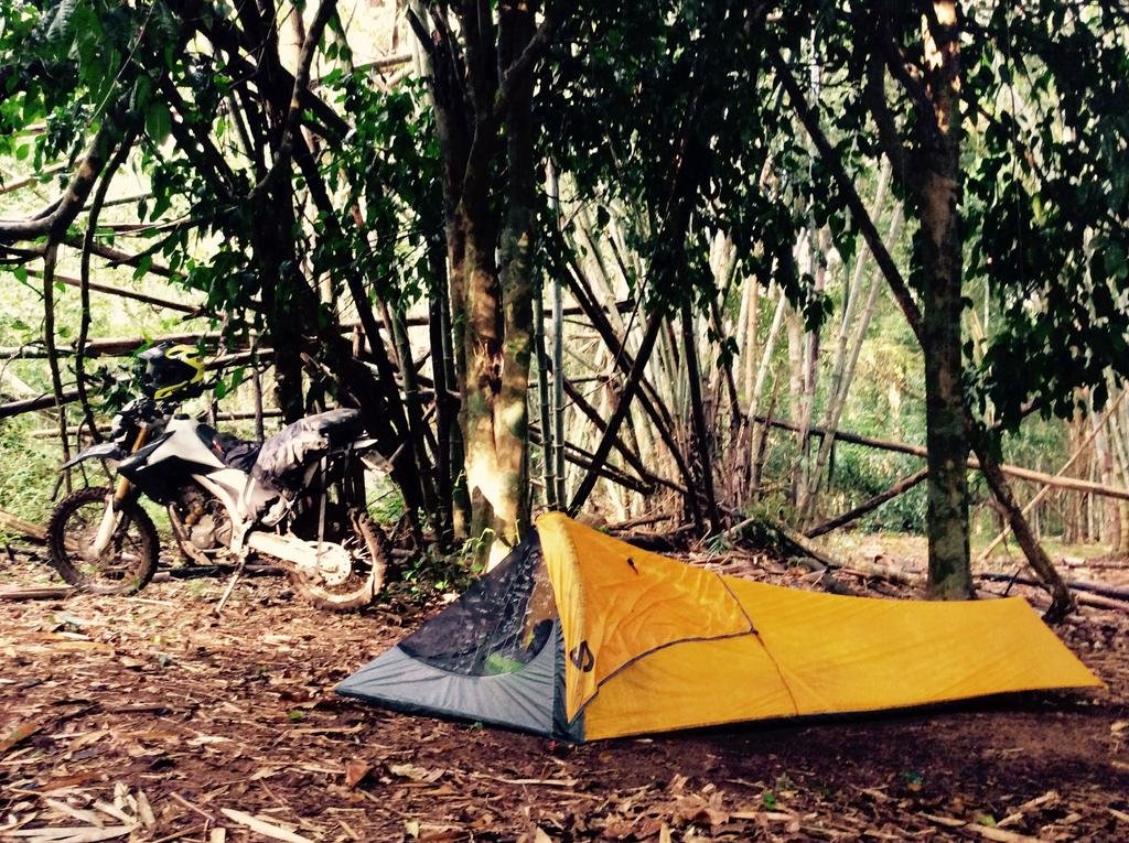

I've had a chance to use the GoGo Elite a few times now, including at Doi Ang Khang and in the Kanchanaburi jungle, so will offer my initial thoughts.

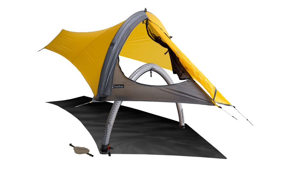

Firstly, this is a bivvy tent, not a tent. There's a difference. There are various bivvy tent models on the market. What sets this one apart is the airbeam, the light weight (750gm, total package, including stakes, air pump and puncture repair kit) and the price tag: it's expensive.

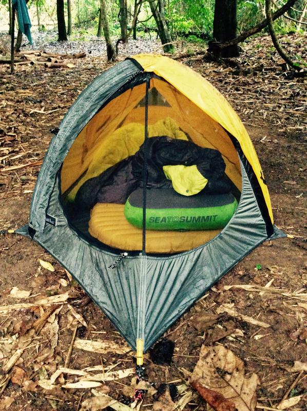

The GoGo is small to sleep in, offering really just a tube to lay in. You can store some items in the vestibule area but I prefer to just keep my valuables inside and move my mattress and pillow as far out as possible to give me more room and airflow from the mesh doors.
I now carry a light weight camping set with me on all trips; the sleeping equipment, which includes this bivvy tent, an MSR NeoAir Xlite sleeping mattress, an MSR Auriga blanket (both XL) and a Sea to Summit Aero Pillow Premium (L) has a combined weight of just 2kg. The tent appears well made throughout and the airbeam looks tough and is easy to use. I've swapped the supplied stakes with the stronger MSR Goundhog stakes.
