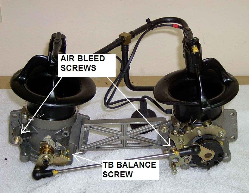

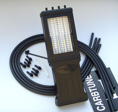

Just ordered a carb-tune thingy to balance my throttle bodies. After that resetting the TPS is on the list - manual indicates the use of the ridiculously priced DDS, there are other cheaper software options available I'm looking into now.
118041d1347588266-help-where-throttle-body-air-bleed-screws-throttle-body-air-bleed-screws.jpg
