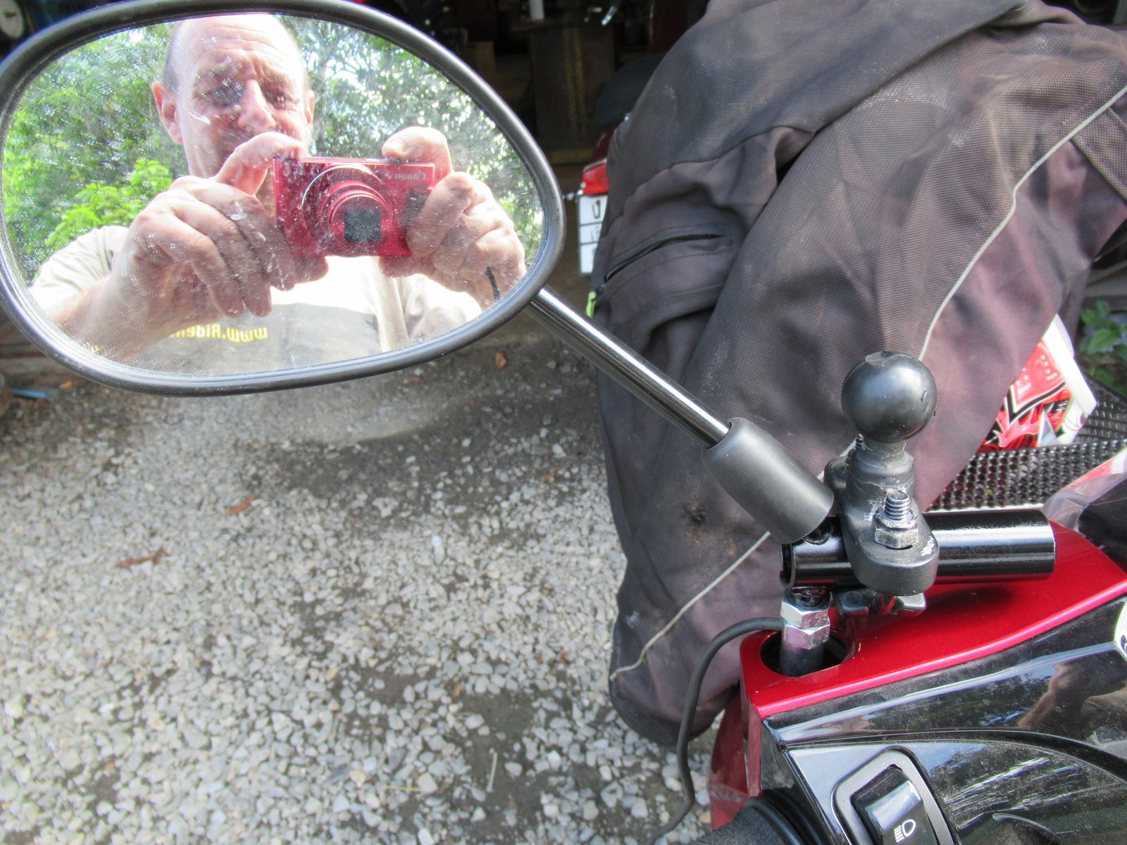

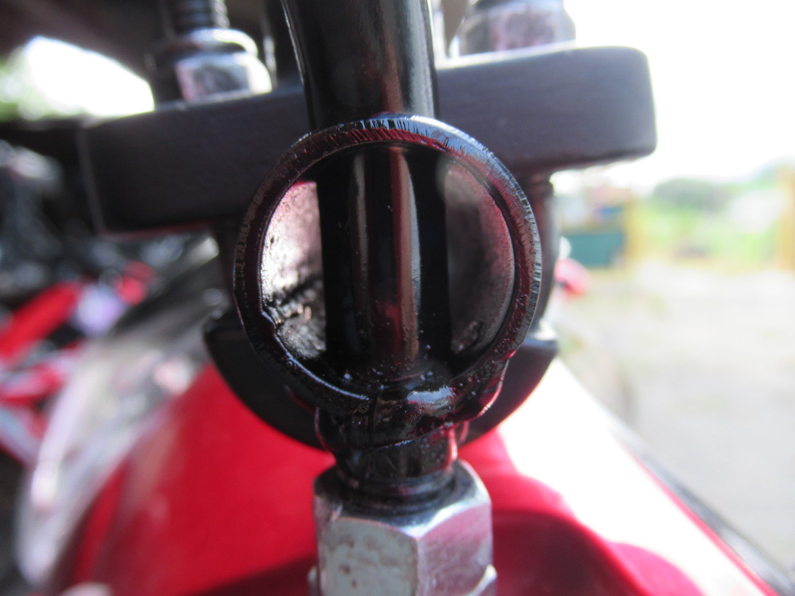

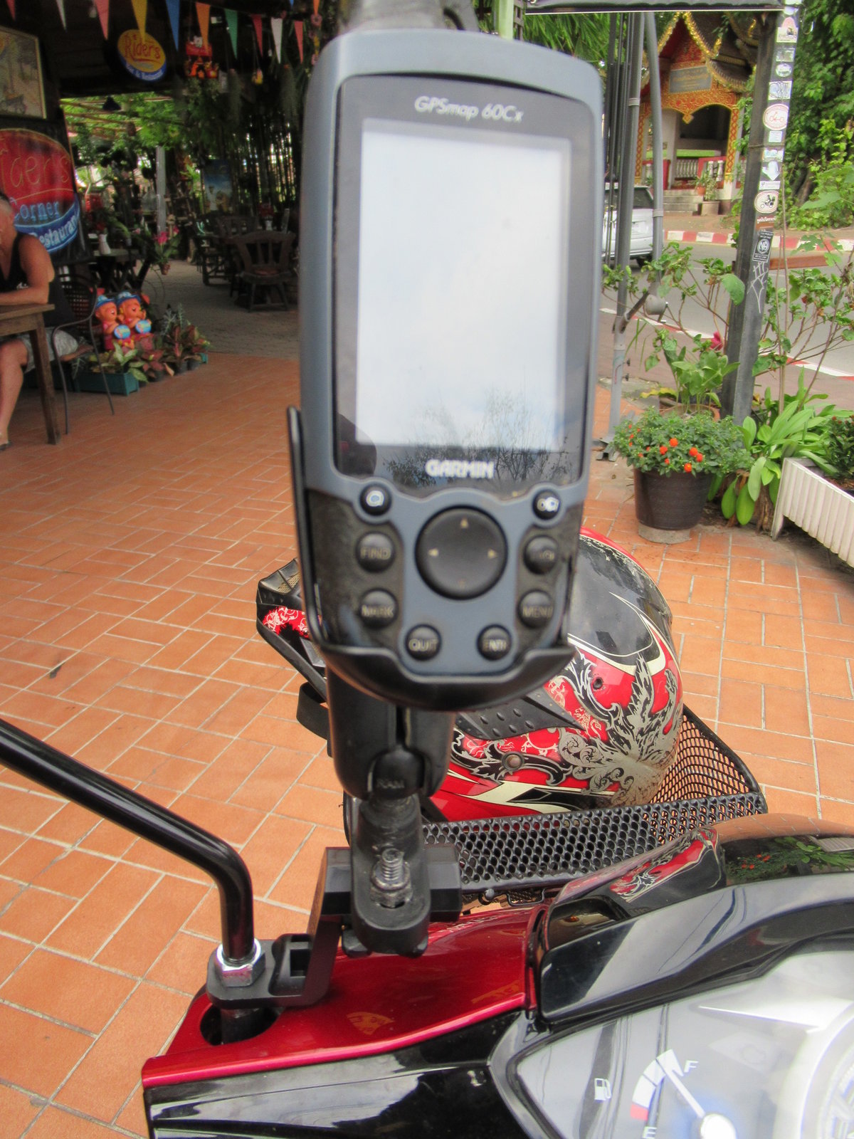

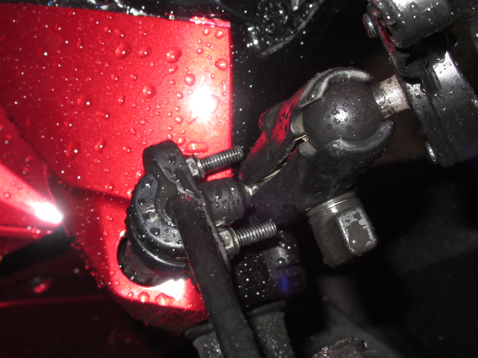

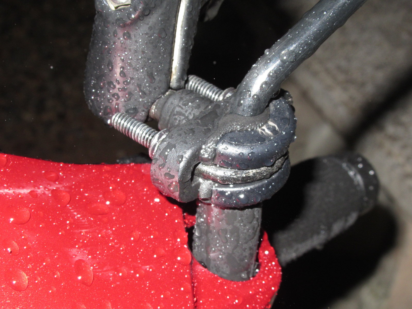

Mounting the GPS has been a pain, my first attempt was to use rubber from an old innertube wrapped around the mirror stem then tighten the Ram Mount clamp to it but it wobbled about far too much
This second attempt was by using a harder material to fill the gap as the Ram Mounts wont tighten up enough on a thin mirror stem and this was better but offroad riding meant hitting bumps resulted in the clamp moving around on the mirror

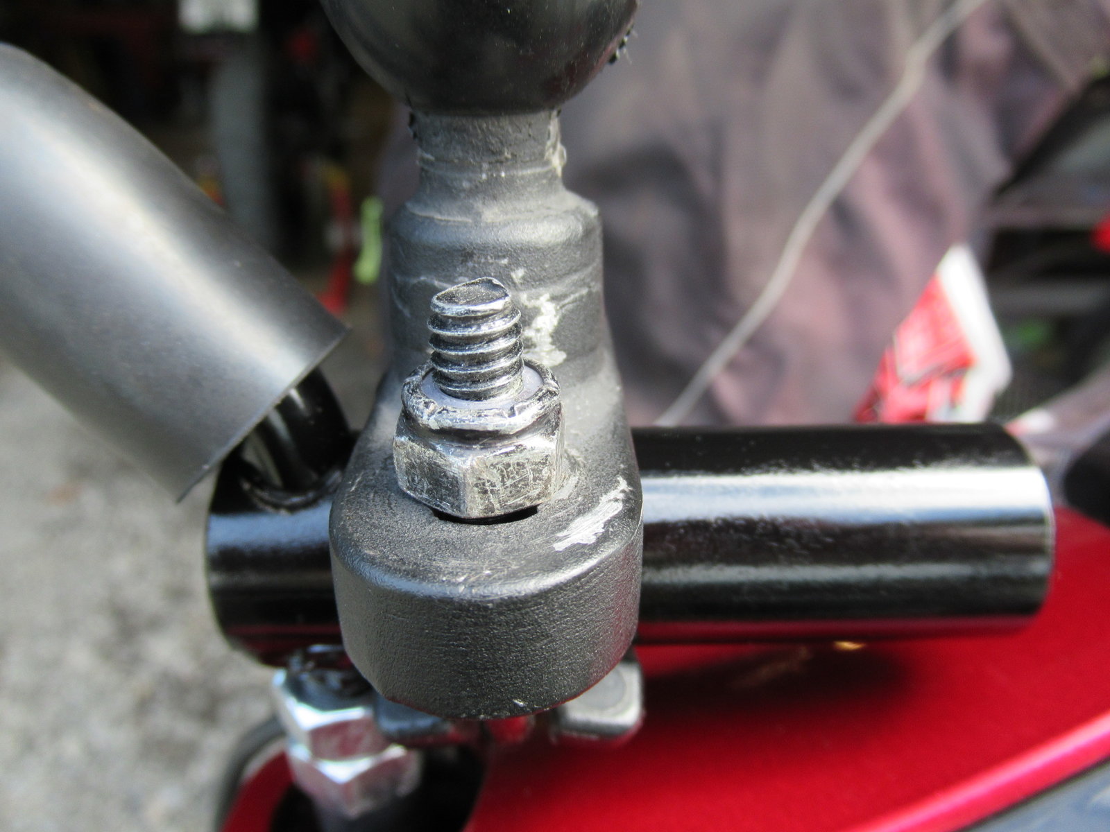

This was ordered from Lazada
Its not directly attached to the mirror which is good but these are not made from metal and it wobbles, I was concerned it would snap during offroad riding

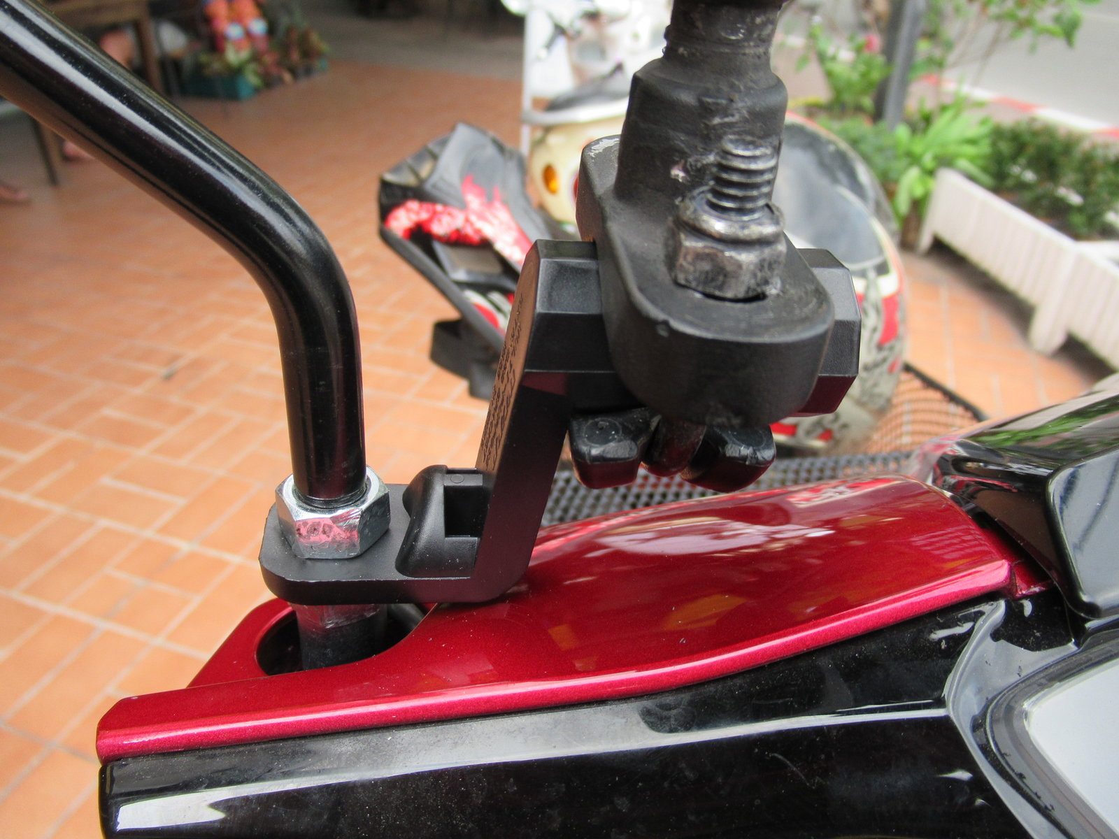

The final solution
Even if the weld comes loose it cant fall off as the mirror stem is inside it
Sadly the fact its now attached to the mirror again means there is a slight vibration but its not a problem

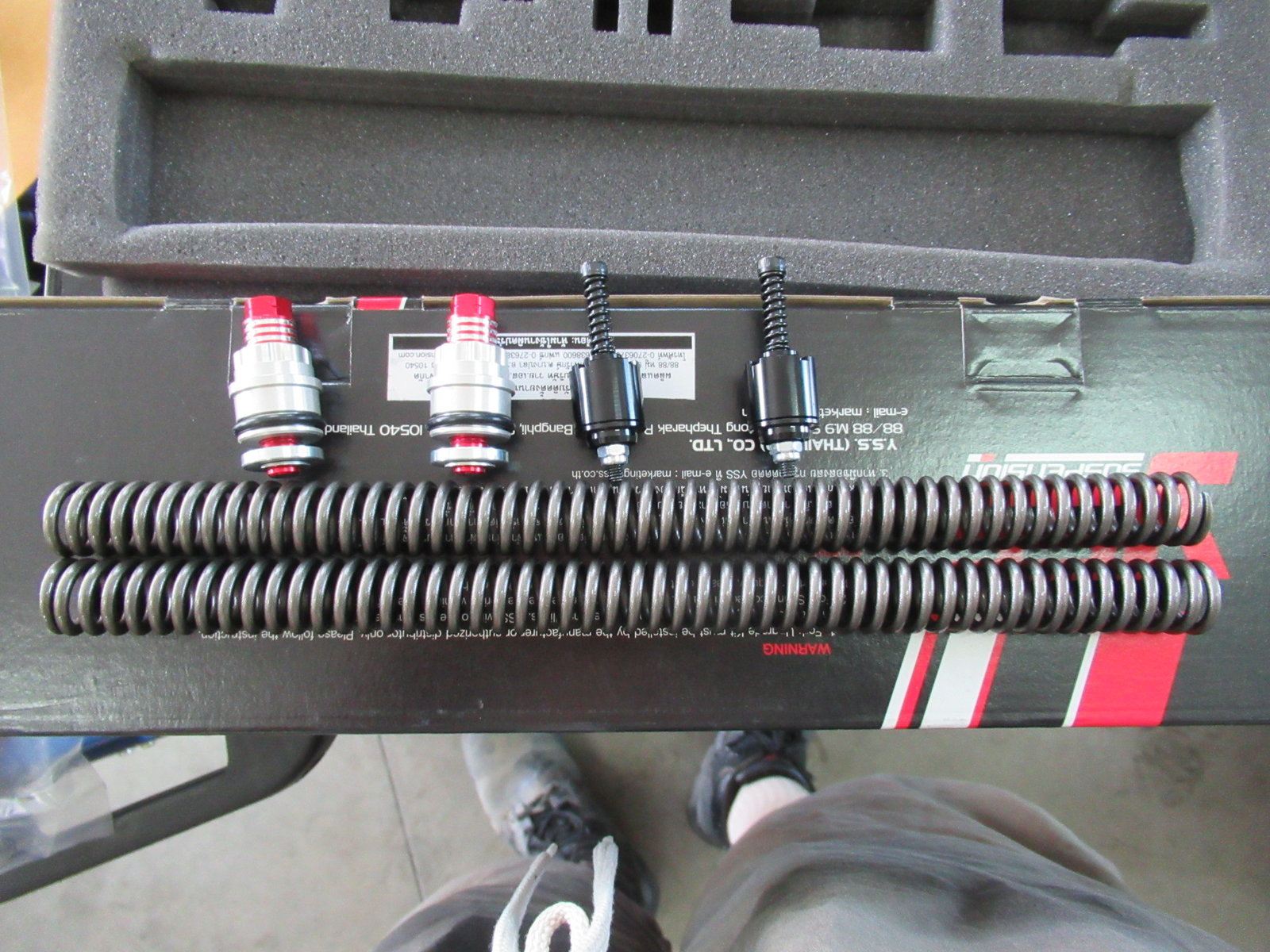

The front fork upgrade kit with valves to go in the bottom of the forks and adjustable preload at the top

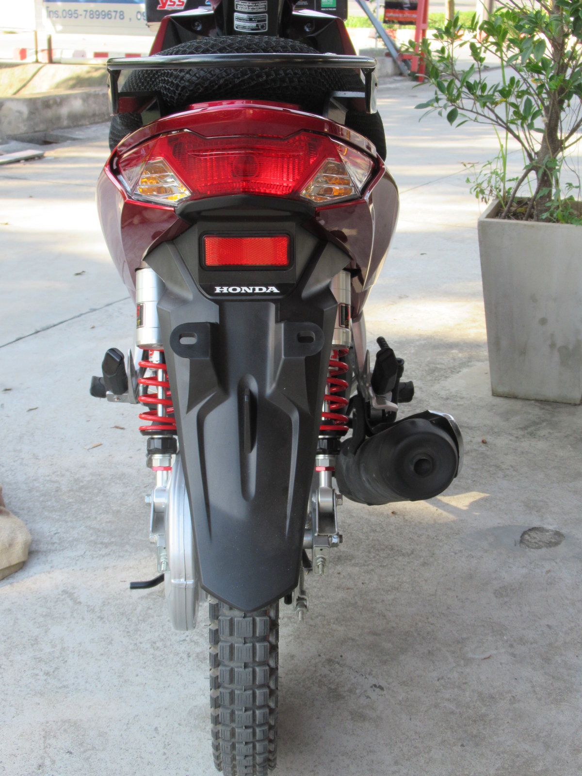

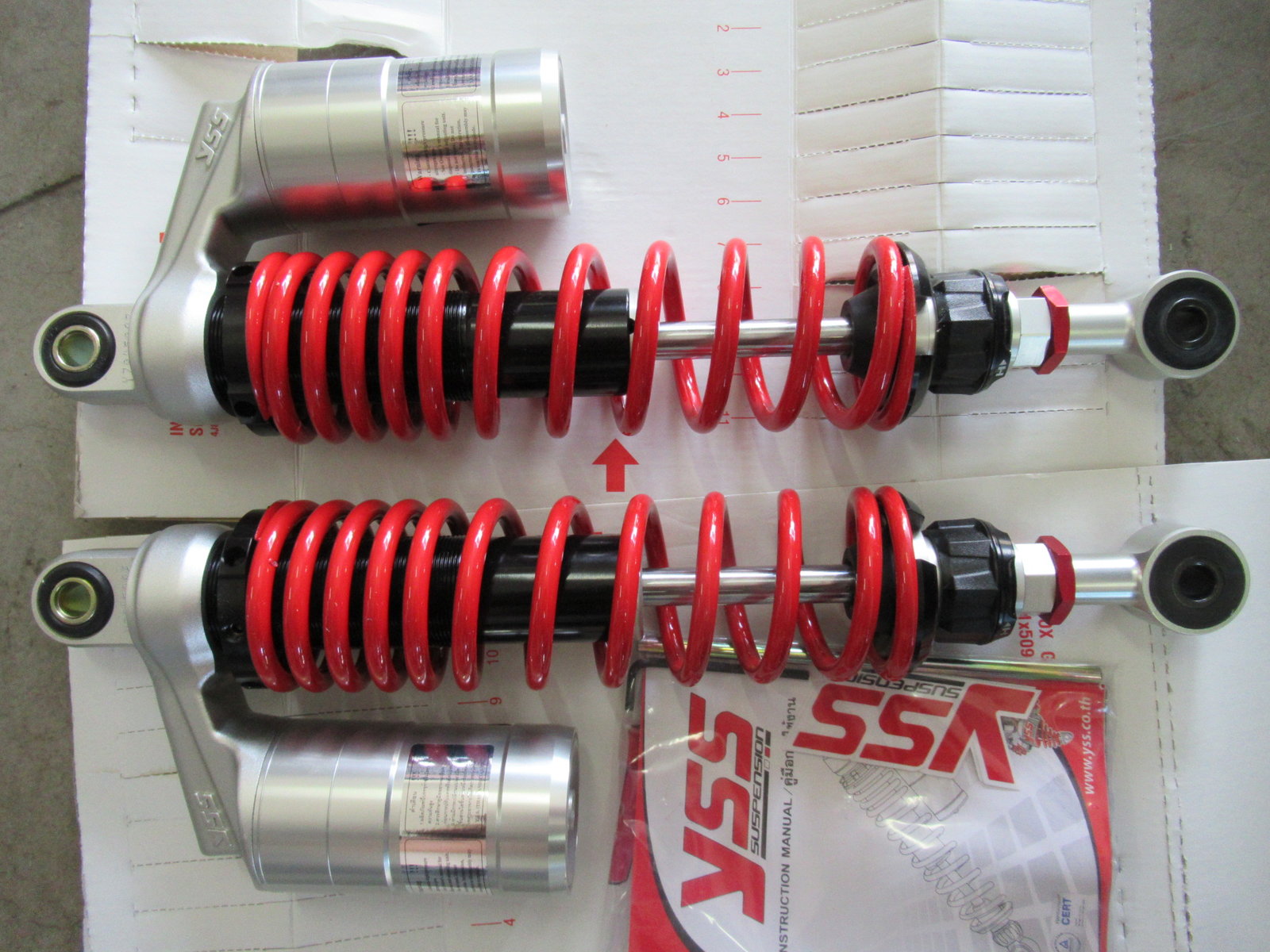

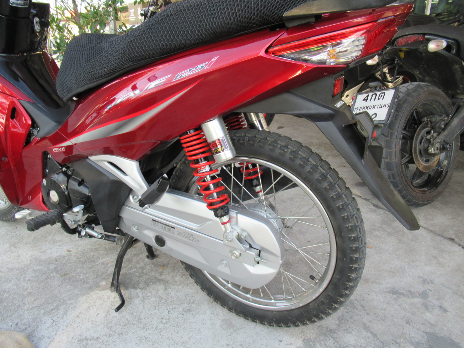

Preload and rebound adjustment on the rear shocks, these are 10mm longer than standard

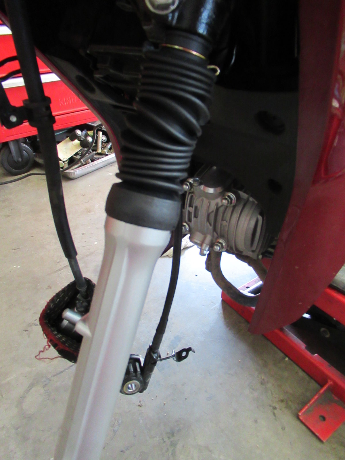

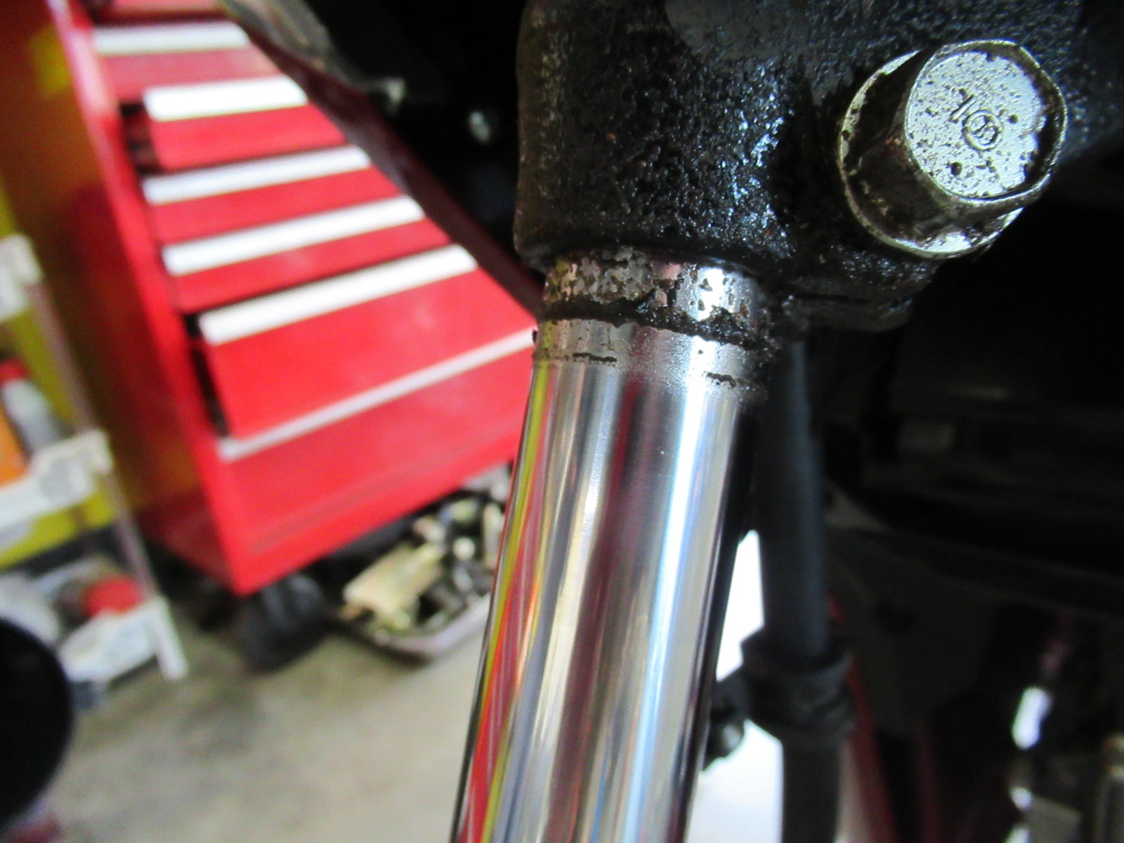

First problem, one of the fork seals has already blown, CMS dont have any so a trip to Sangchai Honda was needed to buy one

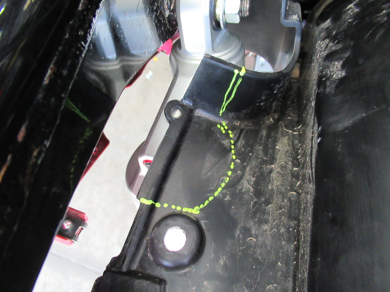

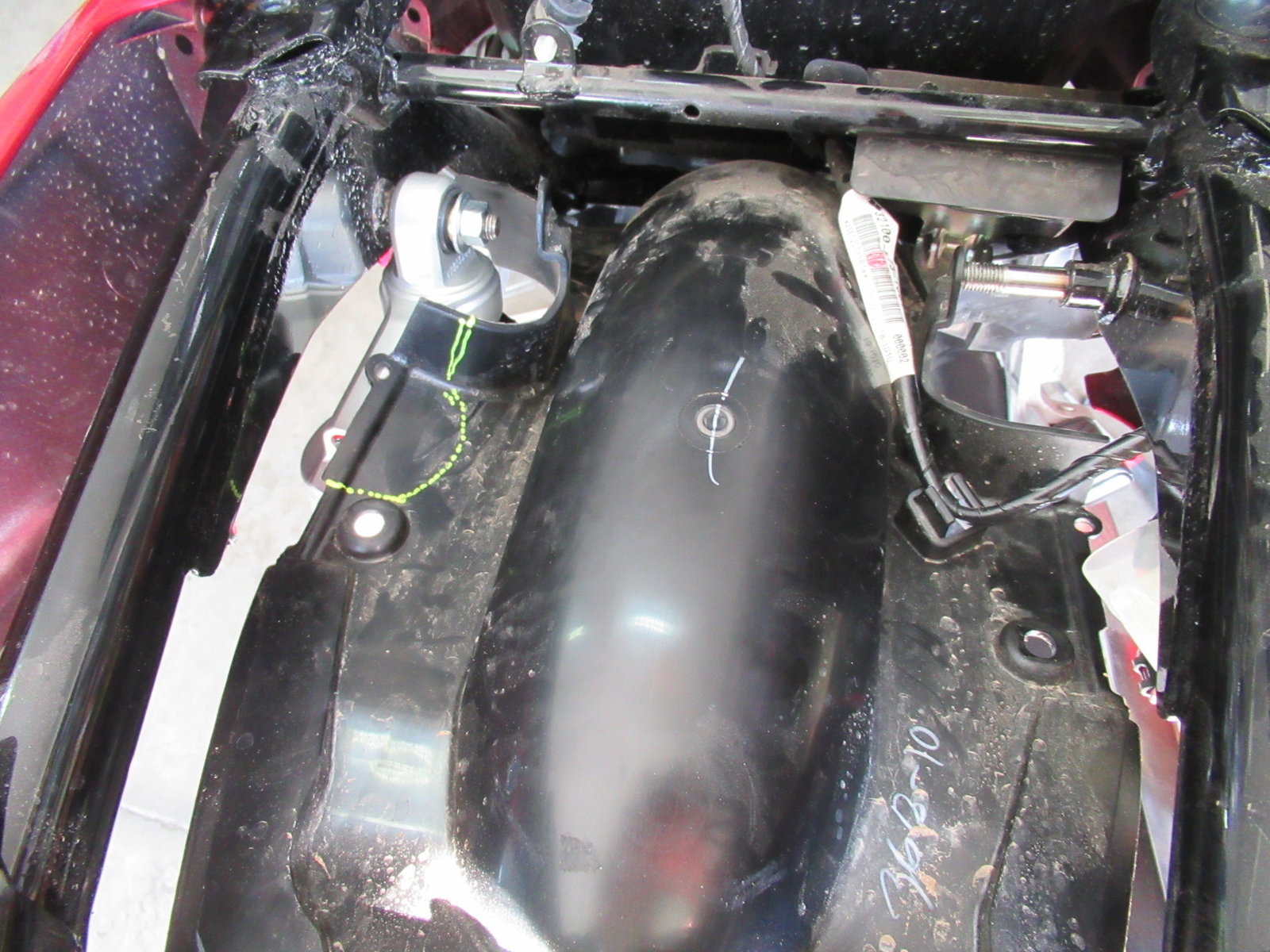

Problem number two is mine is a new model with a 5.4 litre fuel tank whereas the older ones were 3.8 litres and the back end is different, the rack from the old model doesnt fit it either. The plastic is sitting on the shock absorber gas reservoir so it needs cutting, my only concern was when they put the fuel tank back in that would also sit on the shock but thankfully it didn't

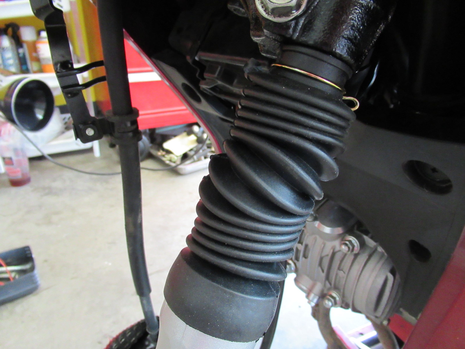

I bought a pair of fork gaiters and asked them to fit them for me, hopefully these will extend the life of the fork seals

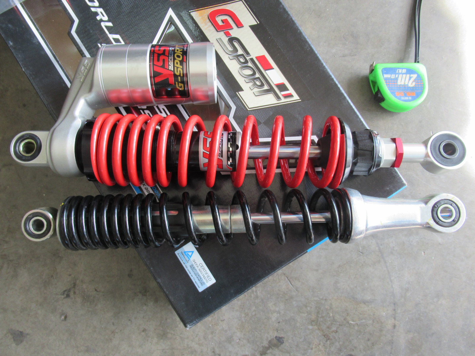

The YSS shock is about 1.5 times a wide as the original and the metal on the spring is much thicker too
The four options I had to choose from

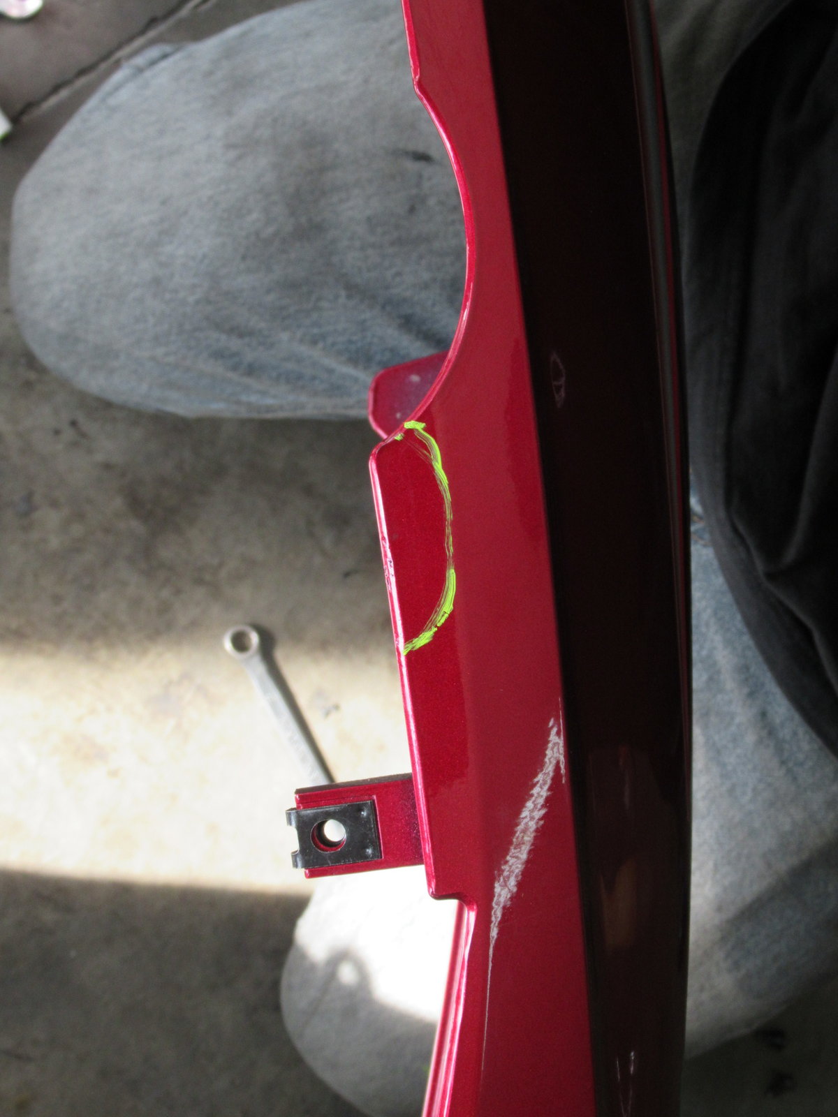

Next problem is the side panels also need cutting as they wont go back on because the new shock is much bigger

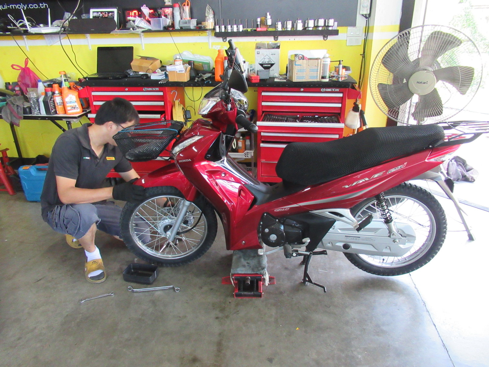

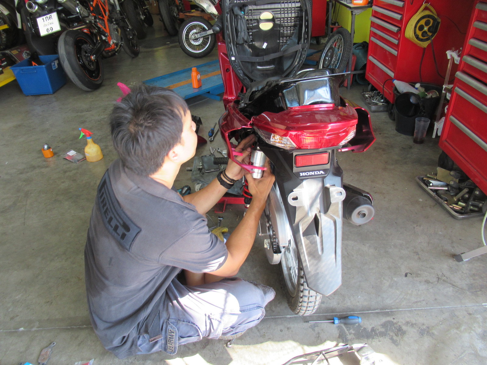

Finally its all finished and then its time for him to set it up for me, I asked him to set it up for 90 kg to allow for my riding gear and a bit of luggage
