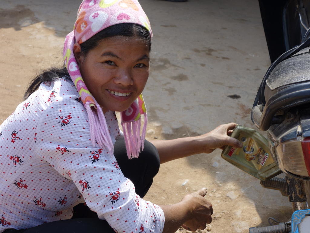

If you can't get hold of chainlube simply squirt old (or new) engine oil on the chain once a day or simply do what the locals do, ride up to a motorcycle repair place and ask for an old oil can and dribble the dregs onto your chain, like this.....
