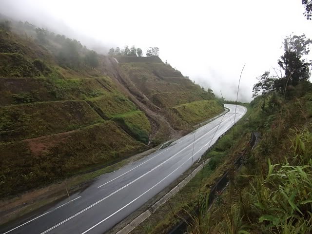

I am really enjoying riding down the A181 and its finally stopped raining, I was toying with the idea of going in the opposite direction and riding to Gua Musang but its a fair way and I am already wet so it can wait for another day
The A181 is a brilliant fun road

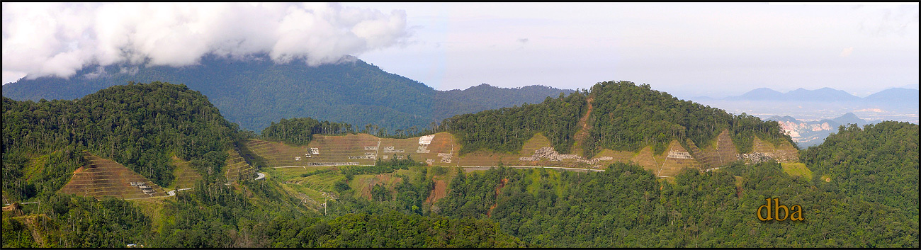

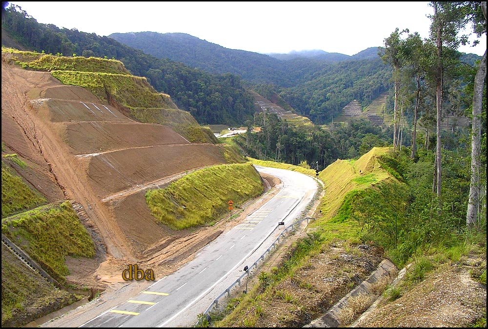

panorama of lower sections,Ipoh in the valley to far right
heading west approaching landslide area

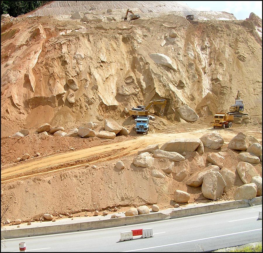

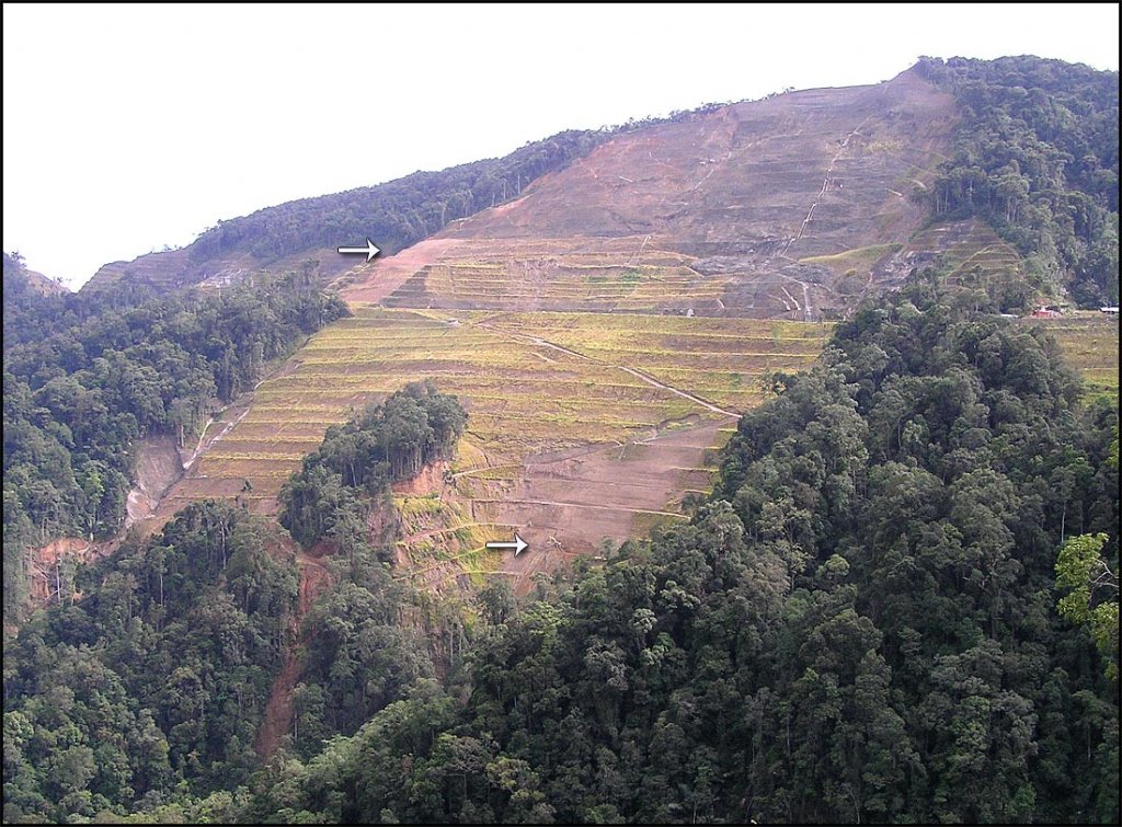

This is the landslide area from west looking east, the lower arrow showing a large tracked digger working on the burms.
The upper arrow showing the most recent landslide photo 2004
7 burms below the upper arrow, is the road. that was the original design.All the earth below the road is from the landslides.
At one time the berms went all the way to the top of the mountain, they have since washed down.
The valley below was destroyed with the silt, and the Ipoh river was silted in, along with it's water supply!
I can remember seeing tractors and trucks totally destroyed in the slides, never heard of a fatality from the slides.
For many years the road was never officialy opened because it was too dangerous
These are toys trying to clear it at one point, then the giant Caterpillers came and really started cutting down the mountain.

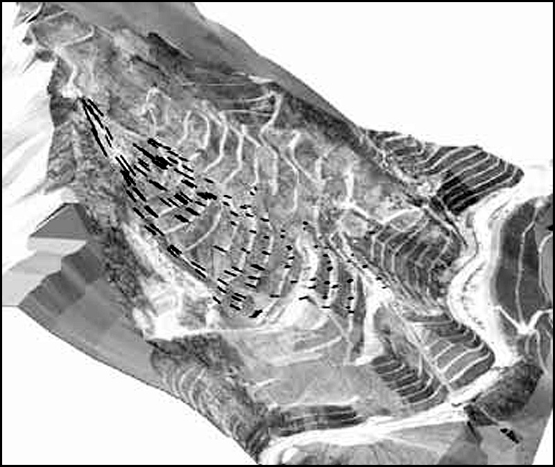

Figure 5. 3D visualisation of the excavated hillside showing the surface displacement vectors (2003–5) to scale. Inset: surface movement of the central toe zone block relative to foliation.

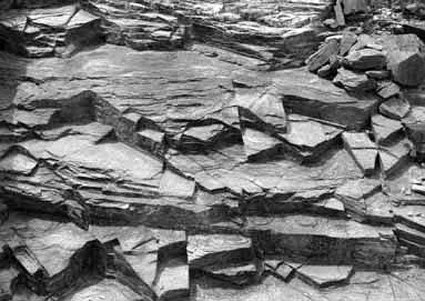

Figure 2. Several joint sets cutting the low-dipping foliation
within the Quartz Mica Schist Unit.

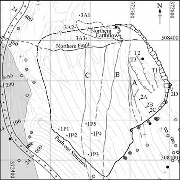

Figure 1. Outline of the landslide superimposed on asimplified geological map of the site; and survey points.
