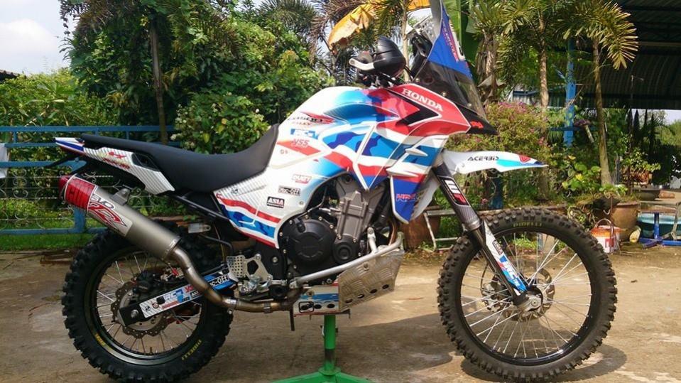

Robin was in Nan yesterday and spotted this, a CB 500 X with an adventure bike conversion
19 inch front wheel and softer suspension and you're basically done!
& it isnt just a dressed up road bike like the Triumph 800 XC, looks like they really can go off road, see for yourself, below ---- this might be very very interesting and a cheap adventure bike created very cheaply.
That is great news, that would be just the right size, not sure about the weight so, but maybe lighter then the Africa Twin. Will be looking forward to see more of this. As my bike are getting older and older, it is maybe time to think about some upgrade.
The bike in the photo has Honda crf 250 r (motocross bike) wheels 21" front / 19" rear and cut down mx front springs. Talking to a few people today, looks like the Honda crf 250 l wheels would work with some fabricated spacers (21/18 ") but the crf 250 l springs will be too soft, mx bike springs are probably the way to go.
I'd be interested in a 500X motard conversion using the 43mm forks and triple clamps of the CRF250M with stiffer springs and keeping the stock 17" street rims and rubber.
Sort of a CB500SM, a 471cc twin cylinder supermoto like the Aprilia SXV4.5 but not as capable and good-looking, but also not as expensive...

I wonder how a 21 front - 18 rear spoke set-up would work. I'd really like to be done with KLRs forever.

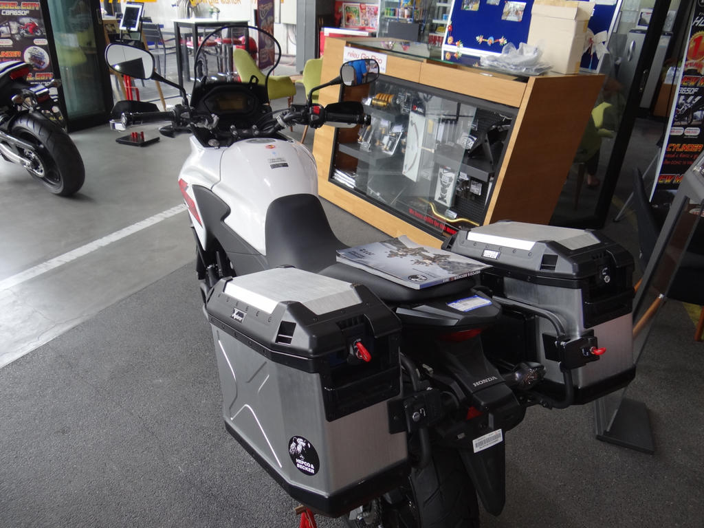

Marcel, Big Wing Chiang Mai has this 500X 'Adventure' on the floor now.
When I checked about the price the salesman (Khun Nook 0851934369; reasonable English) gave me a 'between this and that' price, indicating that they are flexible
with the pricing. You may be pleasantly surprised.

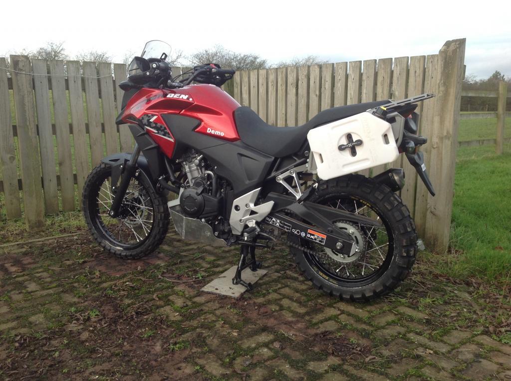

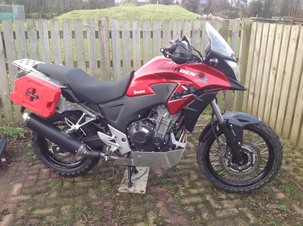

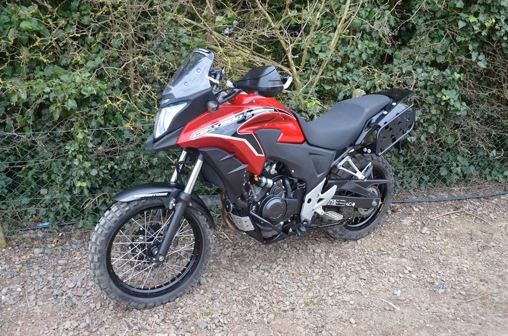

Here's a pic of Rally-Raid products project CB 500X conversion. It's got 19" and 17" excel rims, longer travel suspension, rear rack, skid plate and custom exhaust; I believe they will also manufacture a rally style fairing in a later phase. Testing is about to begin on this bike.
Hope it comes soon and i will cancel the V Strom XT strangling
Would appreciate if you could keep me updated Craig I'll be shopping in CM in April
Sent from my iPhone using Tapatalk
I wonder what they did to get longer travel on those forks - replaced them?
I went for the CRF250M because I didn't need all the power, speed and weight but rather wanted real suspension, like 43mm forks with real travel.
When I realized that the X has only about half an inch more travel than the sporty CBR500R I went for the 250M.

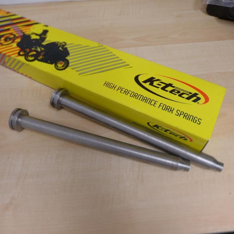

Yes they are being replaced in the 'Adventure Conversion Kit'. Check out post #176 on this page Rally-Raid Products Honda CB500X - Page 12 - ADVrider
"Immediately the suspension action will be improved by replacing these with correspondingly longer springs - that are also of far higher quality... while the +30mm increase in ride hight/travel will be obtained using custom machined internal parts - produced exclusively by RRP (note. prototype parts shown in the photo below)"
Further details on suspension for those interested and not following the thread on ADVRIDER:
"So to answer your initial question: the front forks will have +30mm travel over standard, so near on 7" overall. Similarly at the rear, while our mule is currently only lifted +30mm, it is envisaged that the rear shock will offer more like +50mm when the specification is finalised, effectively equalising the overall travel at each end (the stock shock being 4.7" currently).
This is effectively the same suspension travel offered by the BMW F700GS (which we consider the benchmark in the development of this project)... and coupled with the 17/19" wheel set, we envisage the CB-X will have similar levels of on and off-road performance and handling.
All being well, the production parts for the conversion ought to be available for sale from March this coming year."

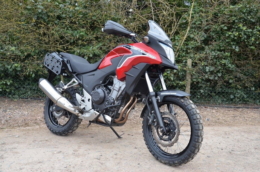

Yep, parts will be available from Rally-Raid Products in the UK. Stock CB 500X here will set you back 215,000฿

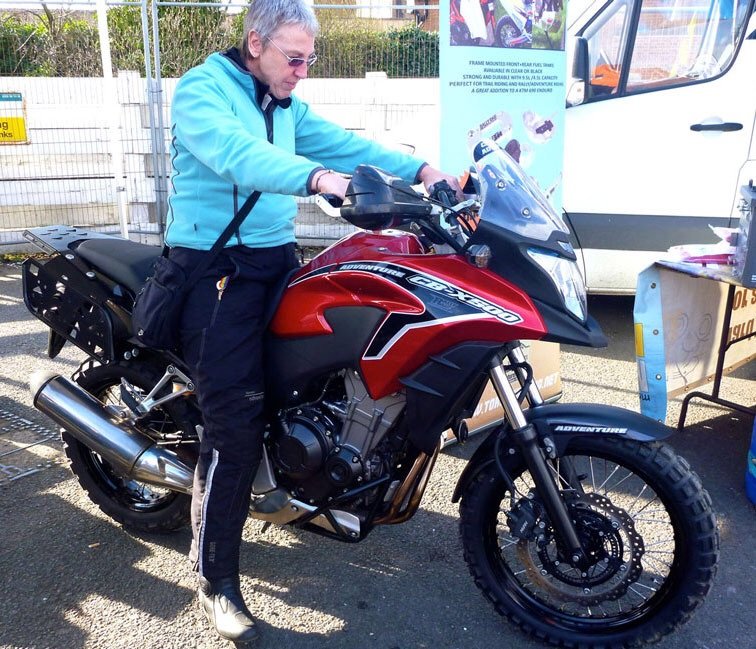

Rally Raid Products are debuting their conversion at the famous Ace Cafe, today.

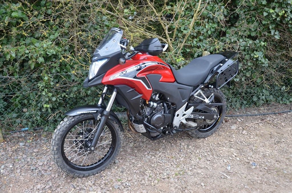

Here's a few pics of the converted test mule, albeit currently with the stock exhaust.
Full details and prices appearing on their website very soon: Rally-Raid Products Ltd

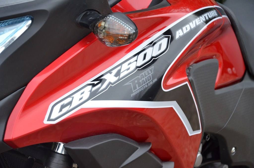

Edit: An additional pic from the event.
