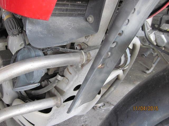

Years ago I bought a pair of Fiamm horns for my dirt bike.
The lasted 6-months, dying after the first rainstorm I encountered.
Then I bought a pair of Fiamm copies and had a similar problem.

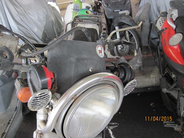

Lesson learned on my next set of Fiamm copies:
I mounted them up-side down and rotated them so the front of the
horn faced downward (see pix), avoiding water from entering and
shorting out the horn's mechanism.
I've now had sets of Fiamm copies on both my dirt and road bike
for over 4-years w/o any problem...so far ;-).

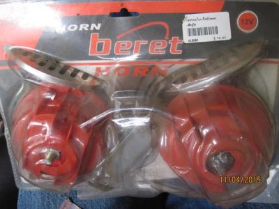

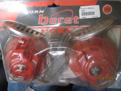

Often I found pairs if Fiamm or copies packaged with both
horns being high tones. High tones sounds don't carry as far as low
tones, but having a pair with both high & low tones is _far_ more
effective than a pair of high tone horns!! Yes, they are LOUD.
Look for a package with one high and one low tone
horn...or see if the seller will allow you to mix from another set.
Fiamm copies come complete with a relay and mounting
straps (the latter are no good and will break from vibrations).
You will need to buy wire and a 20-A fuse.
Retailer have the copies for about 300+Bt, but I've found
weekend Thai market sell them for about 185-Bt.
