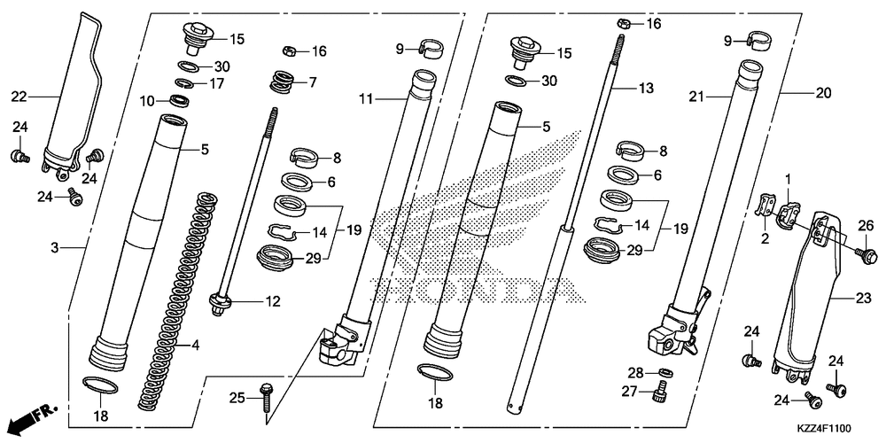

I bought the CRF250L 2017 in Thailand and raised it.
In the back I put a YSS shock absorber (the stock is quite bad, so would have changed it anyway).
For the front fork you need to change two parts (both are OEM parts used on the 2013-2016 model):
12: ROD 51426-KZZ-901
13: DAMPER, FR. 51430-KZZ-901
