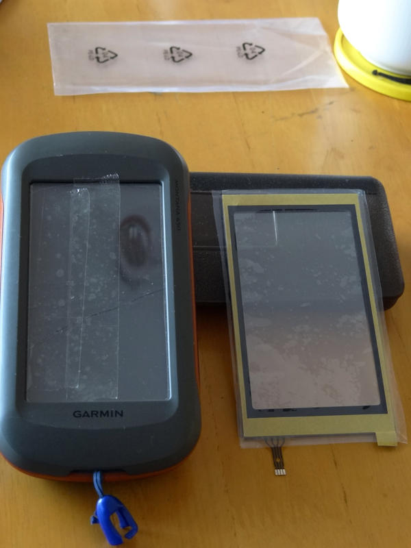

On the most recent ride some-one dropped my little bundle of joy and cracked the screen.
As a result it appears to be mortally wounded. (and explains why there were no GPS co-ordinates in my report!)
It will turn on and off and the date and time will show accurately, however 'map' and all other functions will not open.

The $49 screen from Amazon arrived yesterday so, with Gnasher's help, I hope to avoid the $170 fee Garmin Taiwan want for the repair job plus the $35 freight fee.
Details coming!
The $34 screen from Amazon arrived yesterday so, with Gnasher's help, I hope to avoid the $170 fee Garmin Taiwan want for the repair job plus the $35 freight fee.
Details coming!

Is digitizer the touch screen bit?
montana has a touch screen, 60csx does not

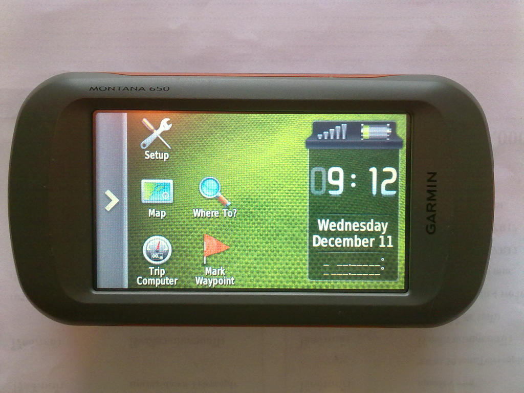

FIXED!
The $49.99 glass replacement screen from Amazon and Tim 'Gnasher's expertise and patience has my Garmin now functioning as it was prior to its accident.

Zumo replacement screen (digitiser)
I have had to replace my Zumo digitiser TWICE now. It gets easier each time, and the detailed instructions are available on the net, including at:
Zumo touch screen and digitizer replacement - ADVrider
Note that the digitiser is a separate part to the actual display, and if the display itself has gone, then the repair part is more costly, but follows the same principle.
The digitiser was available on eBay for UK£7 but it ships from Hong Kong, so for the cost, buy two, & keep one as a spare. There are two sizes sold - make sure you get the 79x64mm for the Zumo, as the smaller does not fit as well.
Yes, the replacement can be tricky if you have poor eyes and/or big hands, but patience and reading the instructions over & over again shud pay off.
Finally, don't forget to source the Torx screwdriver tool either before the digitiser arrives, which can be bought cheaply in the local markets. Some sellers even include one with the repair kit.
